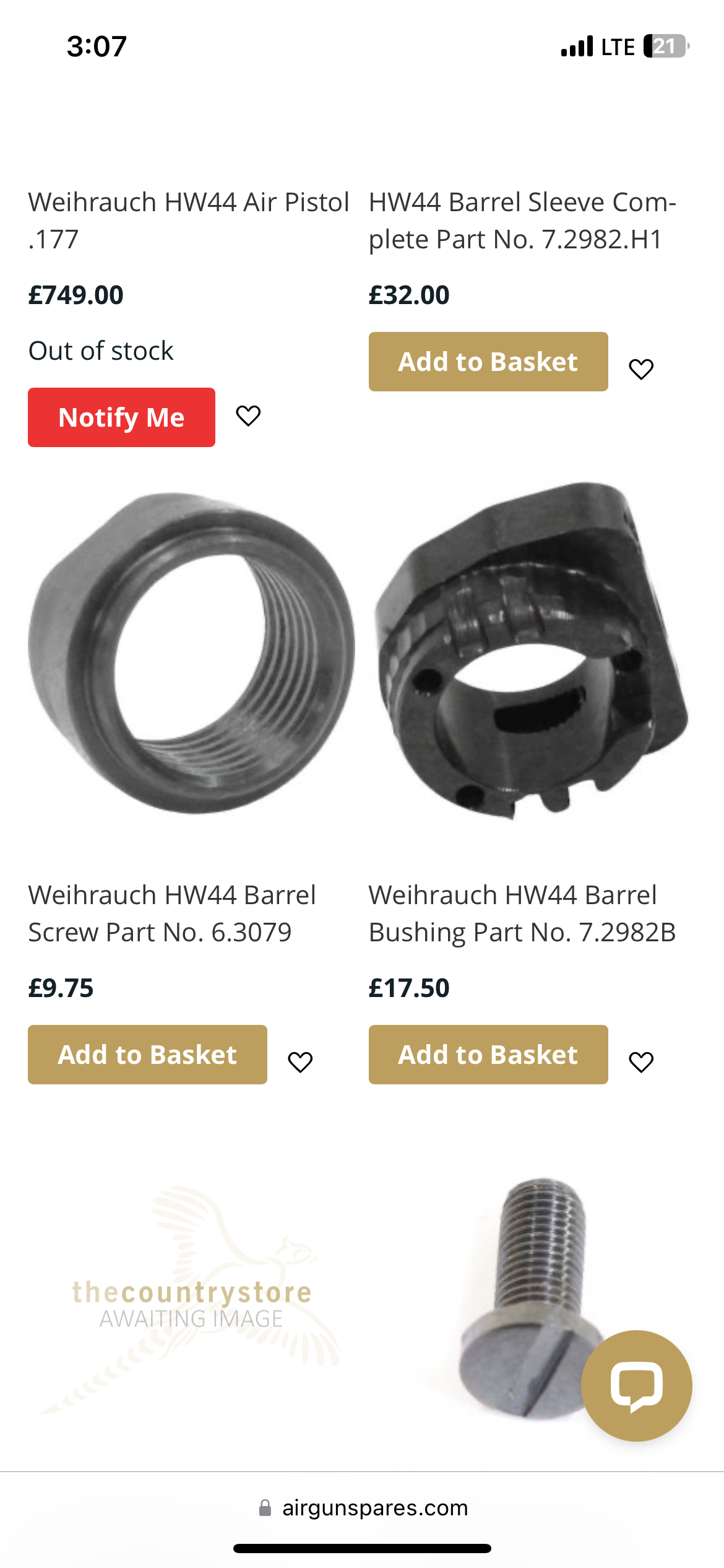

Perhaps these parts on airgunspares are used to allow the pistol to use the thinner od barrel:
In any case, if you scan airgunspares, you will see that the HW110 and HW44 use many of the same parts.

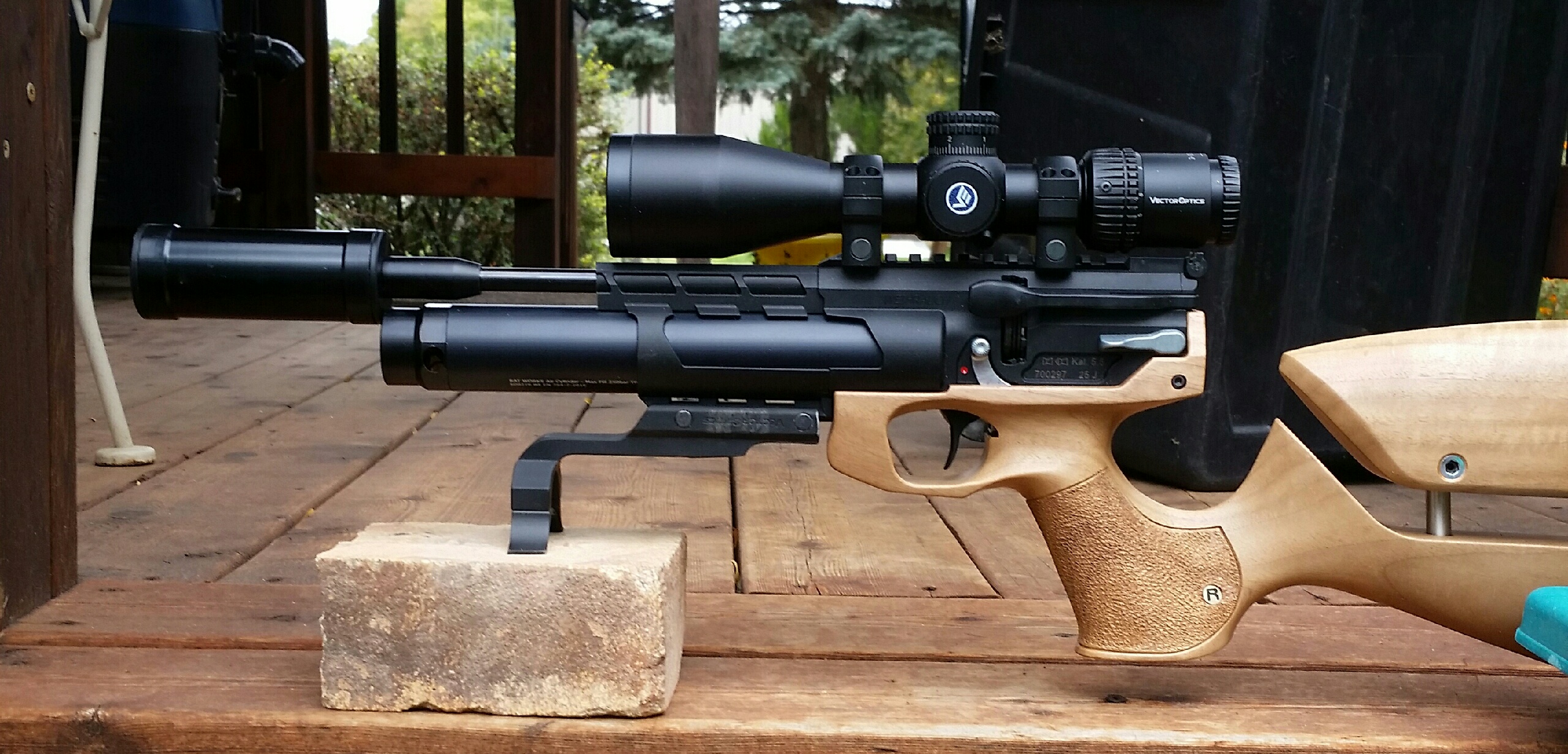

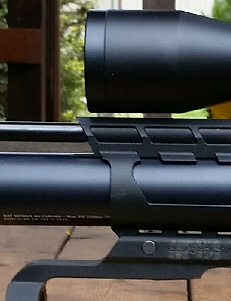

Nimrod,, my gun still has the factory barrel, i just used a different airtube and moderator and an adaptor for the moderator
rinks formgrip stock and as you see I already chopped the plastic cover for the barrel,,, I have a new cover for the barrel sitting in my spares, just in case I go back to original pistol
What you did looks really cool.

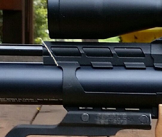

I think (in my humble opinion) will look even better, if you cut the plastic, following the lines...as below.
Anyhow...I've yet to see someone who put the HW110 on it!
Like this...perhaps!
Reactions: jarmstrong
I agree with the slanted cut that you drew out,,, I also considered that, but have not taken it apart since, to complete it

If I get the 110 barrel to fit the receiver, I will have to come up with a new solution , to keep the lower picatinny bipod attachment
I will lose 1/2 the gap between the barrel and airtube, as I have a little over 5mm/5.5mm gap,, with a 5.7 difference in barrel dia, so 1/2 of that for radius that will fill the gap
all of the top of the cover will go bye bye,,, if in, I get it done
the cover also covers the void between the barrel and receiver, for better appearance

Yeh, I know exactly what you mean.
I was thinking ...if the HW110 barrel fit, then I'll get a 3D cover made to mimic the current one, with the Picatiny rail as well.
Plenty of guys would take this challenge.
Or...simply a 3D printed figure 8 (to link the barrel to the tube and have a picatiny on the bottom
