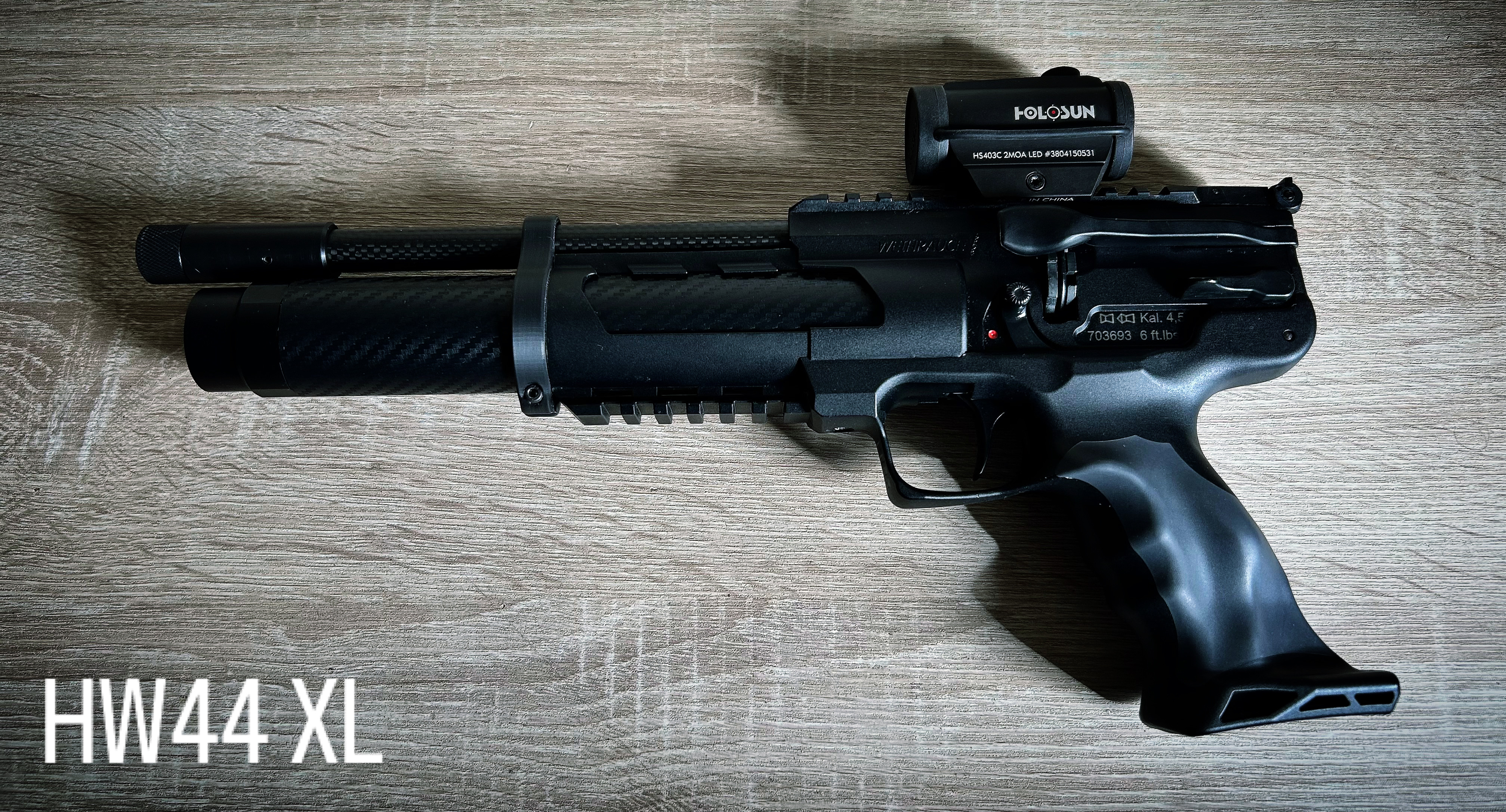

I'll show some HW44 love! I purchased this near new gun recently from an AGN member. I reduced power and get 30 shots on a fill, shooting JSB 10.3s at 695fps. It parks pellets on top of each other if YOU'RE steady enough. Standard 10 shot group below at 25 yards from bucket and trigger sticks.
