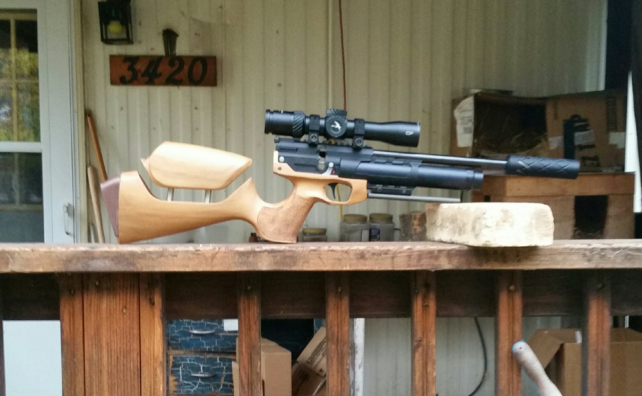

HW/Weihrauch HW44 with 310mm HW110 barrel
Hw44, with rinks carbine stock, ratworks airtube and a 310mm barrel for a HW110, Optisan cp 3-12x32 and a ODb 110 moderator for now
16 gr AA @735fps 30 shots per fill @200 bar
been a really good month for me, got my summer project done so my attention went to replacing the barrel, went easier than I thought
2" longer and twice as thick, barrel flip is gone, I do not remember the velocity of the pistol barrel,,, darn
I am quite excited with my little HW44 carbinized, it is 3 lbs lighter than my Kozak compact [my daily shooter] and right at the same lenght
kozak gets 70 shot vs HW44 30 shots
kozak is easy to feel when mag is empty, HW44 has cock on closed so ya don't have the feel but can see pellets in the left side of mag except for the last one, need to keep count or change out mags with maybe 1 left in it

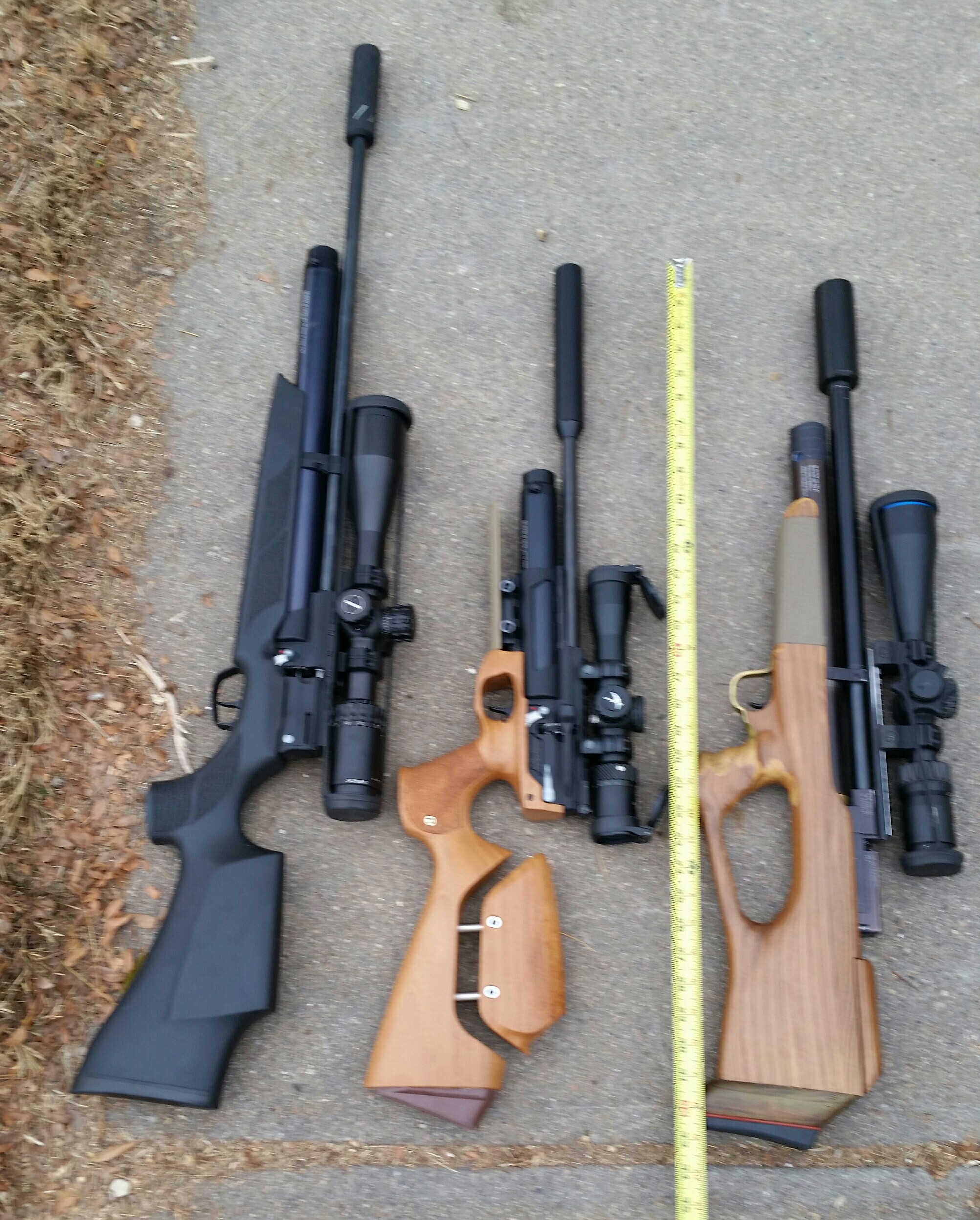

I exchanged moderators from HW110 and HW44 in this photo
perfect yard and garden gun and super quiet with the HW moderator,,, 33 inches short with Weihrauch full size moderator
I am working on modifing the HW pistol mod with a new endcap that will be 1" shorter
That's pretty cool. Could the same thing be done with the 110 if someone wanted to make theirs smaller?
the 310mm barrel is for the K model which has a shorter forearm stock,
where the normal barrel is 410 mm
the FAC is long 600mm barrel that is in my photo,,, black HW110 FAC on the left
