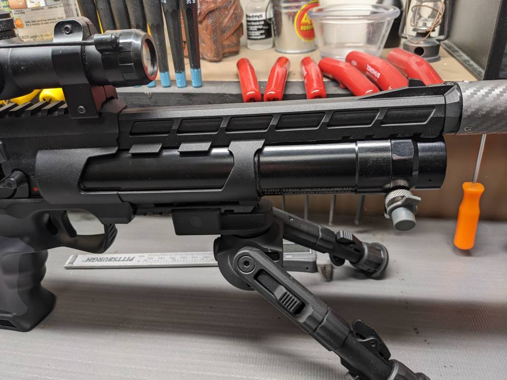

HW44 with a HW100 carbine air cylinder. It works!!!!!!!
It works like a champ. I had to remove a small amount of the plastic shroud near the end of the barrel for the added length of the HW100 cylinder and grind down the bottom side of the moderator adapter slightly to clear the gauge. Shot count went from mid 20's to 40 shots (.177). I also added a homemade moderator. It's obviously not as quite as the Weihrauch but actually still pretty quite to my ears and 3.25" shorter.

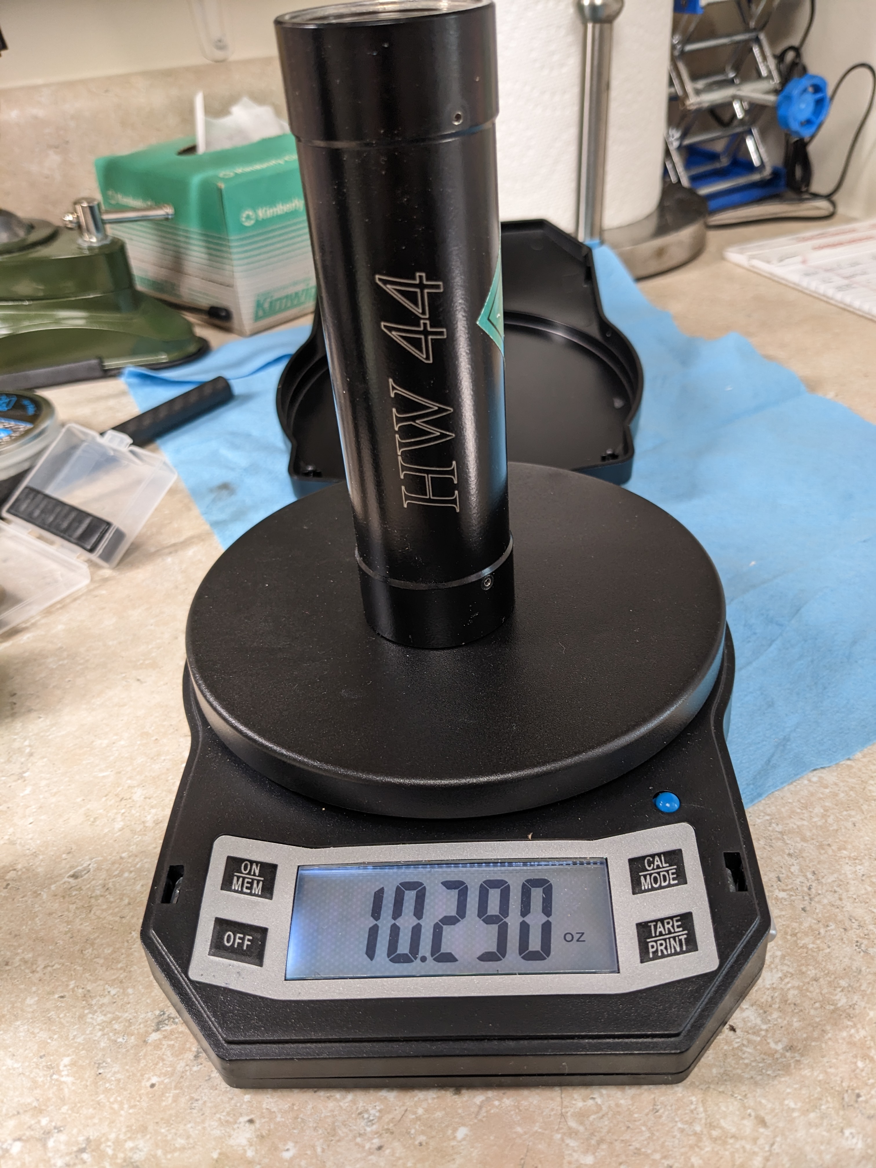

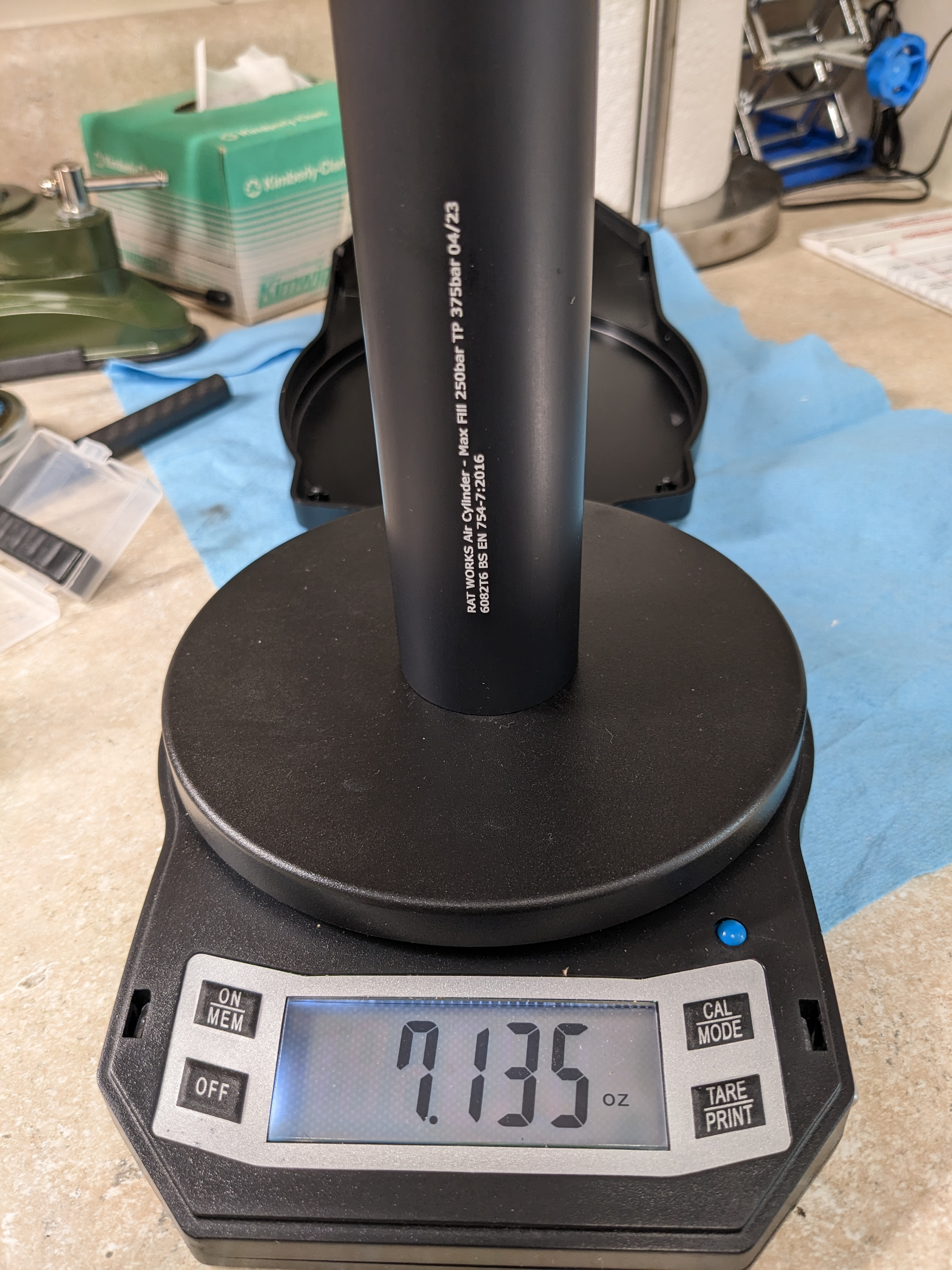

The original hw44 tube without the ends weighs 10.34 oz by my scale. The orginial hw100 carbine tube I installed weighs 16.16 oz. I can't find the exact weight of the aluminum carbine tube but the Ratworks website says it reduces the weight by 50%, which would make an aluminum carbine tube around 8 oz, still 2 oz lighter than the original hw44 steel tube with an approx 40% increase in capacity.

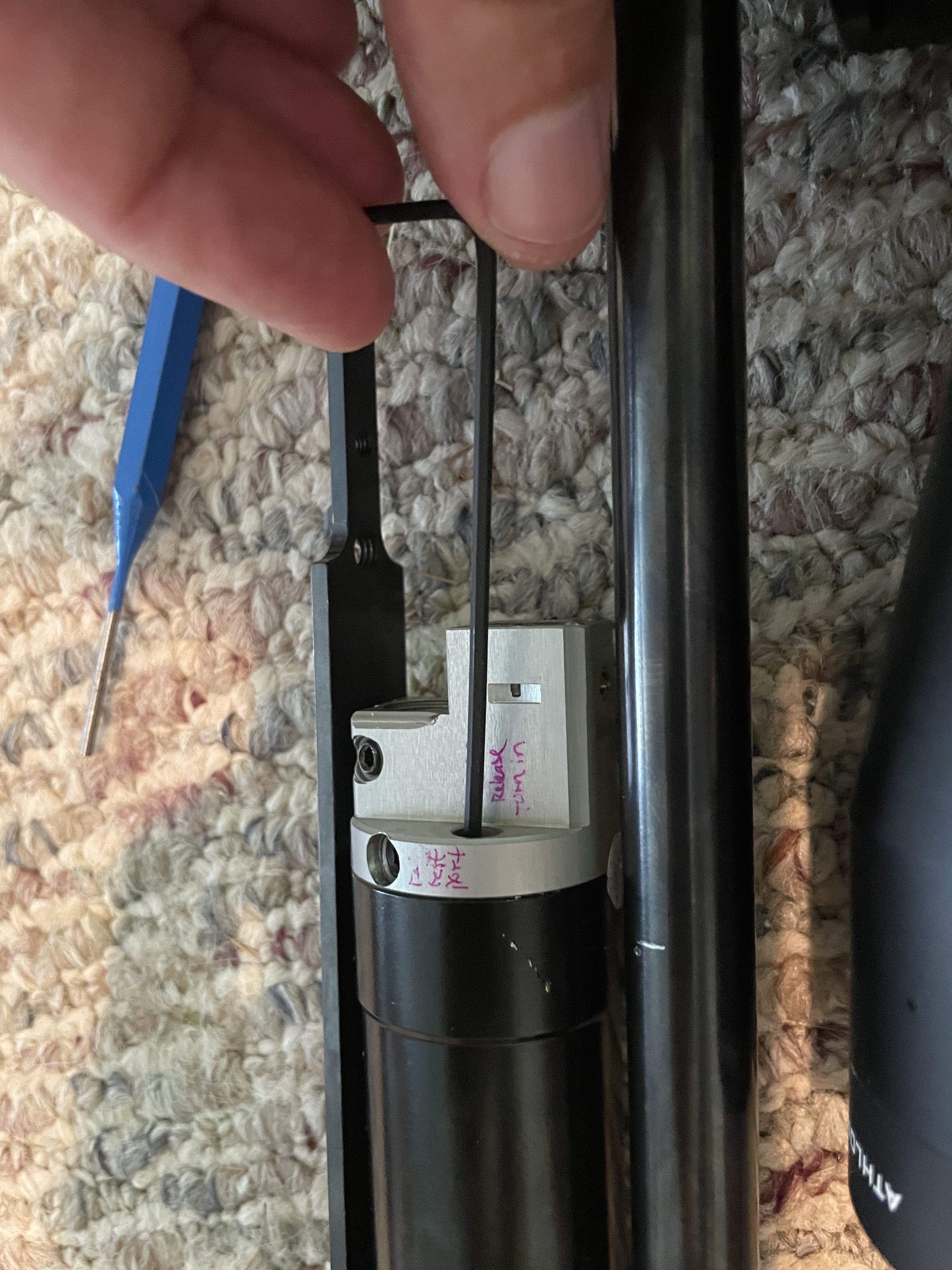

Take out the trigger assembly. It's one piece that just lifts out. I handled this very carefully. I don't know if it comes apart, but I didn't want to take any chances. That gives you access to the socket head set screw that holds the air cylinder. It a tight fit and takes a really short hex key (4mm if I remember correctly) to get to it. I already had one I had cut down I use for hammer spring adjustment on my HW100.
Cylinder slides right out.

Put the ends on the longer cyl and reattach it to the gun to see how much of the shroud needs to be removed. I used a dremel with a cutting wheel (don't cut to much) and finished with a sanding block. Once finished, take the gauge back off, but leave the cyl screwed in. You can't get to the set screws that hold the adapter onto the barrel with the gauge on and you don't have room to screw the entire cyl back in.
Almost forgot, on reassembly you'll need to sand/grind a flat spot on the bottom side of the moderator/barrel adapter to clear the air gauge fitting.

theratworks.co.uk has the aluminum. That's what I have on all my Weihrauchs, quite a bit cheaper than the titanium.
