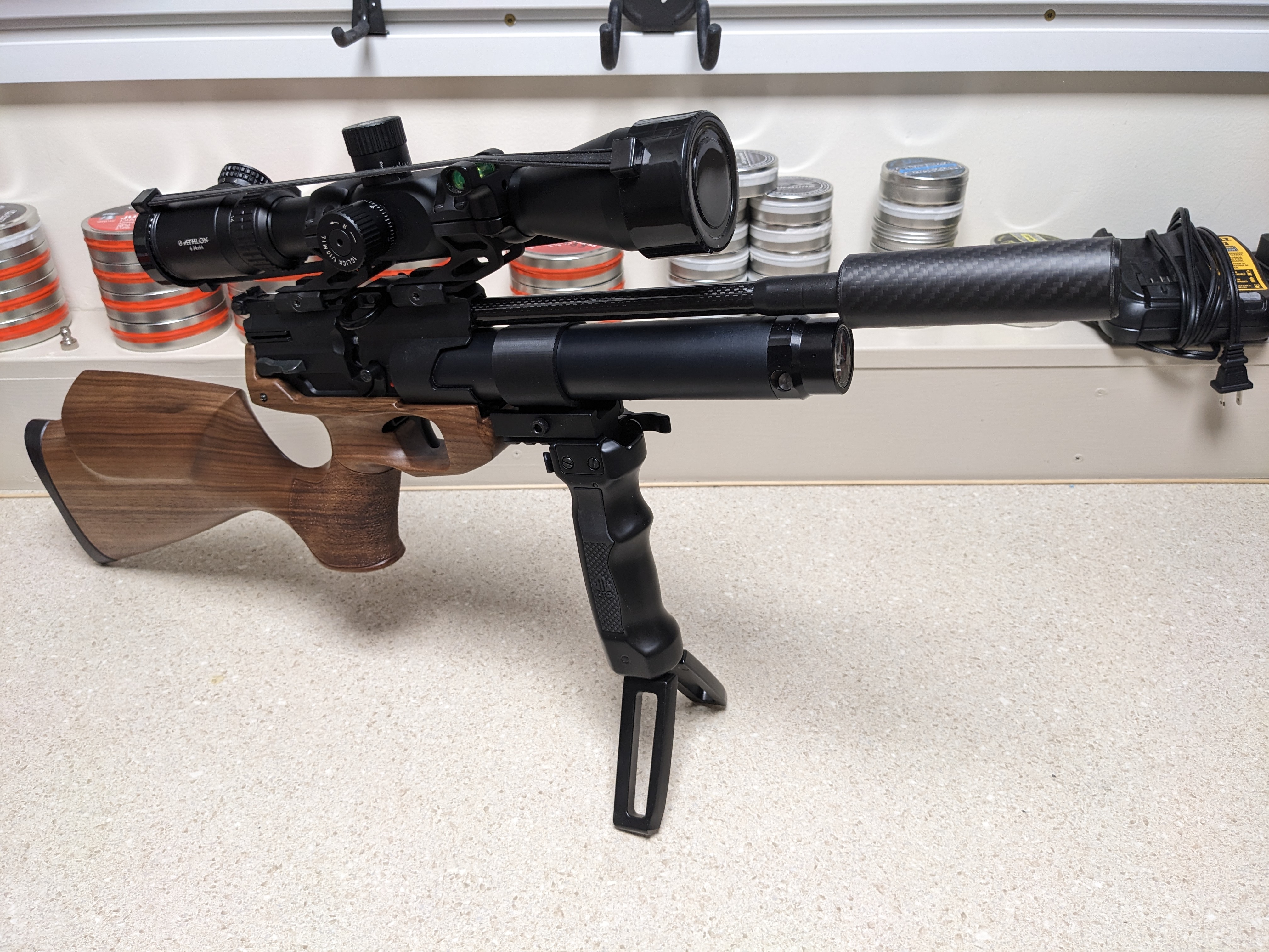

HW44 with a HW100 carbine air cylinder. It works!!!!!!!

OK, if we're going to resort to name calling like "Wicked Enablers", I going to be forced to post more pictures.:devilish:

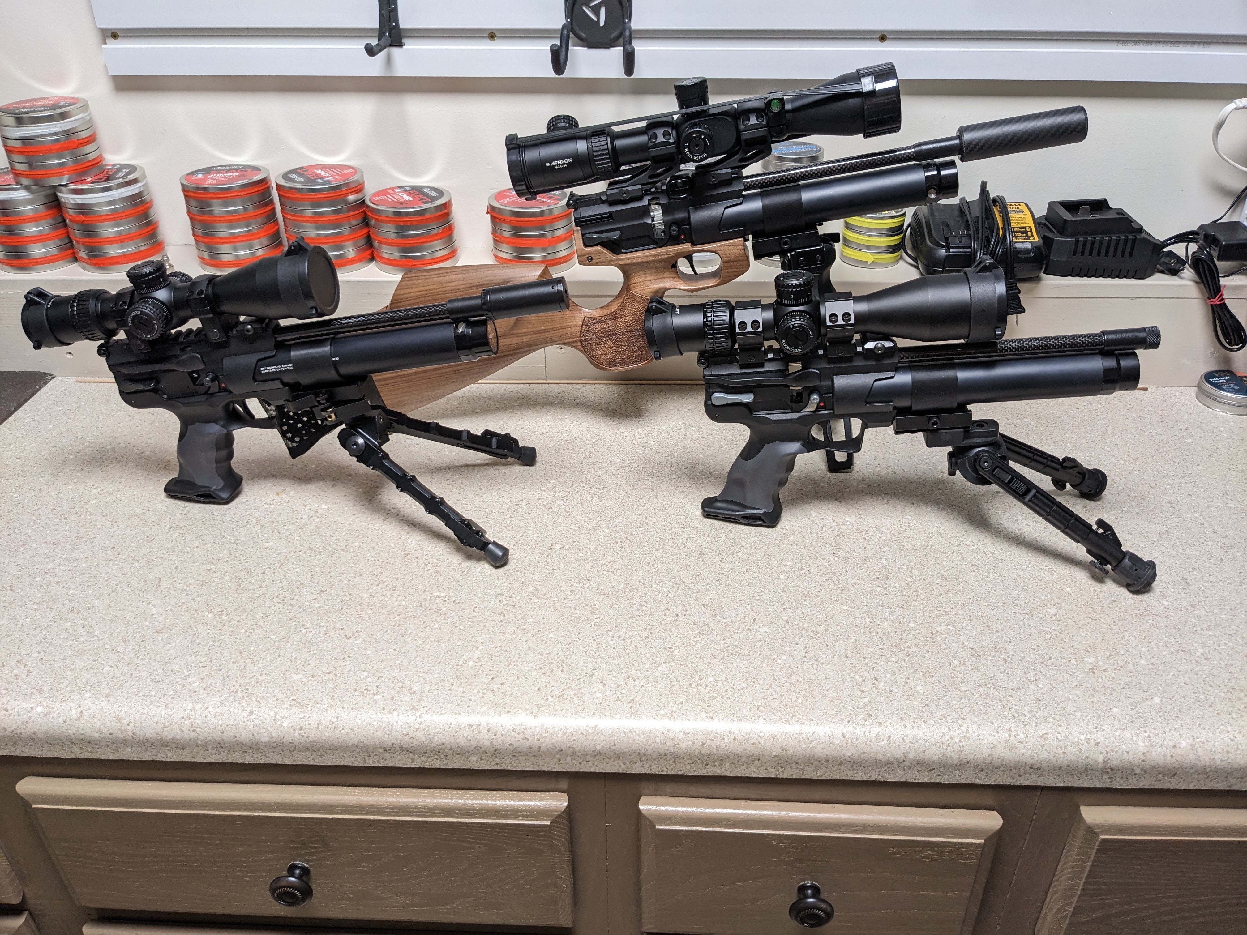

This is my trio of HW44's (latest version).
The carbine is a .22. I've not made any power adjustments. It gets 50 shots shooting JSB 16's an average of 657 fps (15 fpe)
The pistol with the small moderator is a .177 and also has had no power adjustment. It also gets 60 shot shooting JSB 10.3's an average of 756 fps (13 fpe)
The one with no moderator is a .177 with the regulator set at about 60 bar and the hammer spring set to the lowest setting. Can't say for a certainty yet, but I'm fairly sure I'll get 120 shots per fill. Shoots JSB 8.4's in the 640's fps (8.4 fpe). The best part is it's quiet enough for me without a moderator.

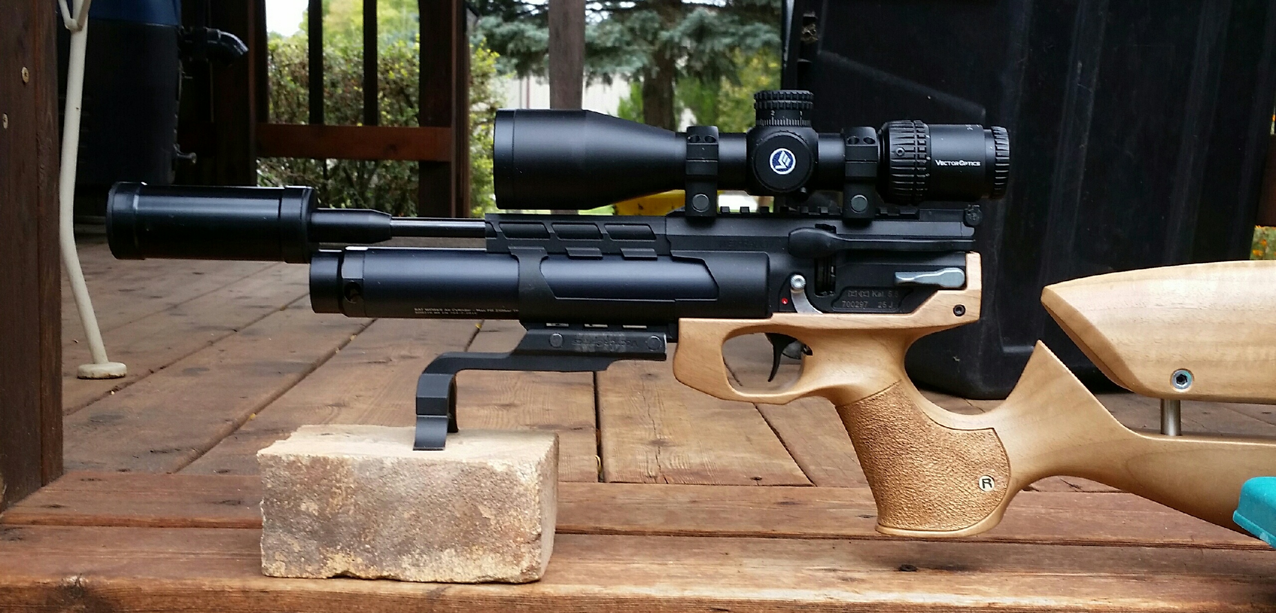

That carbine stock nice! How is fit and finish? I have 1 on order for a FWB65 and haven' heard a word. Hope they come through.
Reactions: Bandito

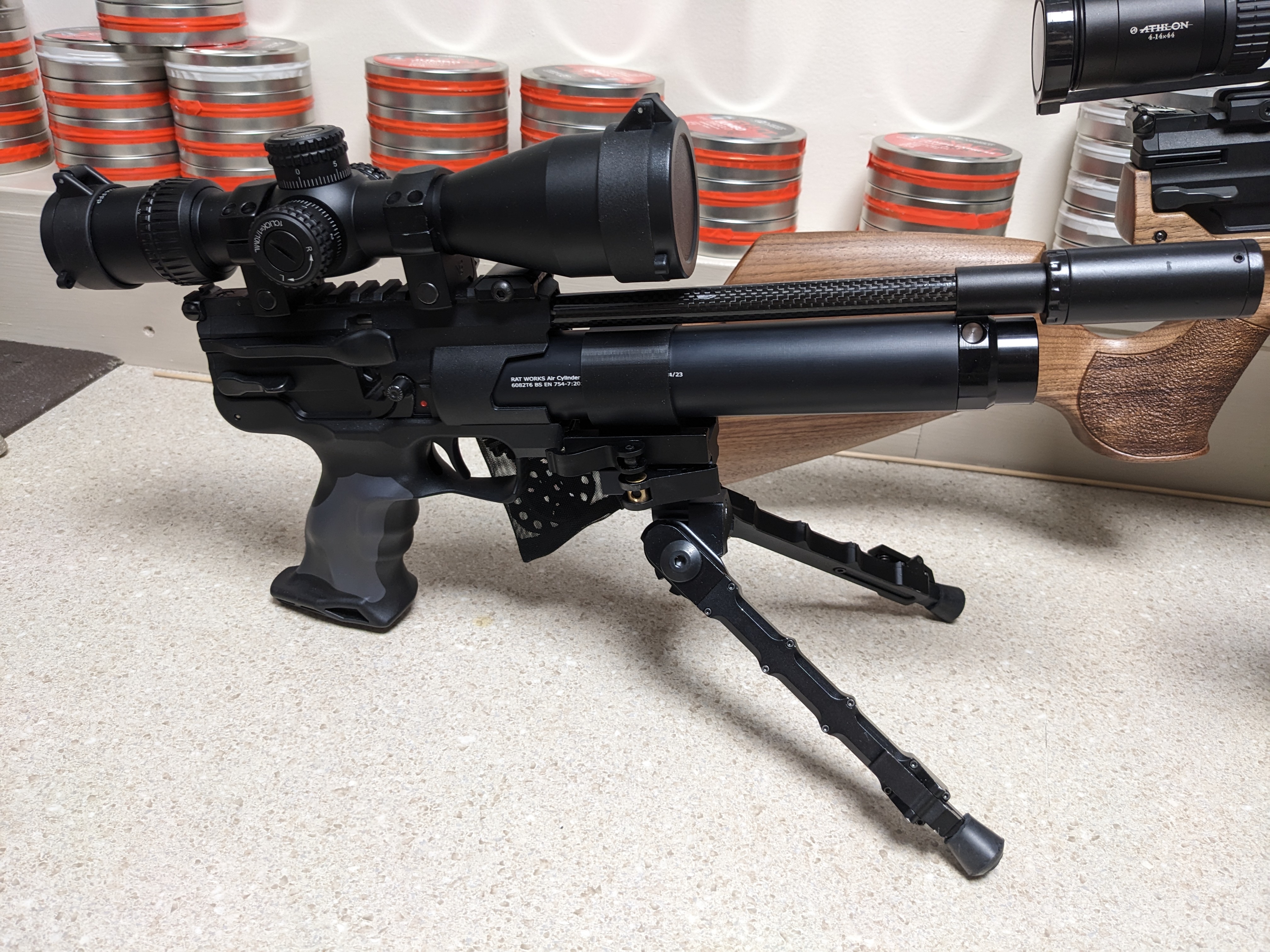

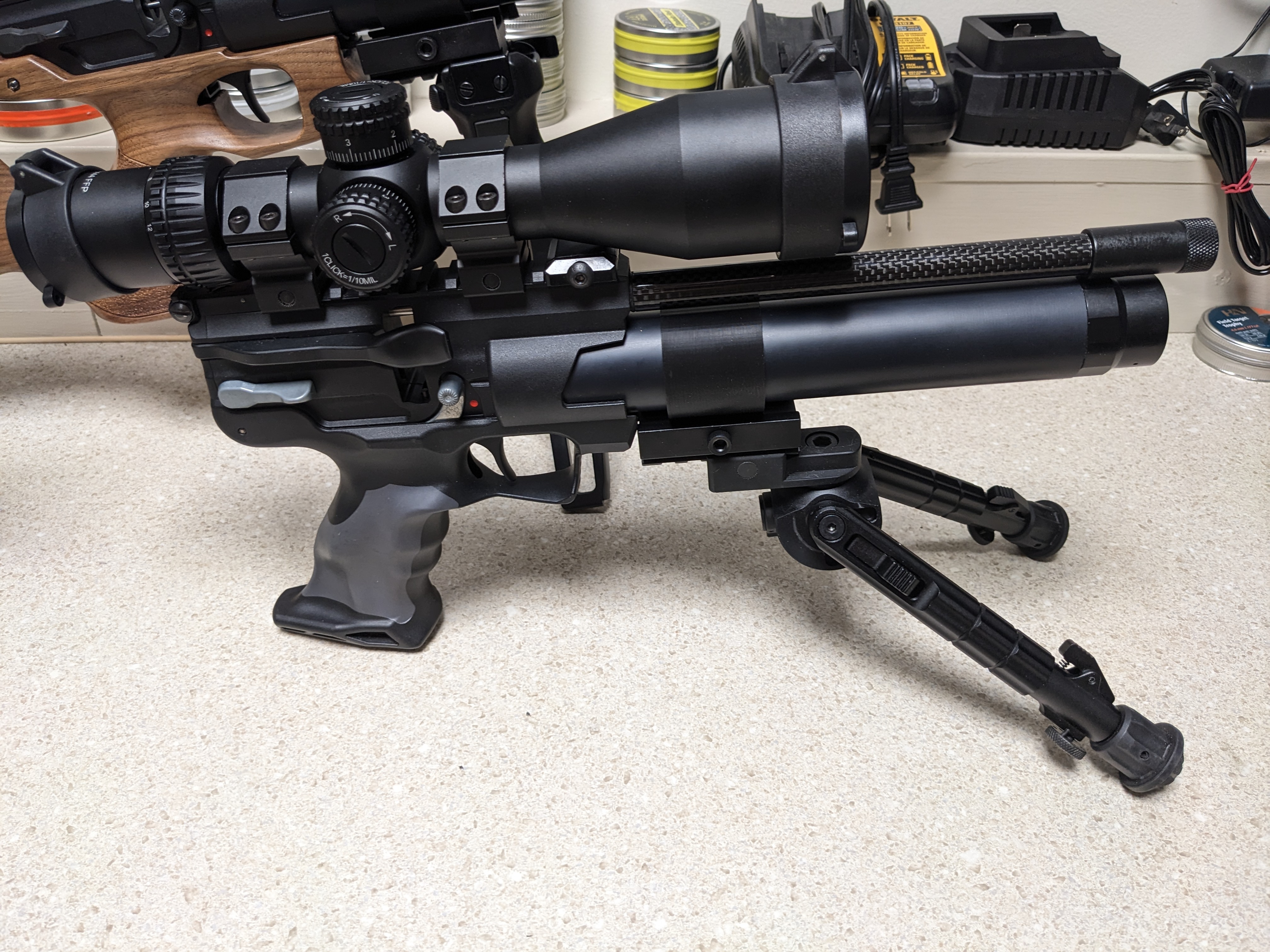

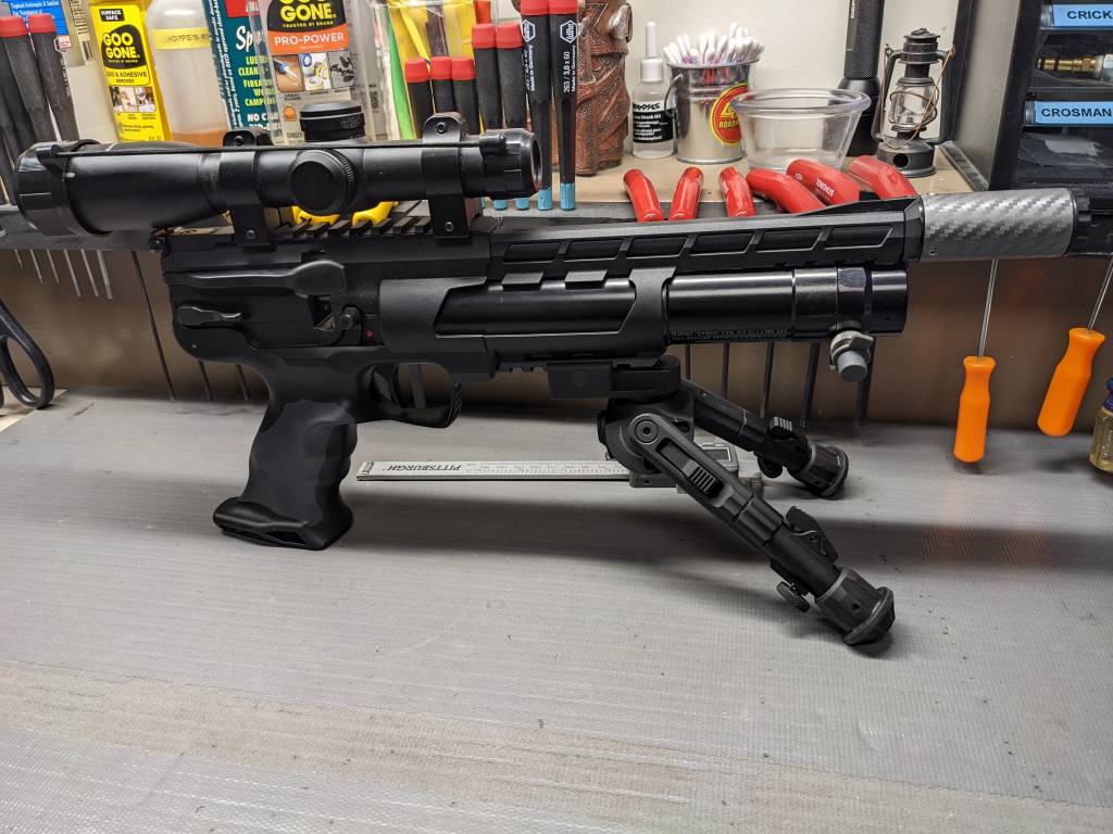

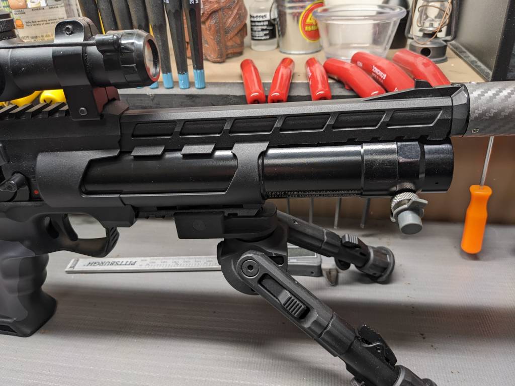

It works like a champ. I had to remove a small amount of the plastic shroud near the end of the barrel for the added length of the HW100 cylinder and grind down the bottom side of the moderator adapter slightly to clear the gauge. Shot count went from mid 20's to 40 shots (.177). I also added a homemade moderator. It's obviously not as quite as the Weihrauch but actually still pretty quite to my ears and 3.25" shorter.
I purchased a HW100 bullpup a while back and added a longer Ratworks aluminun cylinder so I already had the cylinder, so I had no expense for this mod. I couldn't be happier with the outcome.

I purchased the .22 HW44 with the carbine stock and a pistol grip off the classifieds a few months ago. Fit and finish on both is great, although I think I like the feel of the oem pistol grip slightly better.

I love the carbine stock. Just doesn't extend forward for hand placement, but a monopod solves that issue. My picture shows a UTG but I use a little cheap plastic folding monopod most of the time. If I need a bipod I just swap it over.

Yeah, I like this version much better than my first with the original plastic shroud cut down.
The barrel is 10 mm. I put a 10 mm id X 12 mm od carbon fiber tube over mine, then went with a 12X14 mm over that to dress it up a bit. Completely unnecessary, shot fine without anything. I guess the barrel should be nice and rigid :ROFLMAO: . The picatinny rail I ordered from JB3DPD. I sent him a message and he made it for me and added it to his website. Two things I'm not crazy about with it. Only one slot and clamping the rail with a bipod/monopod is what keeps the clamp tight making it a bit annoying if you want to swap between a bipod and monopod (or use nothing at all). I solved this by add a riser that I leave on all the time, then I can swap between the two.
https://jb3dpd.com/products/rat-works-picatinny-cylinder-mount
I ordered the 10 mm barrel to 1/2-20 adapter from DonnyFL. Actually I've ordered three. One fit perfectly, one was a slightly tight fit and needed to be sanded a bit, one was really tight. I had to drill it out slightly to fit the barrel.
