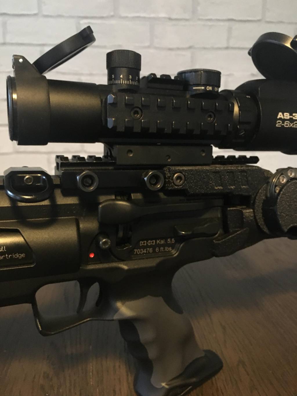

After seeing your pictures I decided to stick my AS34 back on my Leshiy and had trouble getting the built in mount to not cant to one size on the picatinny rail. Do you have this same problem?

Scouty, I do not have that problem with my AS34 not centering on the rail. I am not sure why yours would cant to one side? I also do not have any blurriness with mine?

I'm surprised you don't have blurriness. I mainly get it when shooting paper indoors within 20 yards. When I scan the backyard at close range it is not as obvious.
I'm hoping it can be at least be a useable scope for my Leshiy while I shop for something better. It sits at the right height and has a good amount of eye relief.
It also has the best eye box of any under $200 scope I've looked through. The zoom ring or whatever you call it is also really smooth.
I hope you get things sorted with your AS34. I have not noticed any blurriness but I have never shot indoors either. Agree with the eye box and zoom ring. I think it is a good fit for my application and only paid $125.00 on Amazon. I was watching a review on Andy's Airgun reviews, he gave it a good review so I made the purchase. I looked for his review to post, but could not find it.

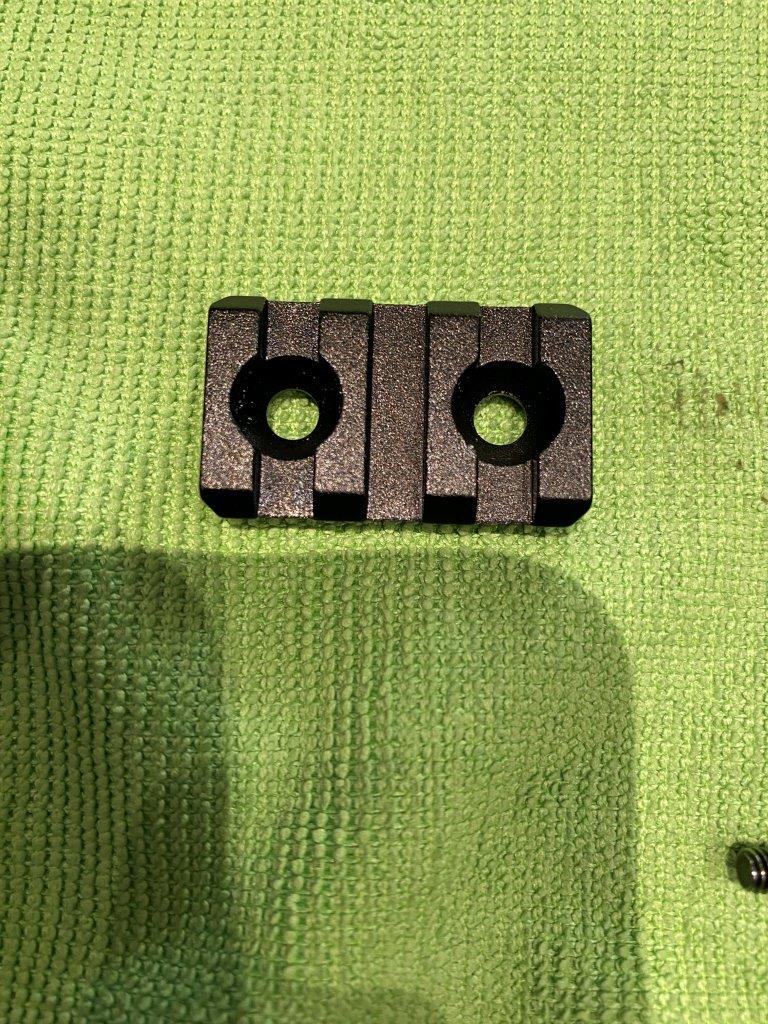

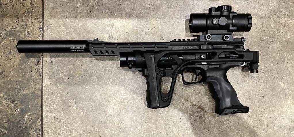

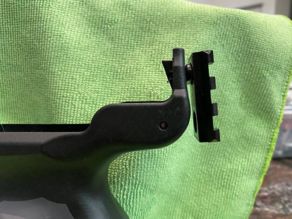

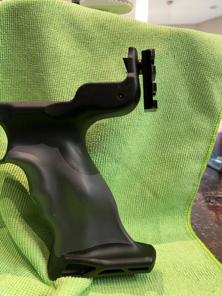

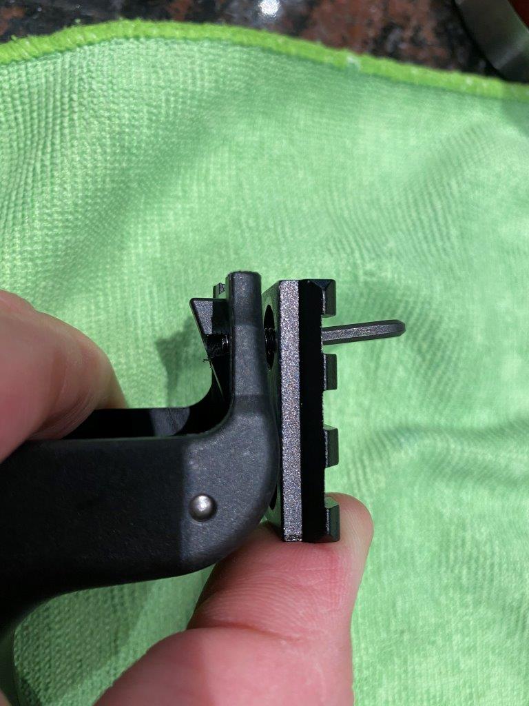

Ok - So I got a wild hair and started prototyping my own system. Basically I am using the Sig MPX pistol as my example. IF you are unfamiliar the rear of the gun has a five Slot picatinny rail machined into the rear. This allows the user to customize his arm brace with between folders, collapsible etc. so I took this premise and started prototyping my HW44:
1. Purchased a three slot Picatinny from amazon: $10.00 (filed back of rail flush as it was an M-Lok)

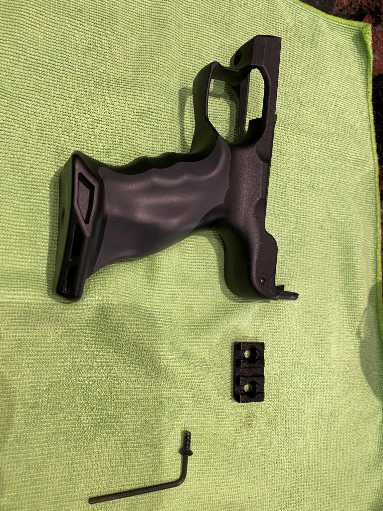

2. removed pistol grip from hw44
3. center rail so it is below cocking handle

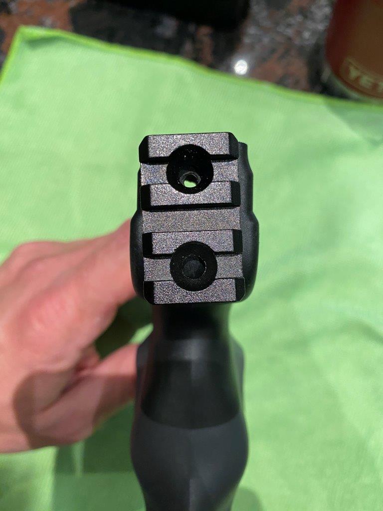

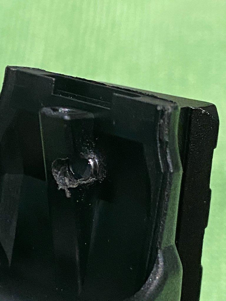

4. Drilled and tapped first hole:
5. Attached rail
Again this is my first go, not perfect but at least a start to spark ideas. need to make it level (use washers to start) need to tap a second hole for more rigidity. But basically gives you multiple options with a quick removal and compact size. I will add photos of Stock attached once I get it from my office.

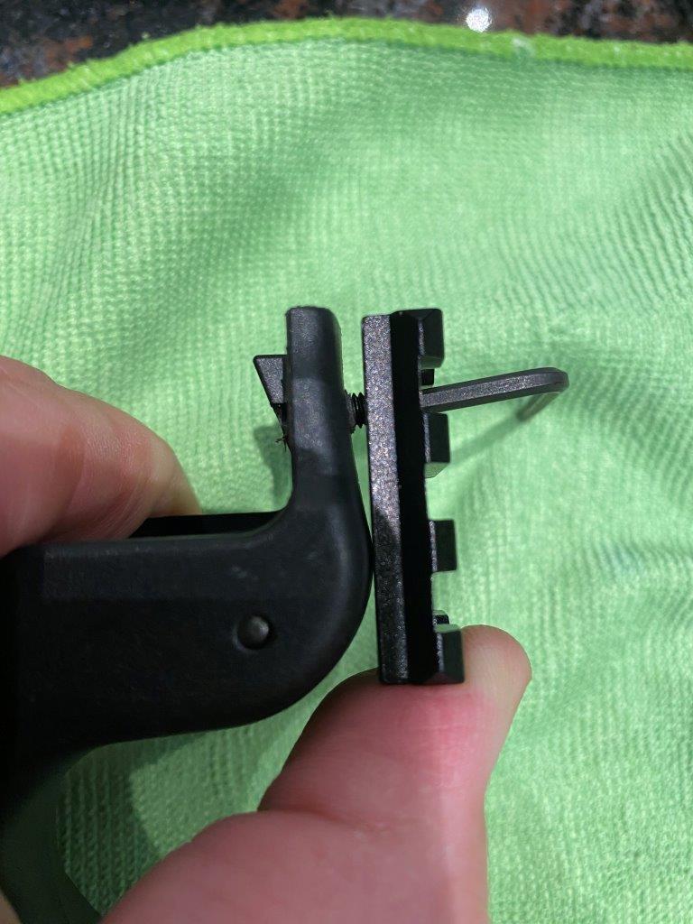

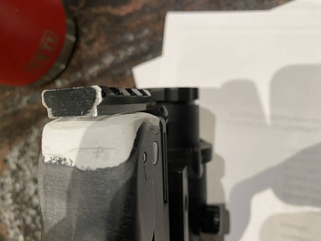

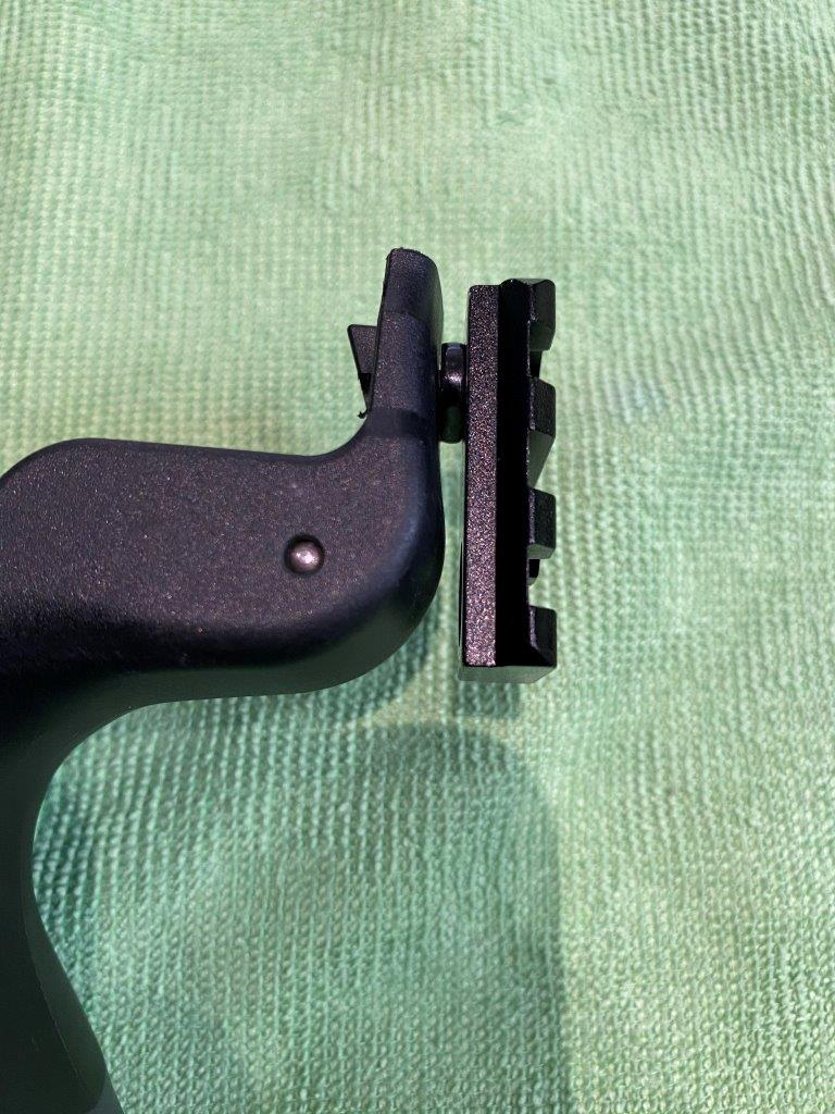

So prototype is done. Need to figure out a way or built up the rear end on the back of the HW44 so the Rail sits flat /flush (No angle). Even with a couple of washers I cannot get it all the way flat. I am not sure if you could build a mold around the back and fill with epoxy and make a flat surface. Any ideas welcome. Regardless it was a first attempt.

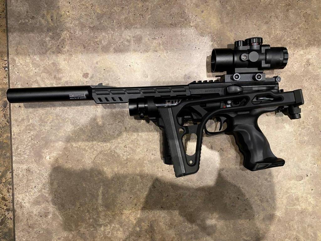

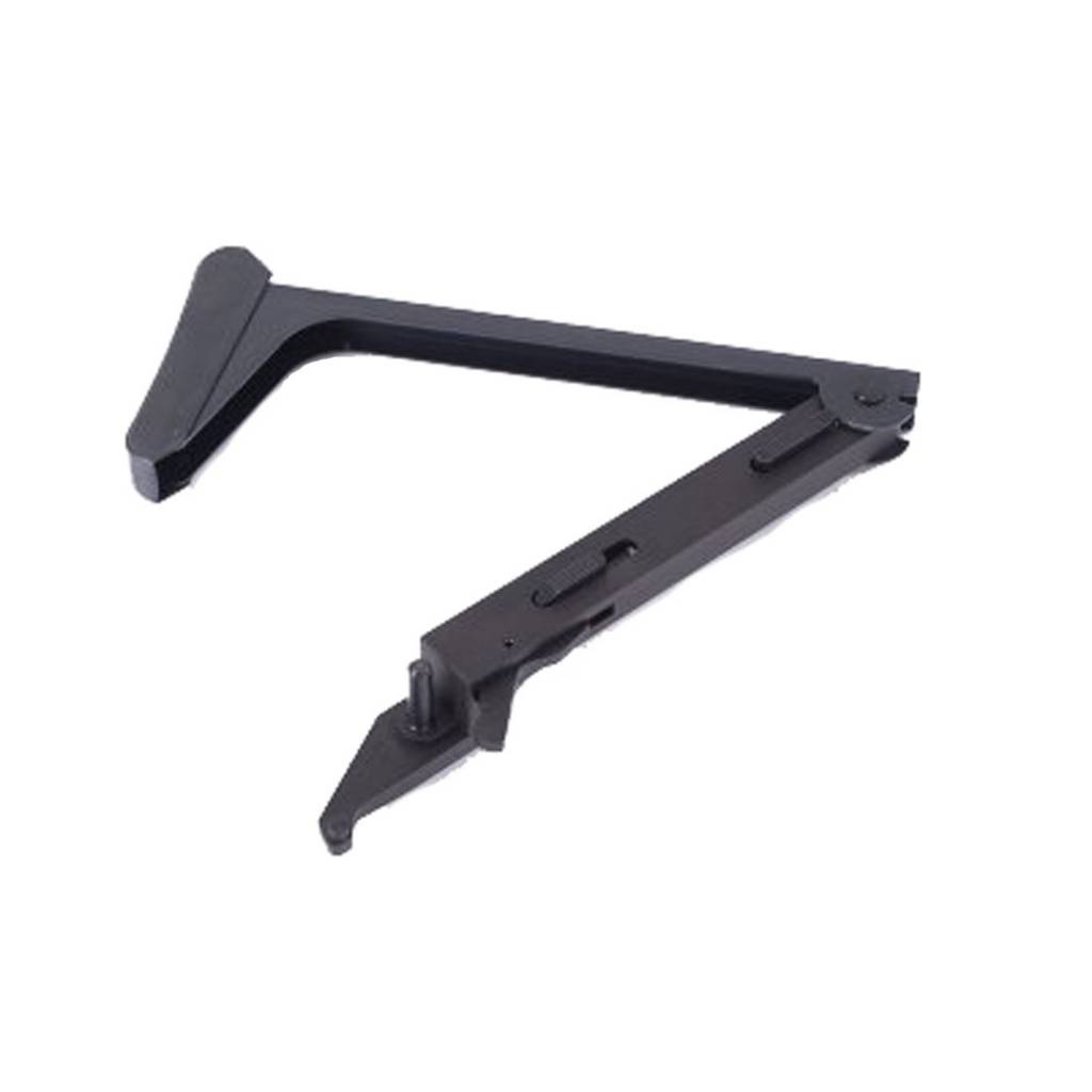

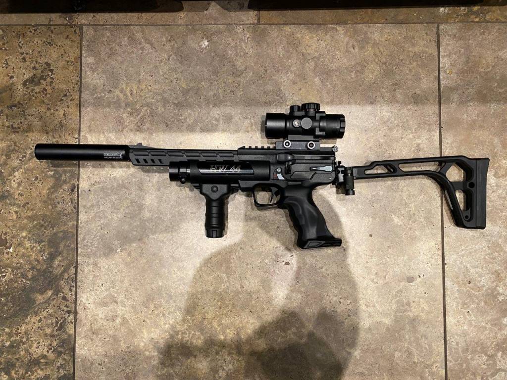

I attached a SIG MPX side folder stock to the gun and it fits well and folds nicely.
Enjoy.
David Basha

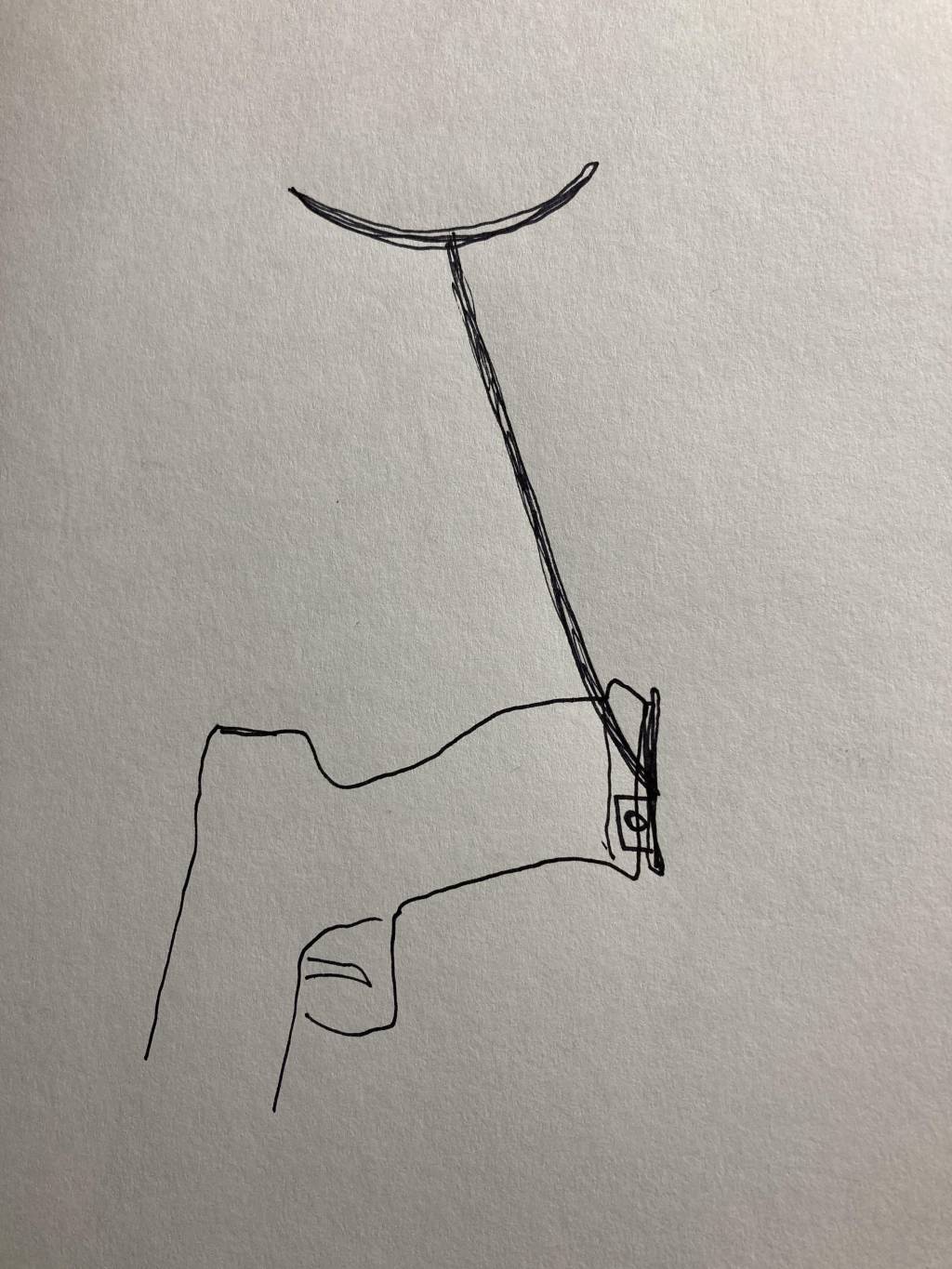

Nice job on the stock, as far as building up the back of the pistol perhaps someone can 3-D print you a tight fitting piece that could be attached. Your project convinced me to try to make a stock as well. I’ll post pictures as soon as I get it done. I’m going to try for a skeleton wire stock that comes off the bottom of the pistol grip

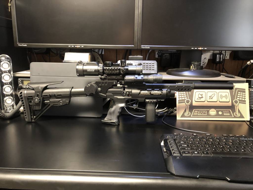

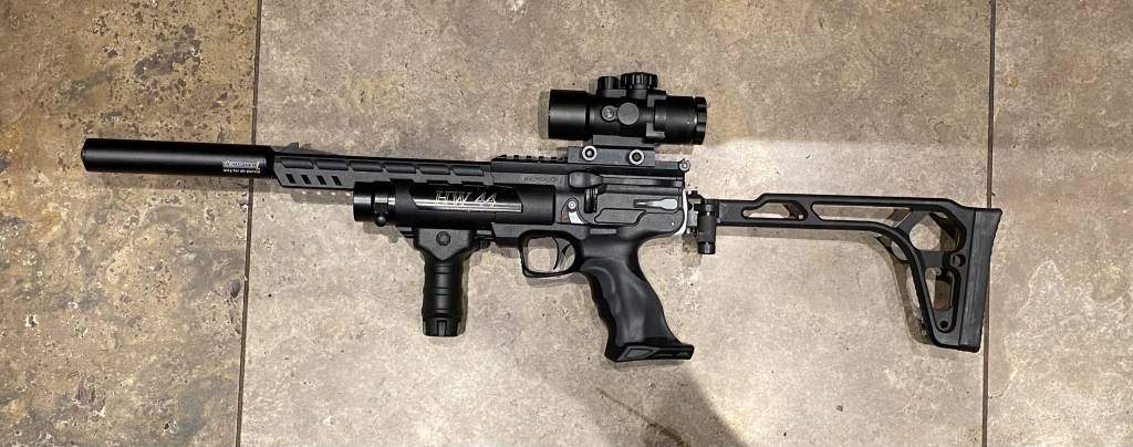

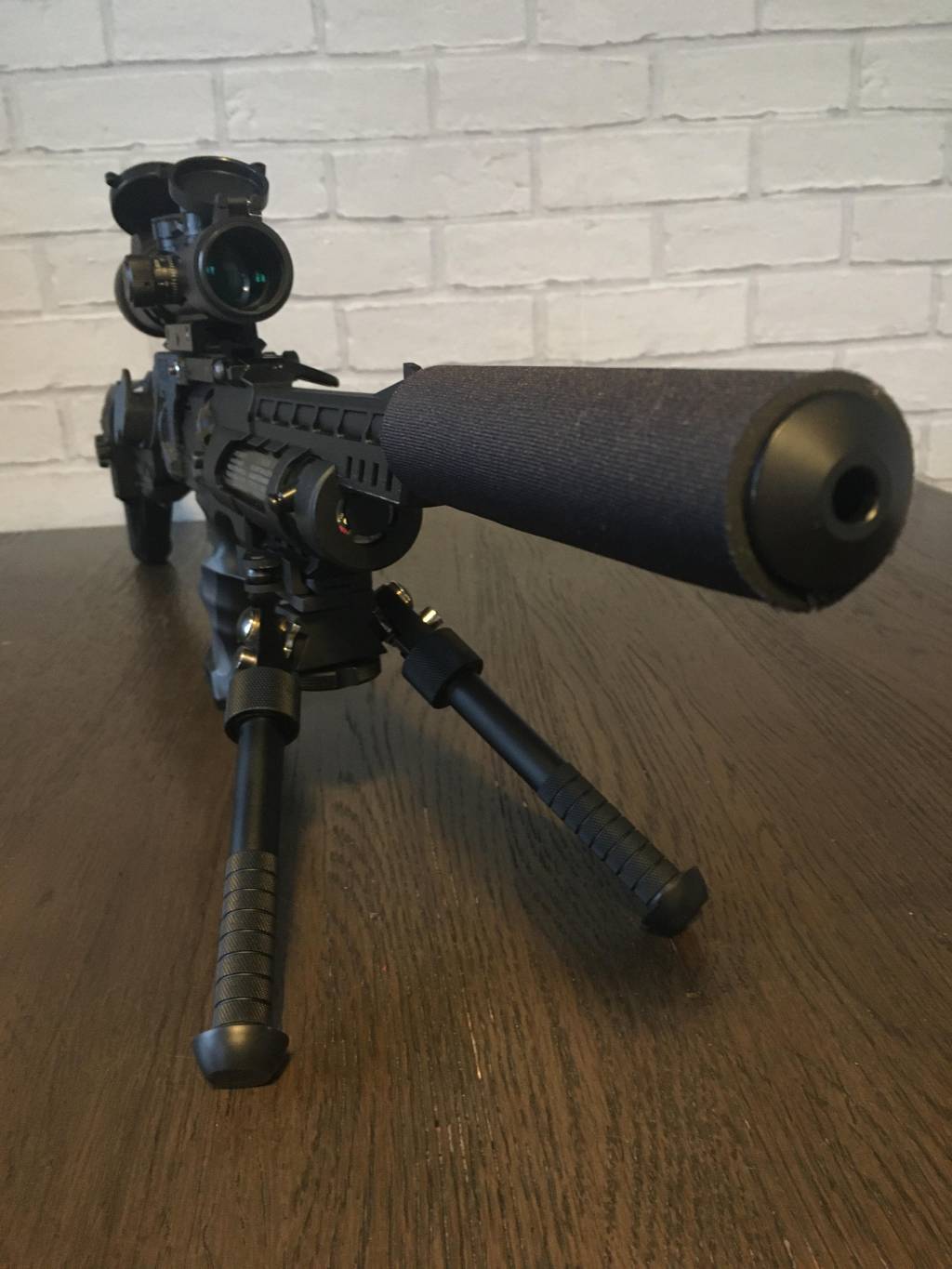

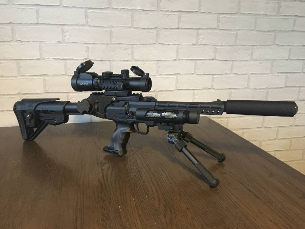

Finally finished it today. I had a few issues as the riser mount was 0.71, I think yours was 0.75. This meant no clearance for sling mount and I had to file down the top of the stock to get a perfect level for the scope. The riser block also has two pretty ugly nuts securing it which can’t be reversed to the other side. It doesn’t foul the cocking lever but it’s ugly...... I added a neoprene cover to the moderator and a narrow view gauge cover. Imitation is the sincerest form of flattery so I copied most of your set up. Honestly I couldn’t have made it any better myself it’s absolutely superb, shoulders brilliantly 6.6llbs with bipod and the scope works like a dream. My only ask would be for more power!! Somewhere over 12ft llb with an uprated cylinder to up the shot count and this would be perfection for me. Thanks again for all the shares and links, much appreciated.

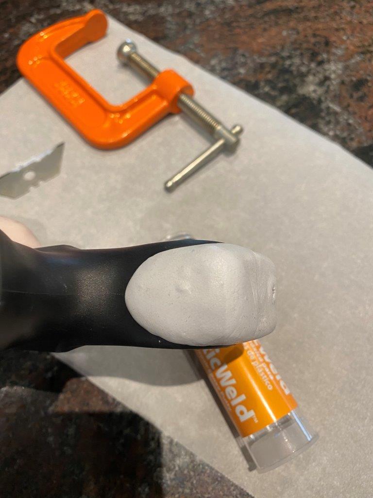

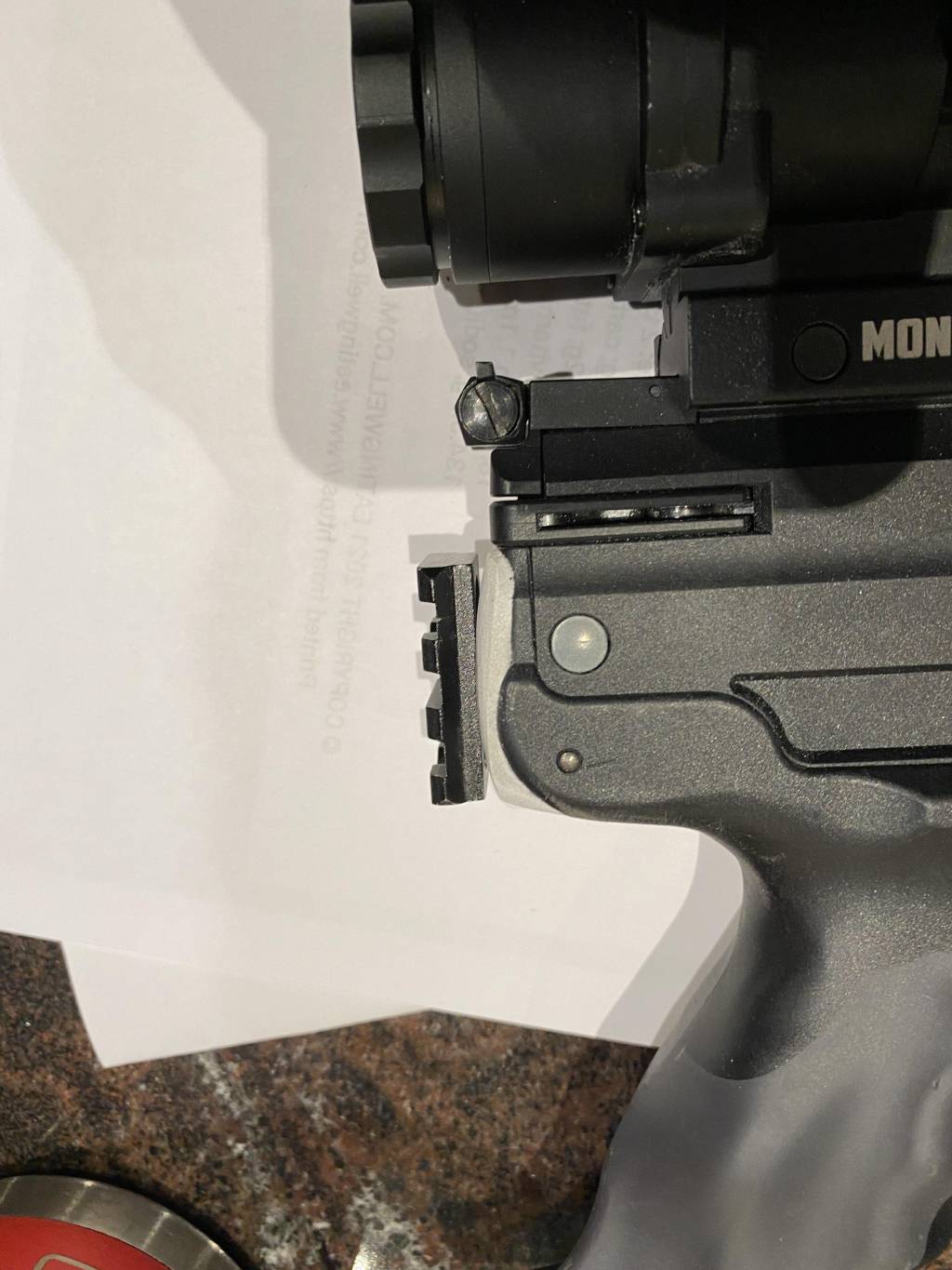

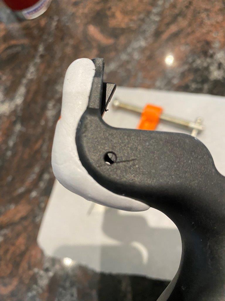

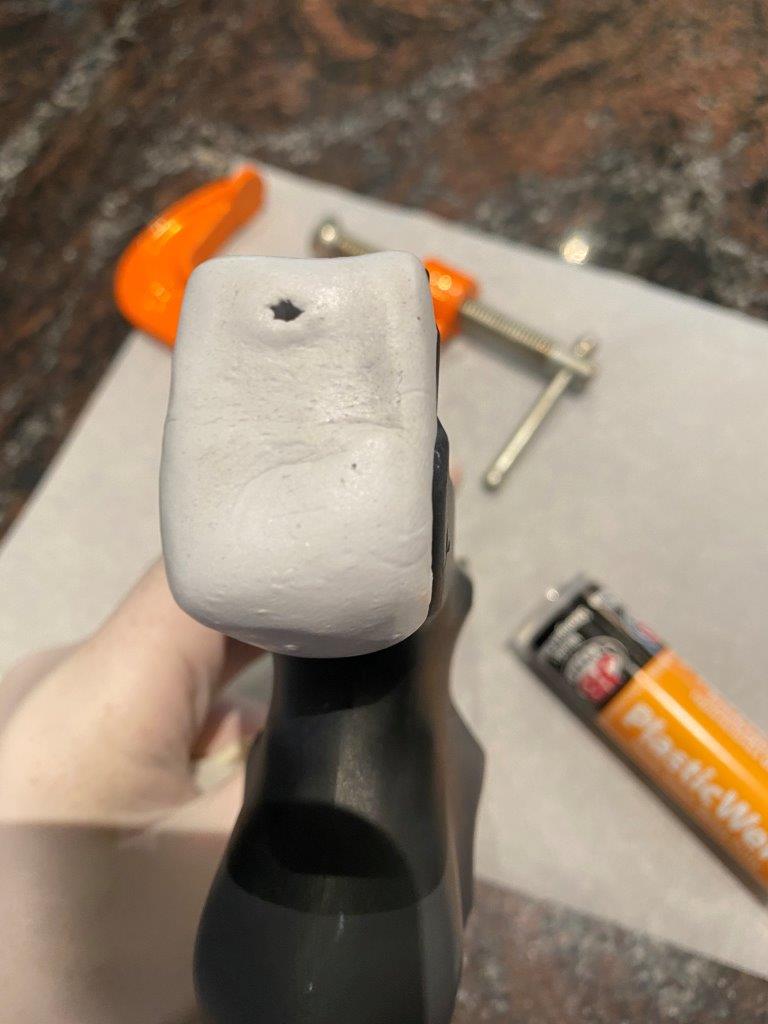

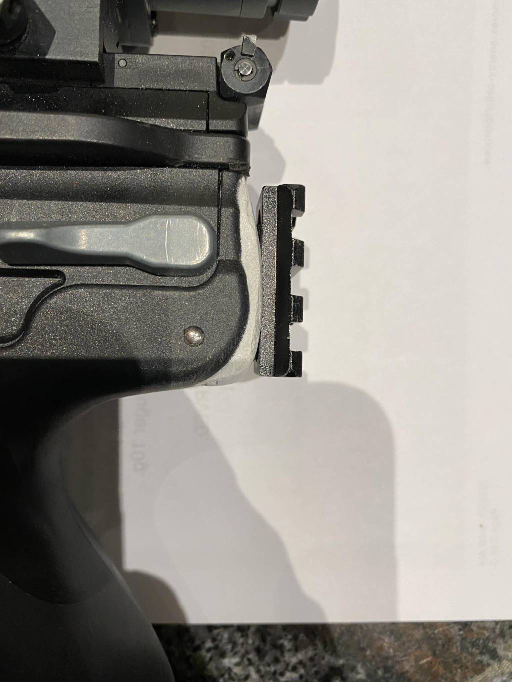

I was not trying to hijack this thread. But onto phase 2 to build up the rear end to create a flat surface. Bought some JB Weld putty for plastic. I have attached to the lower, shaped it and I will let it harden. Once cured, I file and sand it to create a flush surface and reattach the rear rail so it is flush or level. We will see how this goes.
David

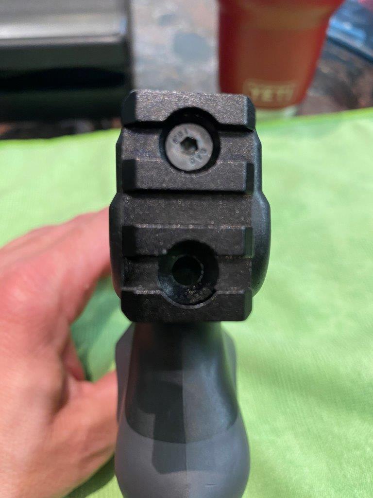

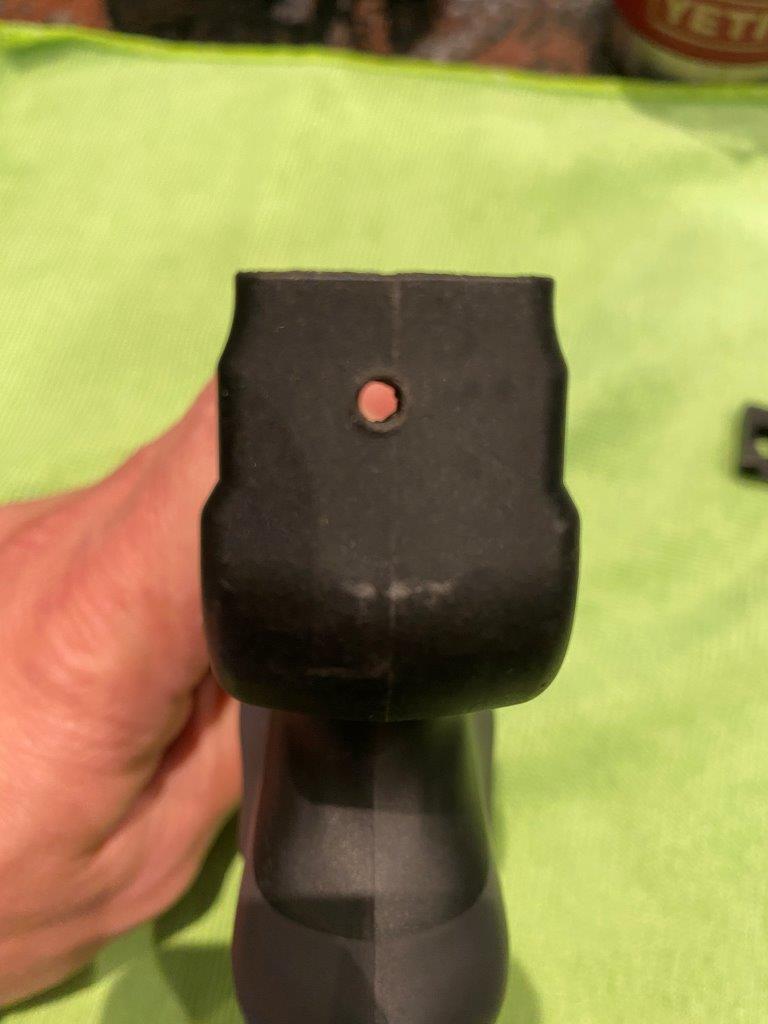

Ok, Well I sanded down the JB weld. Probably a little to much. Really need a belt sander. Hand sander and rasp probably not the best tools for the job. Remounted rail. Still have a little gap below and above rail but more flat or level. Not bad for an amateur. Mount is strong and does not twist or move when I fold or unfold the stock.
Before
after
before
after
I think if Weihrauch would just mold a rail into the rear of the gun it would be easier and give the user a ton of options. They already have a top rail and lower rail molded with a picatinny rail how hard would it be to add it to the rear handle assembly.
