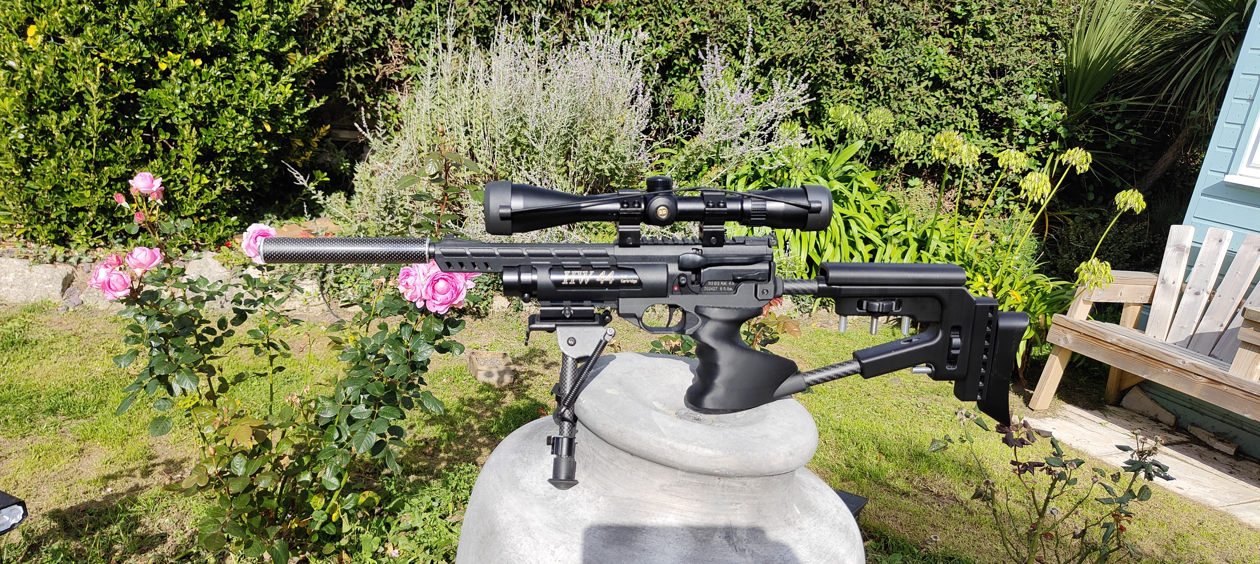

It becomes a different animal when you Carbine it. The problem is that in the uk the max power as a pistol is 6ftlbs. Now its the same power plant as the hw110 as you know. The carbine stock is strong stiff and effectively turns it into a small rifle. there is no reason that it cant be upgraded to 12 ft lbs but apparently not. What is the max power the 44 can be shot at in the USA.

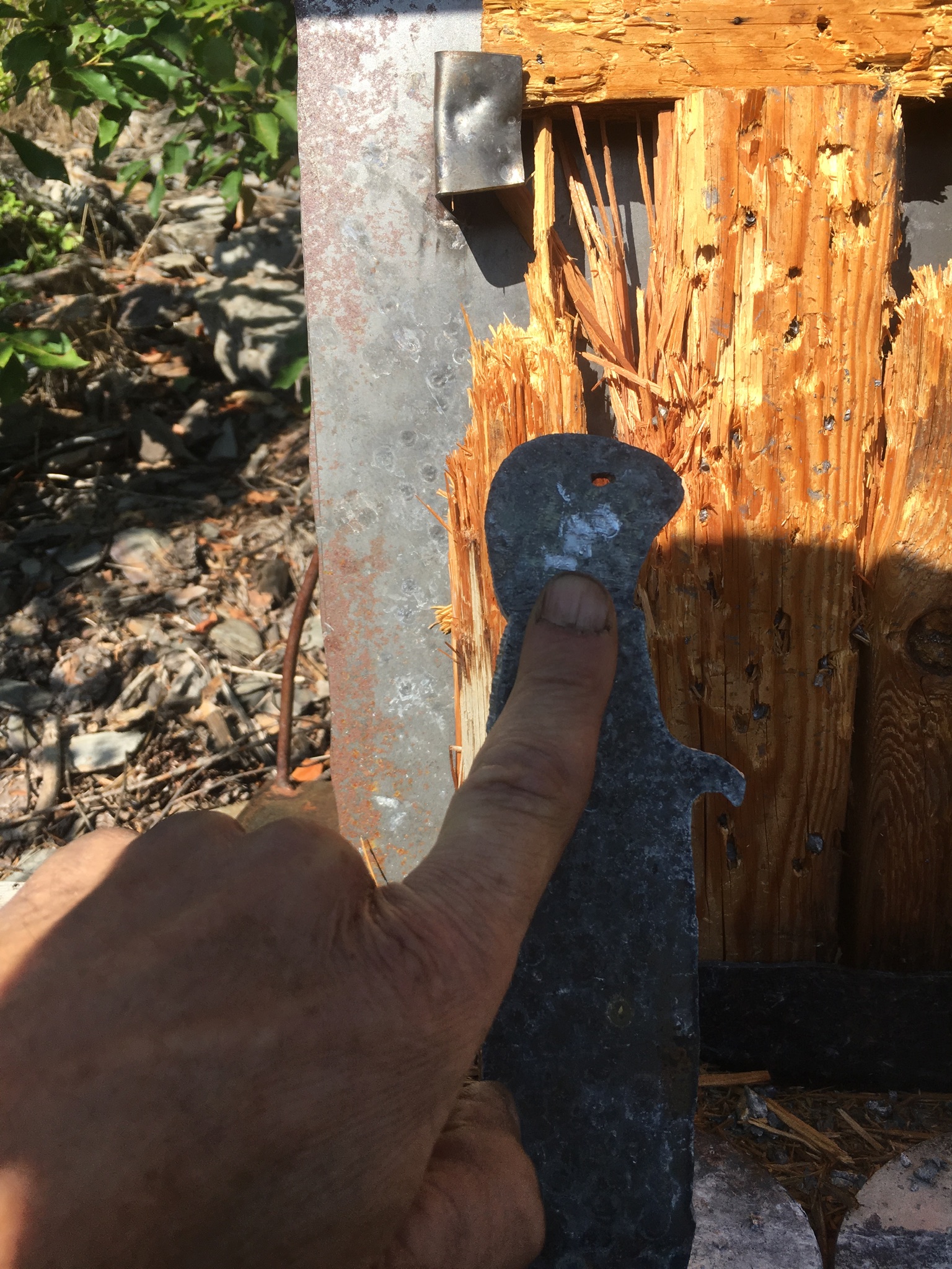

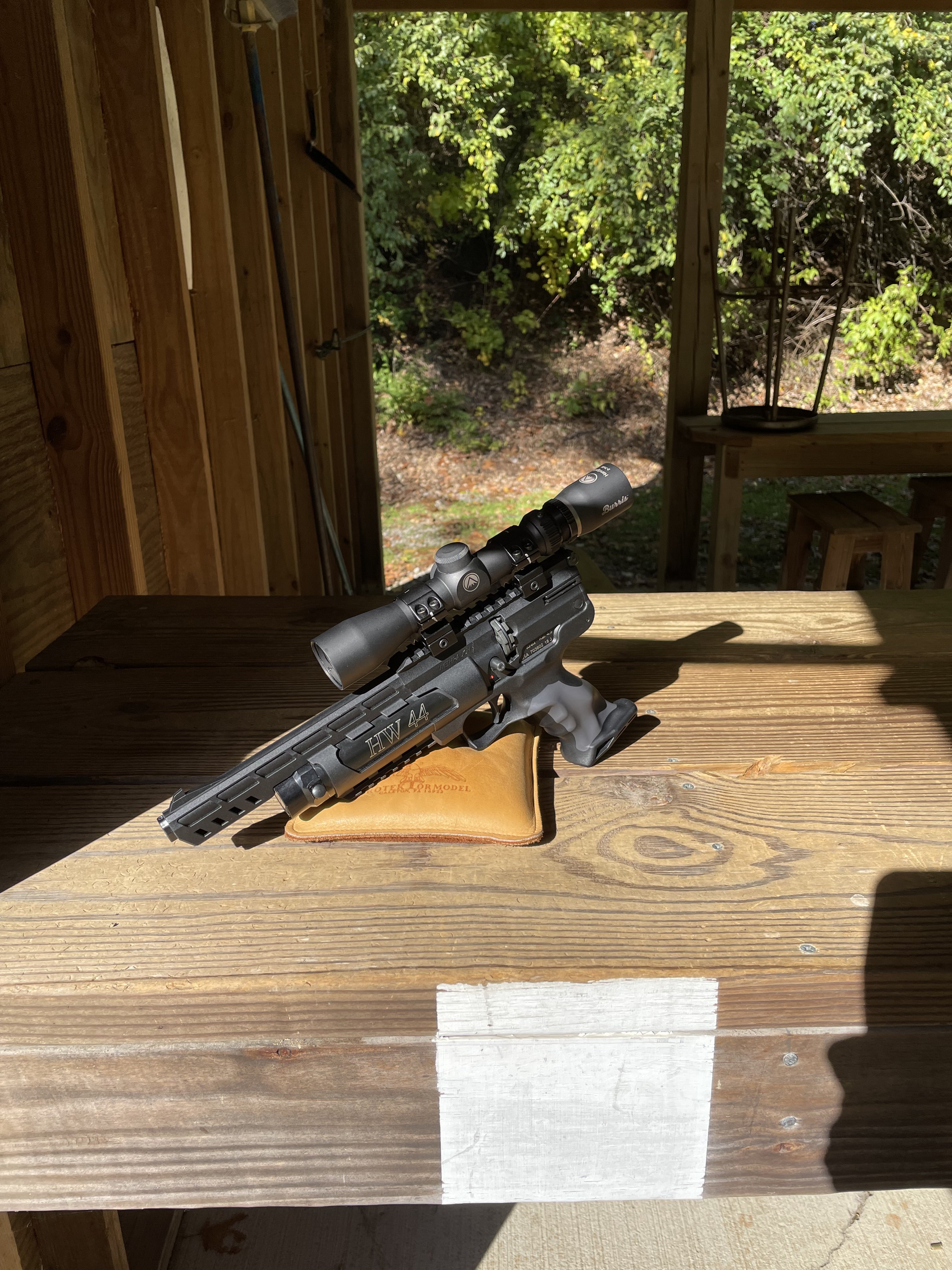

I like a scope on mine and to shoot off of bags. Here’s a ground squirrel target I shoot at 60 yards.

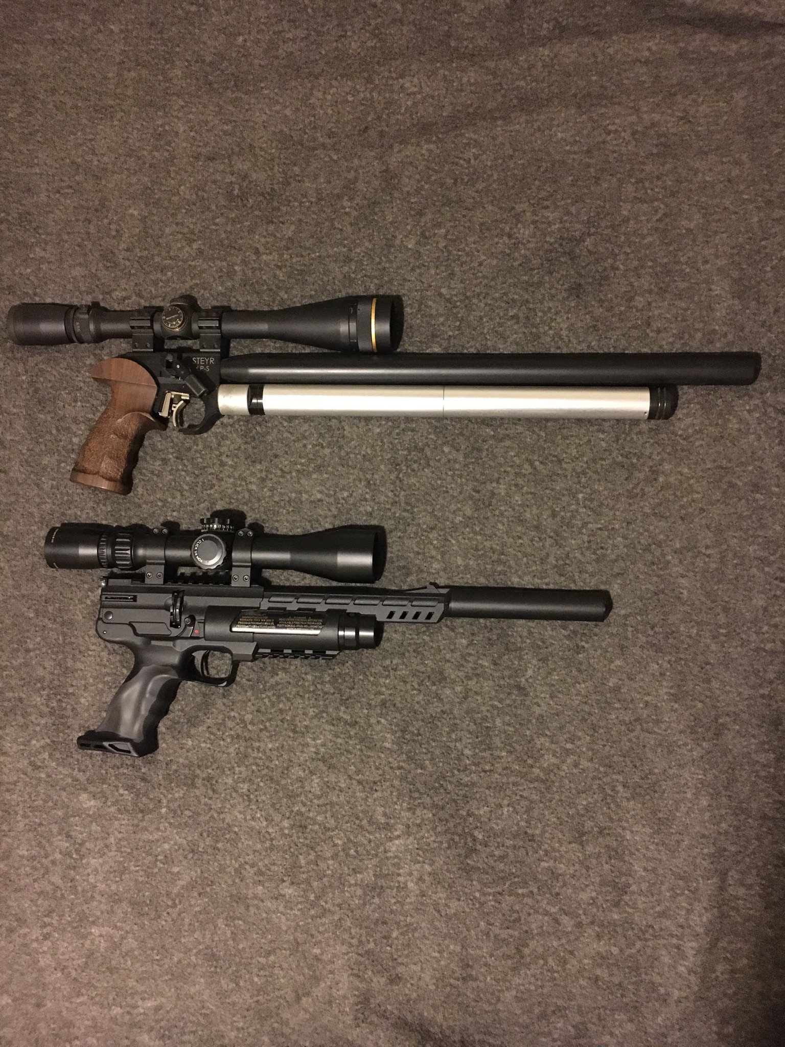

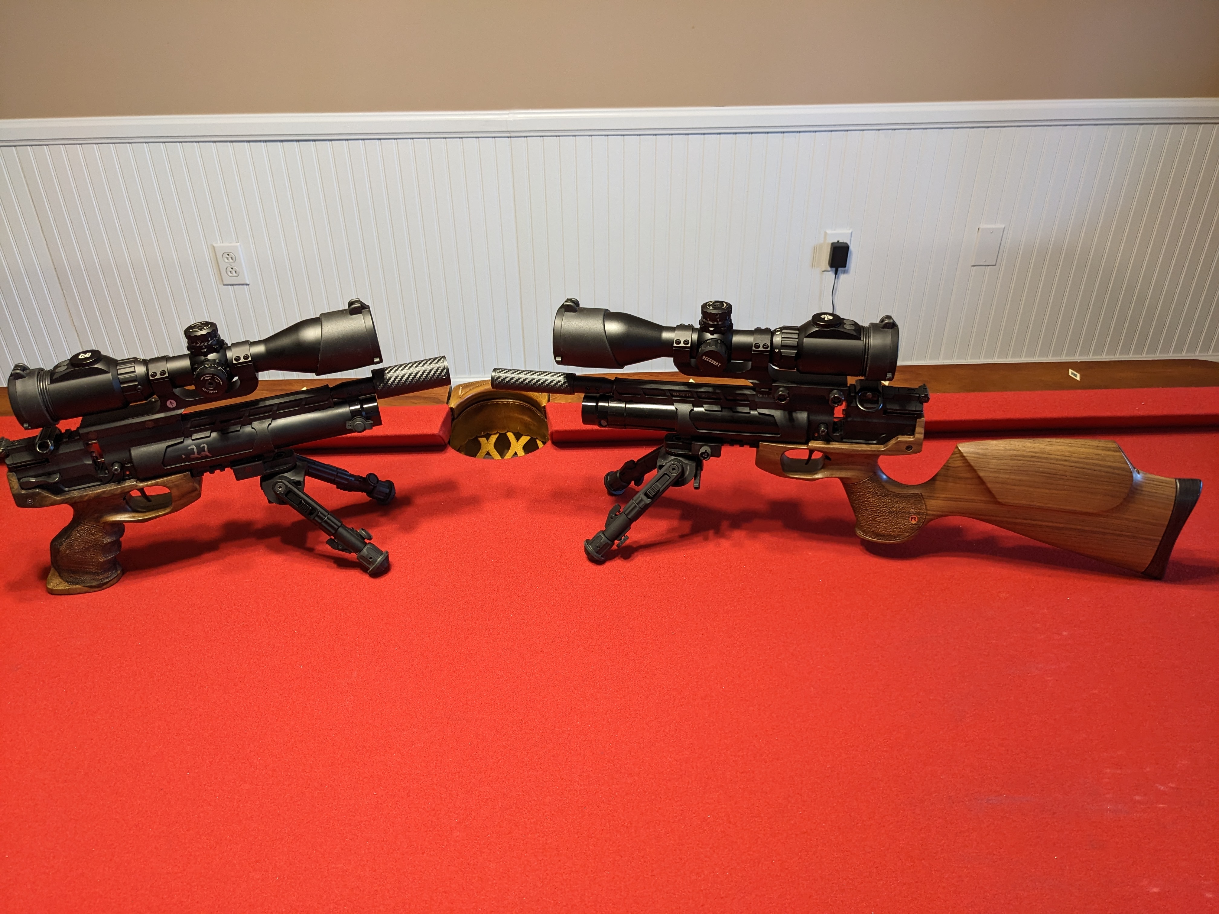

Here's my twins. Shot count doubles with the carbine air tube. I get 40 shots from both .177 and .22. The .22 shoots JSB 16's in the 660's and .177 with JSB 10.3's in the 750's. I've not changed any settings on either. Purchased the .22 used so can't confirm it wasn't tinkered with, but I doubt it. Only down side is cutting down the plastic shroud. I checked to make sure it could be replaced if I wanted to go back to the original setup, but that just isn't going to happen.
I had a spare air tube after I put a longer Ratworks aluminum on my HW100 bullpup and finally talked myself into giving the conversion a shot. Turns out it's not very difficult. You could just leave the plastic shroud off but it didn't look nearly as good and I didn't want to lose the bottom rail. Figured it might be needed for barrel support also. I originally rigged up a way to use the Weihrauch moderator but I just wasn't happy with the way I had it mounted and wound up buying an adapter from DonnyFL to slide over the barrel and add a shorter moderator. It's definitely not as quite, but quite enough for me. If you used a longer moderator it might be just as quite. The moderators on mine are of the homemade variety. I was going to replace the steel air cylinder on the .177 with another Ratworks aluminum but since I always shoot off a bipod the extra weight doesn't really matter.

40 shots would be so good. Thanks for posting about it, I’m going to look into getting the air tube.
I like the look of both guns, and 40 shots is awesome.

Where did you find the air tube?
First link takes you to the Ratworks home page, second link goes directly to the air cylinders. You can buy just the cylinder or complete with ends. I've purchased three in the last couple of years, one carbine length for my hw44 and two rifle length for my hw100 bullpups. As I said in my first post, I used one of the steel cylinders on the other hw44. I've always used the ends from the original cyclinders, but I'll warn you they are somewhat of a pain to get off. Don't over heat the end with the gauge with a heat gun, it will warp the indicator. Ask me how I know:mad: Titanium cylinders are also available. Don't remember the vendor but I think they're sold on ebay. They are considerably more expensive.
