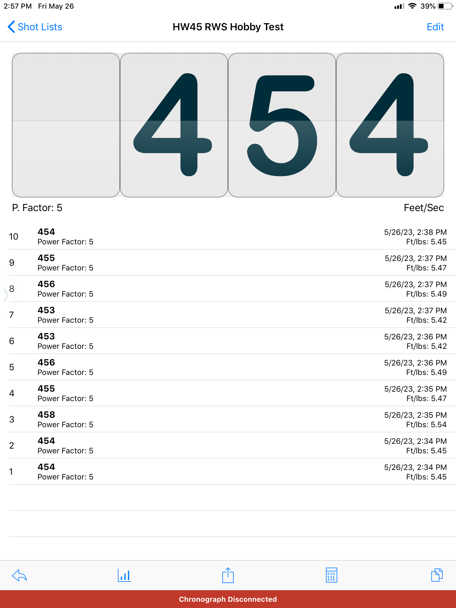

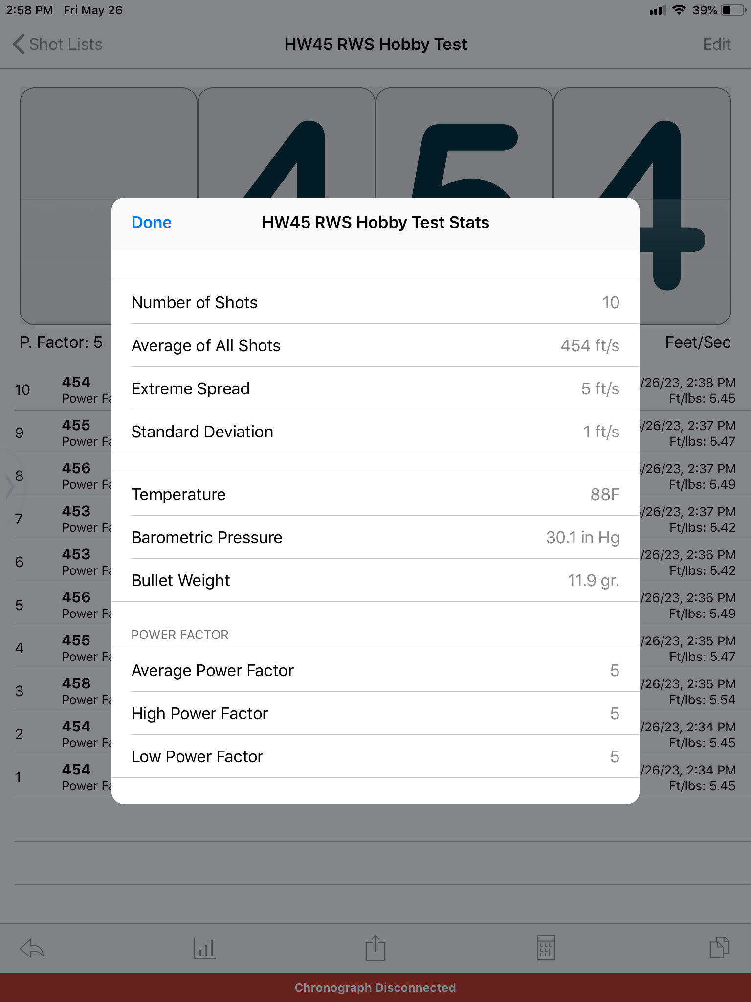

Yeah boyeee, believe we done found ourselves a pellet! Couldn’t ask for more. The Excites were almost as good. Heavier so little slower and about 1/10 less FPE. Spread of 7 and SD of 2 so not exactly terrible. I like the sound of the Hobbies better although shot cycle actually seems a little smoother with theExcites, little less muzzle flip. In my highly scientific offhand spinner shooting last night the Hobbies had a slight edge in accuracy. Bout to order a bunch of them because this gun is a blast to shoot.
OEM spring and breech seal. Parachute seal from D&L in Canada. Suspect it’s the same as the Aussie seal, purple color. Link below. Very small amount of ARH moly on spring and edge of piston seal. Seriously, I use a Q-tip like makeup applicator. This gun doesn’t need a lot of lube to make power contrary to what I’ve read elsewhere. Almost no dieseling. No smoke at all, can’t smell it unless you sniff the barrel. Don’t ask how I know ha ha ha. Polished spring ends. Couldn’t find a 1/2” nylon bolt to make a spring guide for the muzzle end. Believe that’s a good idea and will do later. Will certainly help putting it back together. With the light lube it pinged a little for 75 shots or so until everything distributed but that’s gone now. Having a blast trying to master it. All the difficulties of a springer combined with all the difficulties of a pistol. What could possibly go wrong? :D

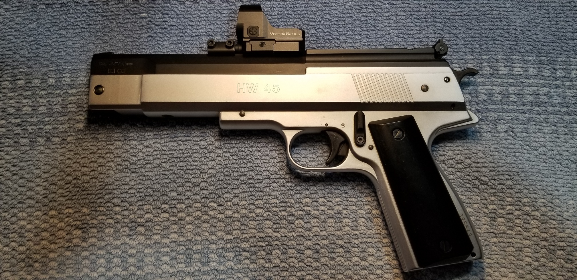

Wondered same. Guessing they cut one of the Eaglevision mounts to length but we’ll see. My dovetail tapers from just over 14mm near muzzle to about 13.5 I think on transfer port end? Assuming it’s designed that way maybe to ease putting mounts on from narrower end? The BKL mounts should hold and not mar. All one piece of Al and you actually flex it to clamp. Just not crazy about how high they sit. If the new mount has set screws to rail there will be heat shrink or similar protecting the rail.

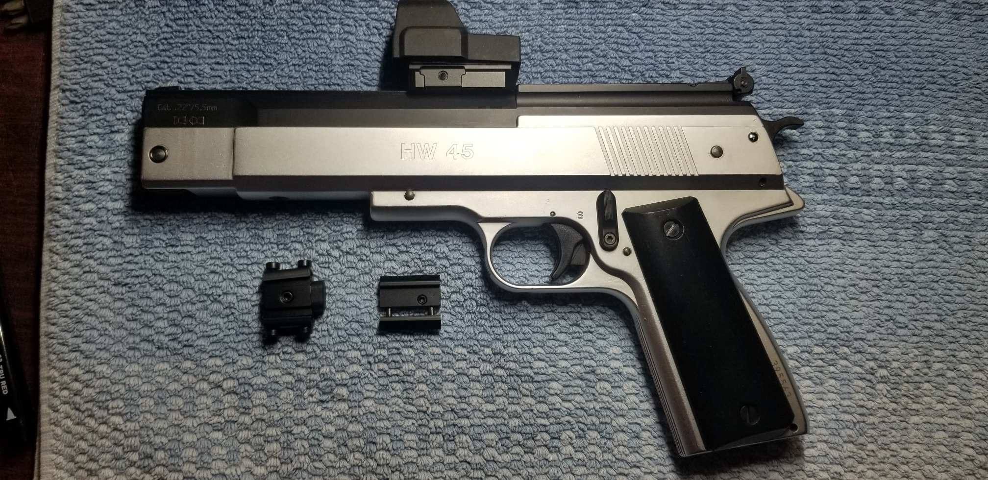

Well, Mycapt65, I don’t know if I have this thing tamed but this is a trick bit of kit. The dovetail to Pic rail adapter is piece on right side in first photo. Spring loaded, no set screws. Just slips onto rail like normal dovetail mount. RD is on Pic rail mount already. Fit it onto adapter and tighten the screw on Pic rail mount. Done. No set screws into the rail. Other small piece is a recoil stop. Recommended for HW45. Again, mounts just like a dovetail ring would. Not crazy about the aesthetics of the stop, emailed them to see just how strongly they recommend it. Also asked about screw torque. RD manual said no more than 16 in-lb for their mounts so I have everything at 15 including the recoil stop.
Edit: The top of the BKL mounts would be about double the height of the recoil stop in the pic. Great for a small scope I guess but way too high for RD.
Looks pretty cool. I agree it'd be nicer looking with out the stop. I tried similar snap fit internal adaptors and they always buckled when clamped near hard enough to hold on to the rail if they had any room above of below them to deflect. The stop probably alleviates that the need for over tightening.
If this set up proves itself over time it will be a great discovery for HW45 owners. Well done you.
Thanks, Ron. Heard back from the owner this morning, super nice guy. He said if you like re-zeroing frequently then you don’t need the recoil stop ha ha. Said the HW45 just has too much recoil and no matter what you do the RD will slide forward without it. The nice thing about these guys is that they love their HW45s and shoot them regularly so they’ve field tested all this equipment on their own guns. See what I think after a couple tins of pellets. Buddy coming down and weather looks decent so we’re likely to get a little testing in.
