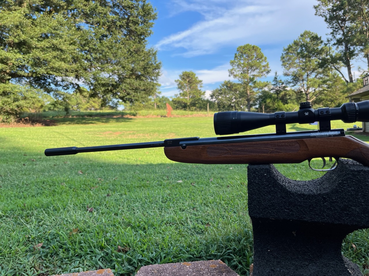

So am having an issue with getting my HW50 in 177 zeroed.
Backstory: Bought the gun used from a fellow member here. Gun looks great barely used, has an upgraded Vortex kit.
Purchased TO4C rings for the gun based off of suggestions here from pyramid air.
Purchased vortex 4-12x40AO scope new from B&H. Went with Vortex over Hawke due to VIP warranty.

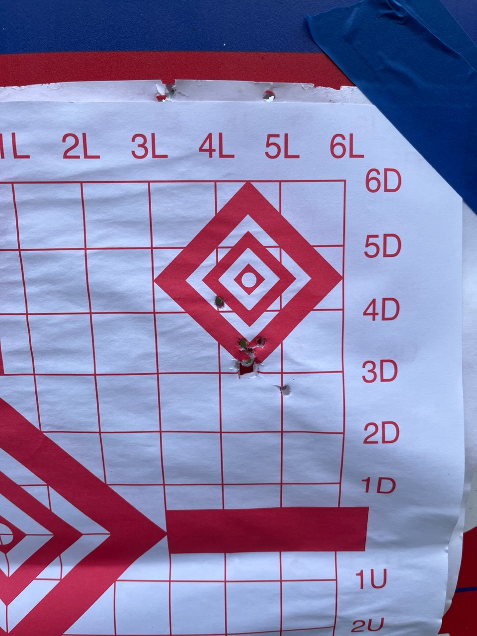

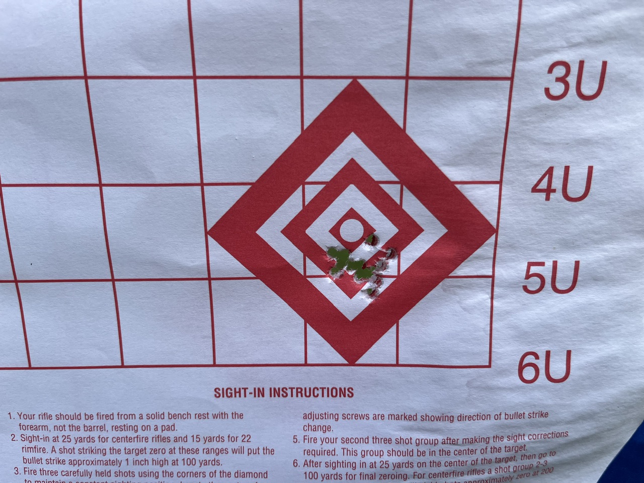

Mounted said scope and rings on gun and tried to zero and scopes elevation was bottomed all the way up at 20 yards to get a 1.5-2” low zero.

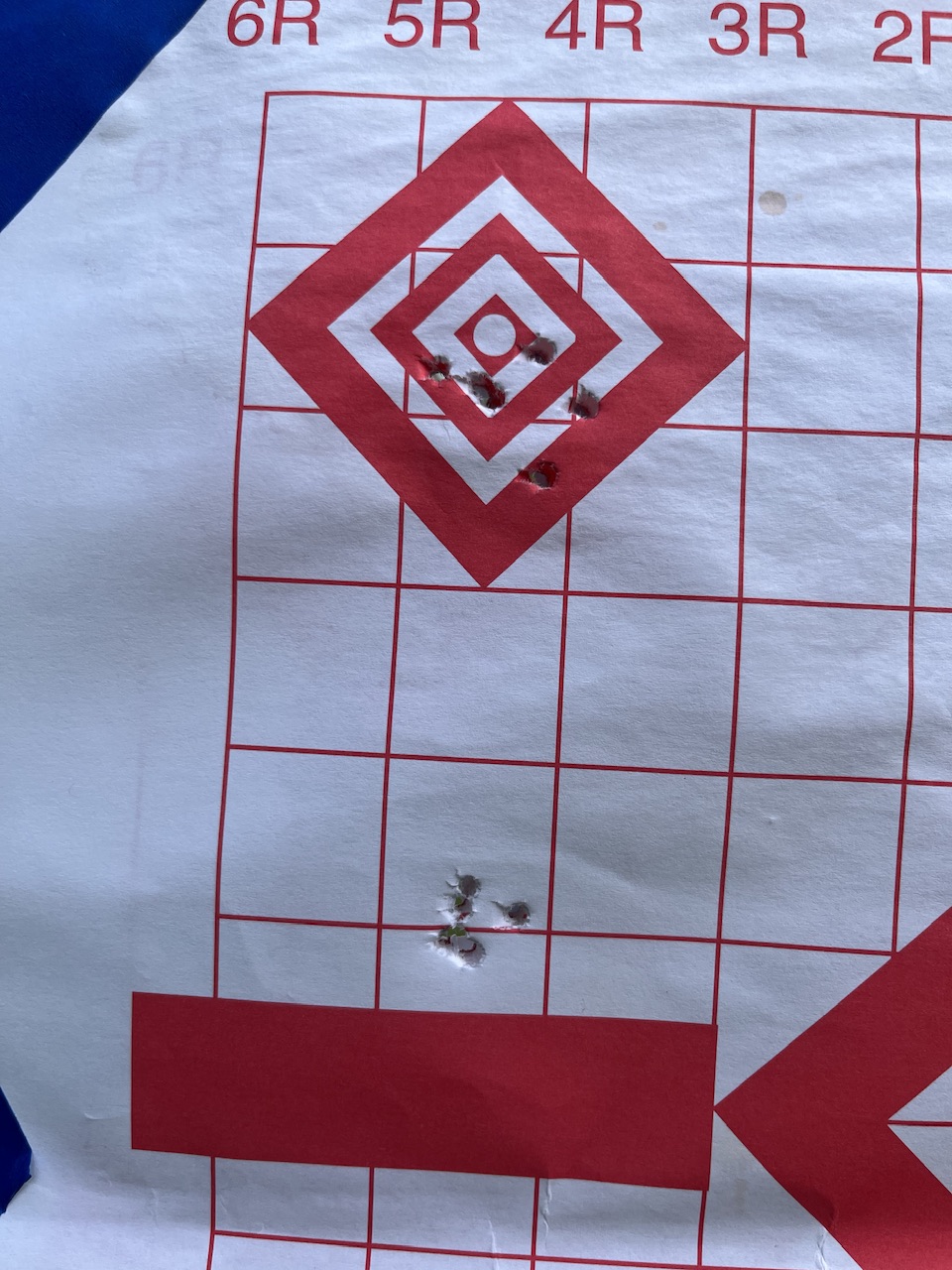

Took everything off today and double checked rings and ring tension. Re zeroed scope and same issue. Scope has to be cranked all the way out to the Upper limit for a 1” or so low zero at 20 yards.
Gun shoots great. Tested 2 pellets and shows great consistency. Even with the low zero I am able to make hits out to 50 yards.

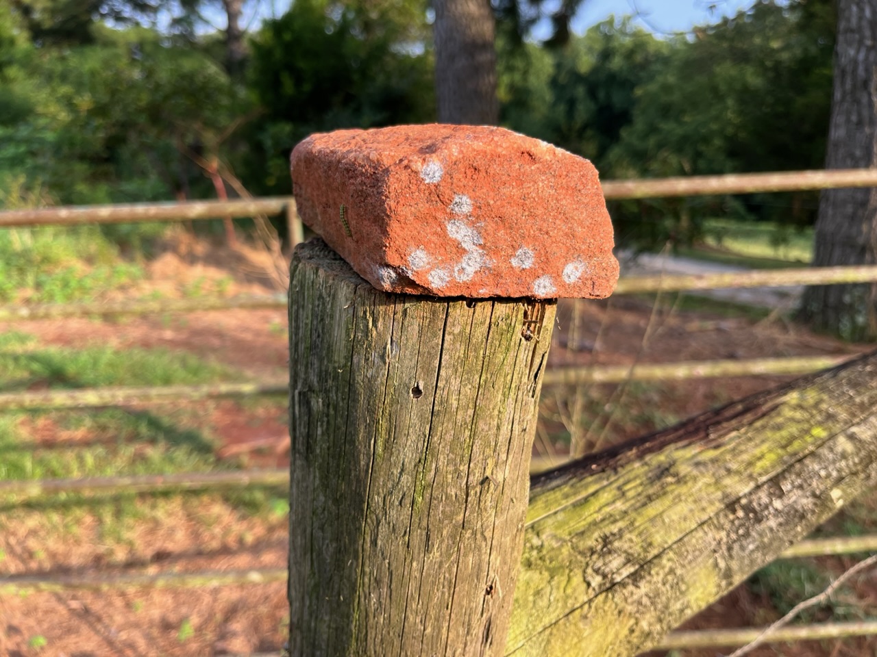

Rock at 50 yards on fence post.
So my question is what am I missing which is requiring the scope to be cranked all the way up to be zeroed?
Someone mentioned barrel droop in my scope thread but the gun does not appear to have that issue. Is there a way to measure for that? If it is barrel dropping how do I fix it?
The only 2 things I can think of is something is wrong with one of the rings causing a zero issue. Or scope is defective in some way.
I measured the rings and both seem to be the same size from receiver to bottom of scope. They were taken off and inspected today and reinstalled.
I also cranked the turret down 12 clicks and the response was reflected on the target so it appears the scope is properly tracking.
Seems as if I have 2 options. Send the scope back to Vortex, or shim the front ring to gain more elevation and rock on.
What’s yalls thoughts on the issue?
If shimming the front ring what’s the best way to do that?
Was thinking of a small strip of electrical tape in the bottom of the front ring.
