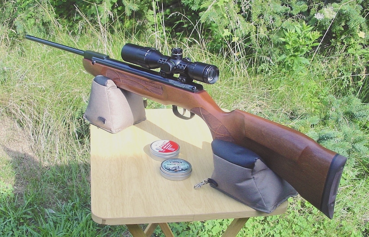

Nice setup. As I mentioned, I'm leaning towards medium 1 piece Sportsmatch rings. I'm also planning on hand stitching some shooting sandbags out of leather to enhance the shooting experience. Can't wait until spring time, it won't come fast enough!It's not a Vortex, but I mounted a Bug Buster with a 32mm objective on my HW50S using Sportsmatch medium height 2pc rings and it gave me a little over 1/8" clearance between the receiver and scope. My rifle has no droop. The height dimensions of the one piece and two piece Sportsmatch rings are the same.

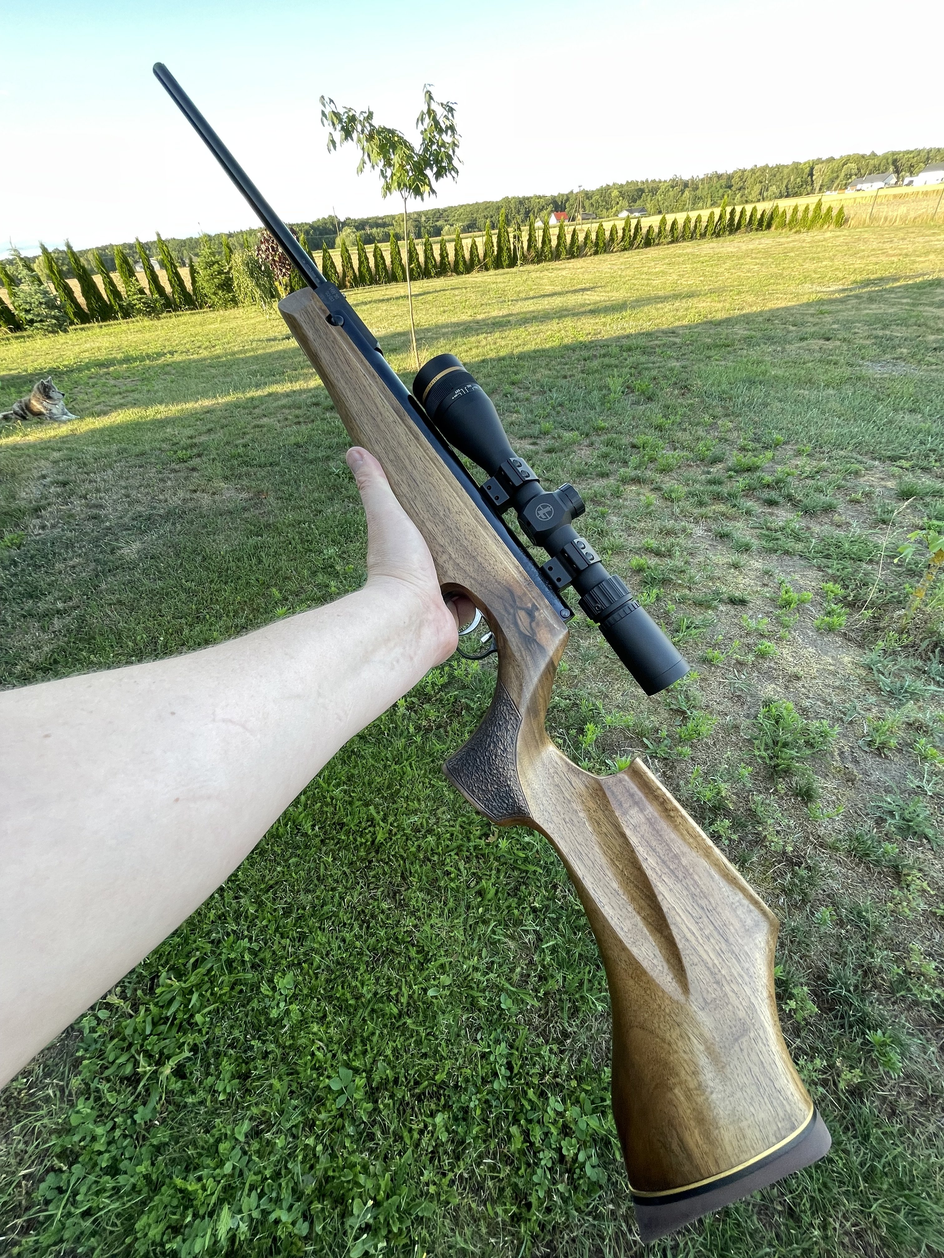

Nice and low, but enough clearance for the AO-
