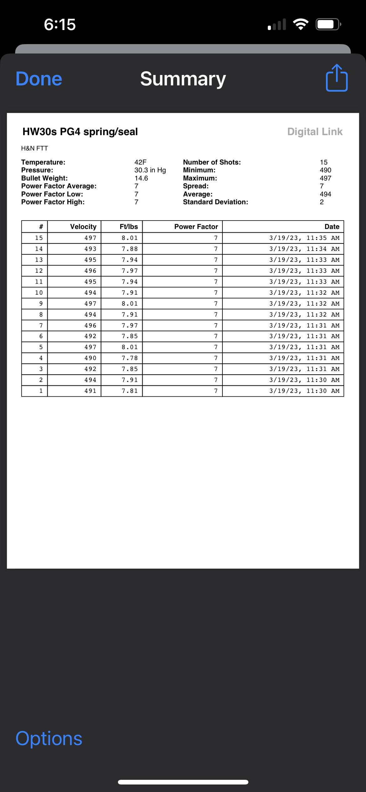

Does your .22 HW30 remain nice and smooth at 8fpe? What pellet do you like to use at 8fpe. Thanks,
Kenny
It's extremely smooth and quiet. It likes H&N FTT and CPHP, the poi is exactly the same for both but the FTT's group just a touch better. Here are some chrony numbers with a Vortek spring and seal.

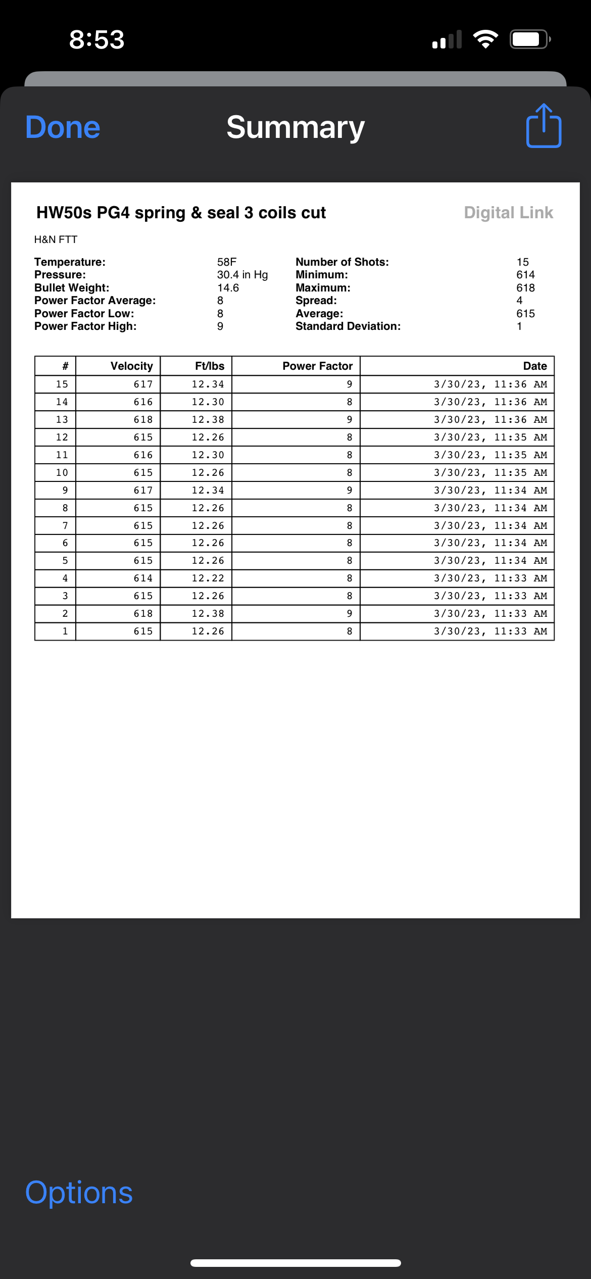

Thanks Frogy. Thanks for sharing your notebook. Those power levels are just about what I’m looking for; especially with the 10.34 pellets. Your rifle seems to shoot a bit low for a factory tune. Do you live at a bit of a high elevation?
Kenny
Nope good old plains of IL. You had me wondering about my power. Factory up to 840. Went back and researched the many post about this Model. A people posting there fps I’d say I’m shooting right in the ball park 😀 I’ll recheck my numbers after another 500rounds. Thanks
