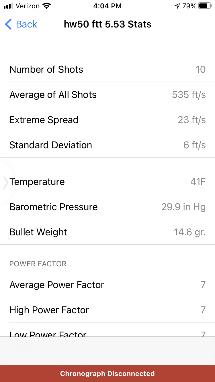

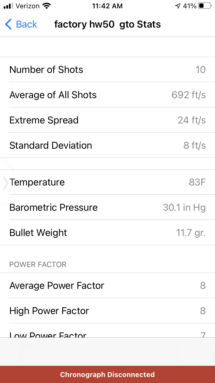

HW50s .22 when new last January:
rws hobby 645 fps 16 extreme spread
rws meisterkugeln 628 fps 12 es
FTT green 731 fps 56 es
FTT 5.53 535 fps 23 es
GTO 692 fps 24 es (most accurate)

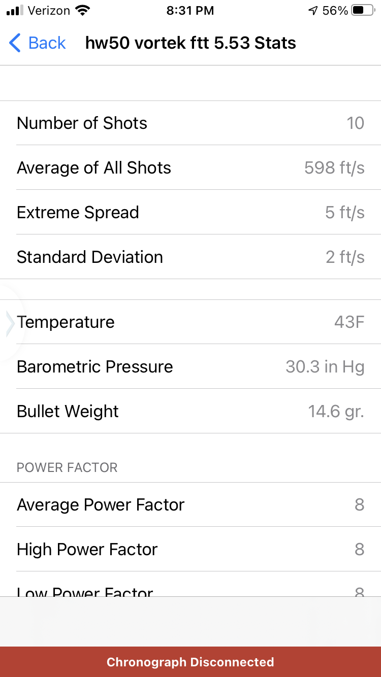

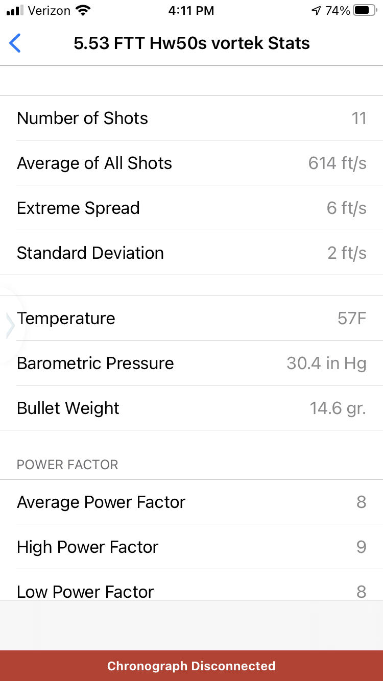

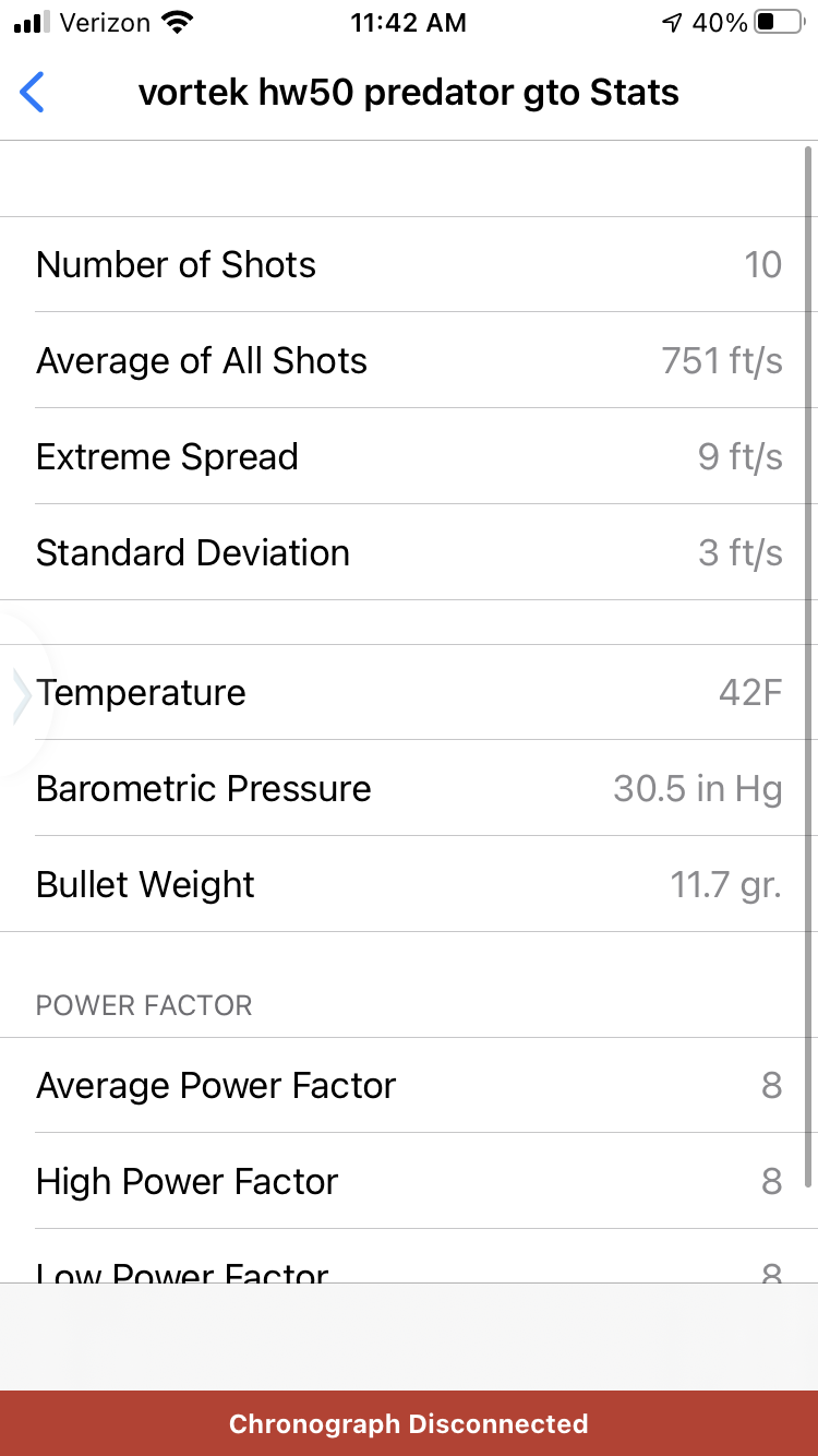

Fifty shots into the break in before and after chrony summary.
To wrap this up, I decided to install the vortek kit in this gun because I could not get the scope to stop moving. Like I mentioned earlier only 1000 shots since new. I tried sportsmatch rings and the arrester pin was backing out. Next I tried a hawke one piece mount with screw in stop pin with blue loctite. There is visible damage to one of the stop pin holes from the scope base moving. Then the scope was moving in the base with everything torqued to proper spec. Long story short I done some damage to the scope tube by adding a little more torque to the top straps but it did quit moving lol. It finally held zero for me but still I knew something had to be wrong with the gun. It wasn’t loud or anything like that and the shot cycle was exactly the same since new. I let it sit for months and finally pulled the trigger on the vortek kit. The factory spring was broke and the factory piston seal was 25.85mm .35 mm smaller diameter than the new vortek piston seal and moved freely in the comp tube. I don’t know if this under sized piston seal was from premature wear or if it was made wrong. My theory is the piston wasn’t properly sealing and was slamming a little and caused all the scope movement issues and spring breakage. Anyhow this HO vortek kit is pretty consistent and pretty powerful. I’m not bashing weihrauch in any way just putting information out there that may help other air gunners. My experience with this gun is definitely not typical in any way, shape or form. The fact that it fired as accurately as it did is a testament to Weihrauch quality. I own one other weihrauch and plan on owning more, hopefully many more in the future and will never part with this Hw50 Hunter.

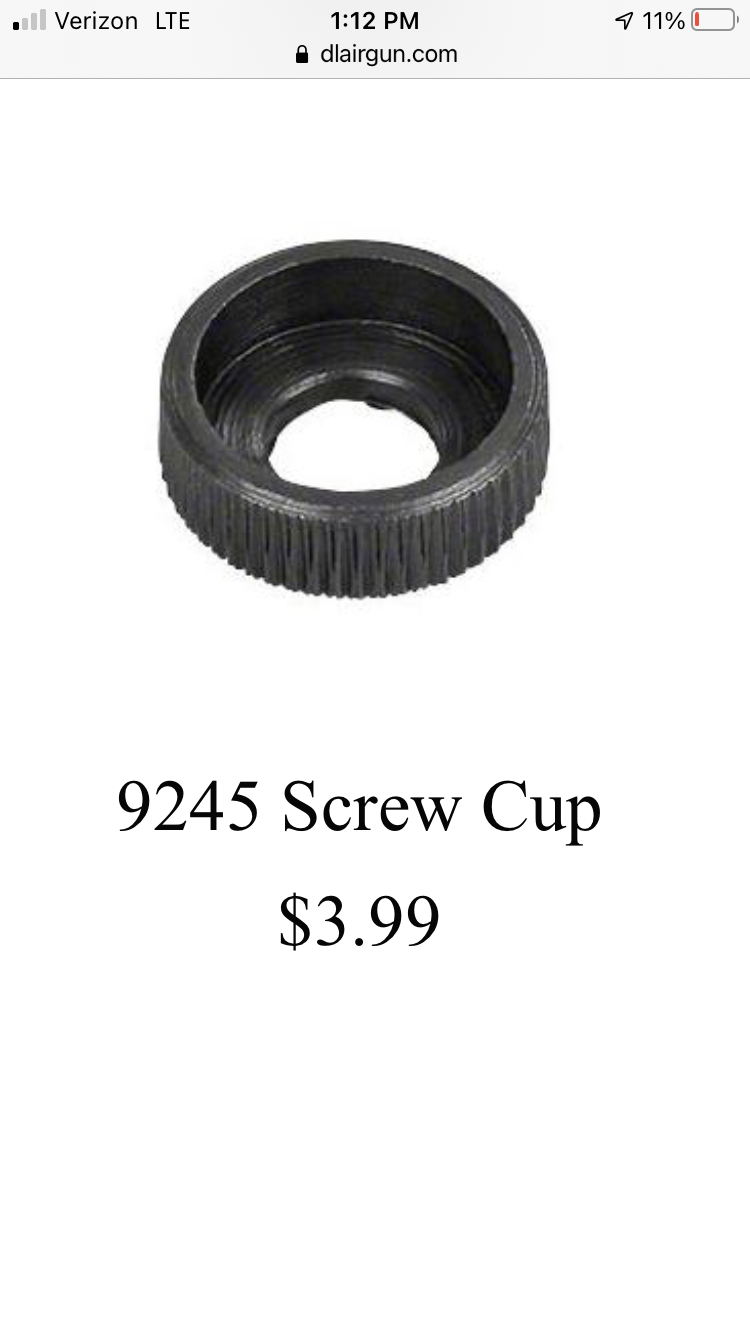

This is turning into a HW50 diary. The hw50 developed a little cocking noise so I decided to take it back down. I ordered some barrel shims while I was at work just in case I damaged them during the assembly process. I came across this picture on the website.
It turns out I found something on the floor in front of my work bench that looked just like it and like a dumbass I threw it away. I looked up a schematic of the gun and I ordered the replacement fore end screw cup #9242. After a little investigating, it appears the sound is coming from the cocking slot so I’m going to clean up the slot and the cocking arm. Also there was a bunch of burnt grease on the piston seal so I’m going to clean everything up and regrease the gun more carefully this time.
I got the spring cup from dlairgun.com it’s a Canadian company and shipping was steep so I ordered extra screws and barrel washers and all the goodies to make it worth the shipping cost. They have plenty of pellets in stock also for those who can’t find them and parts in stock for a bunch of makes and models. I cleaned up the cocking linkage “tip”and cocking slot with with a dremel (very carefully I have tool room polishing experience) and cleaned up any burrs. I also removed the spring under plastic cocking guide and set the barrel tension a little looser than it was. It now cocks like a dream, no noise and very easy.
For the newbies and rookies like myself here’s a picture of the forend screw cup in place with a spare cup for reference.
I could be wrong but without the screw cup in place the end of the screw may rub against the cocking arm. There is not a lot of wood thickness in there so the screw cup (or washer(s) in a pinch) is definitely necessary.

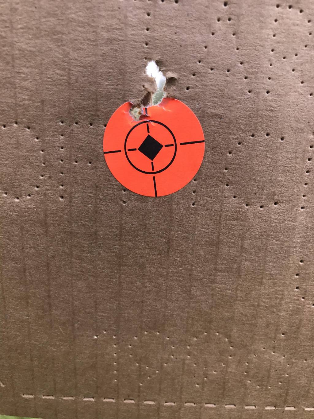

 Finally got the hw50 out to the range and it did pretty good with the .22 GTO pellets. My scope elevation turret was moving 1 click with every shot and it took me a while to figure that out but I was able to get pretty respectable groups with it. Then my stock screws were loose. I’m such a rookie. My scope is not the best it’s a fixed 4 power and the tube is bent from over tightening it. I really need to replace it. It’s the Weihrauch fixed 4x that came with the gun.
Another guy was at the rifle range shooting a .22 LR and he was REALY impressed with my groups. Cool side note, he was an engineer that made his own silencer. Titanium and stainless steel and he had $700 wrapped up in it after the tax stamp. He was even more impressed with my squirrel hunting stories and the fact that I practice in my basement. Anyhow here’s my best group at 25 yards.
