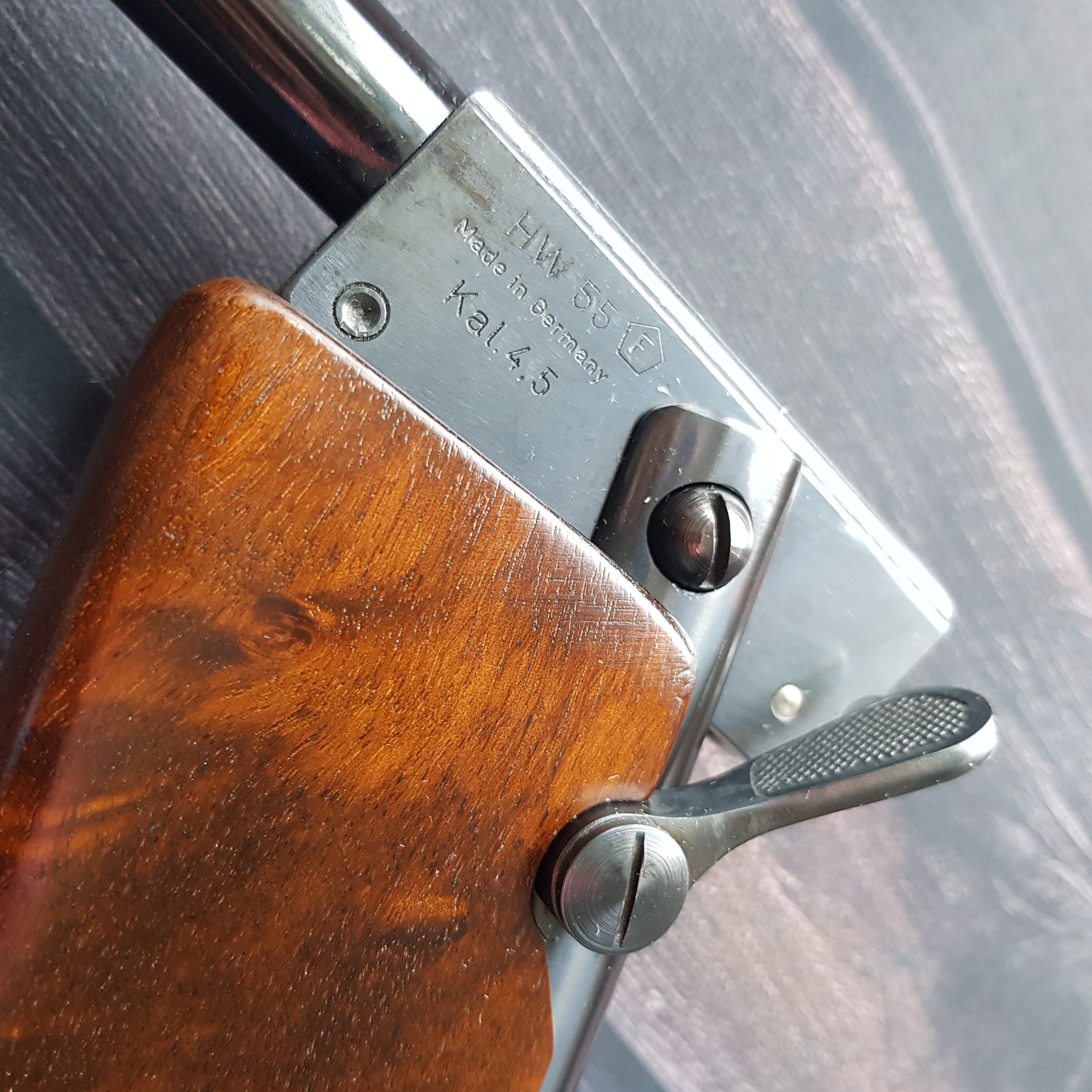

HW/Weihrauch HW55 Standard date-of-manufacturing
Very interesting - 1973, which is earlier than I would have thought. Much obliged!

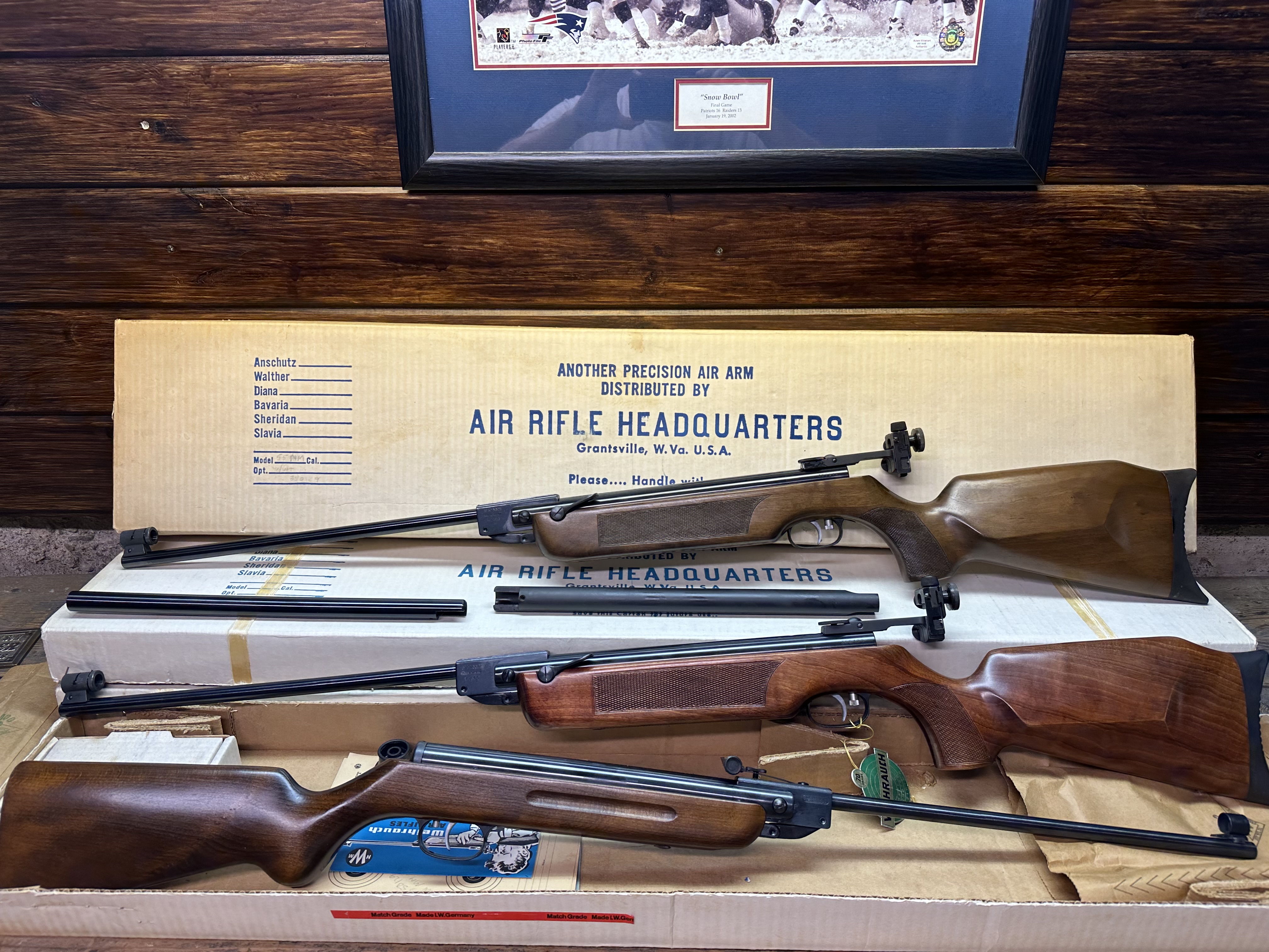

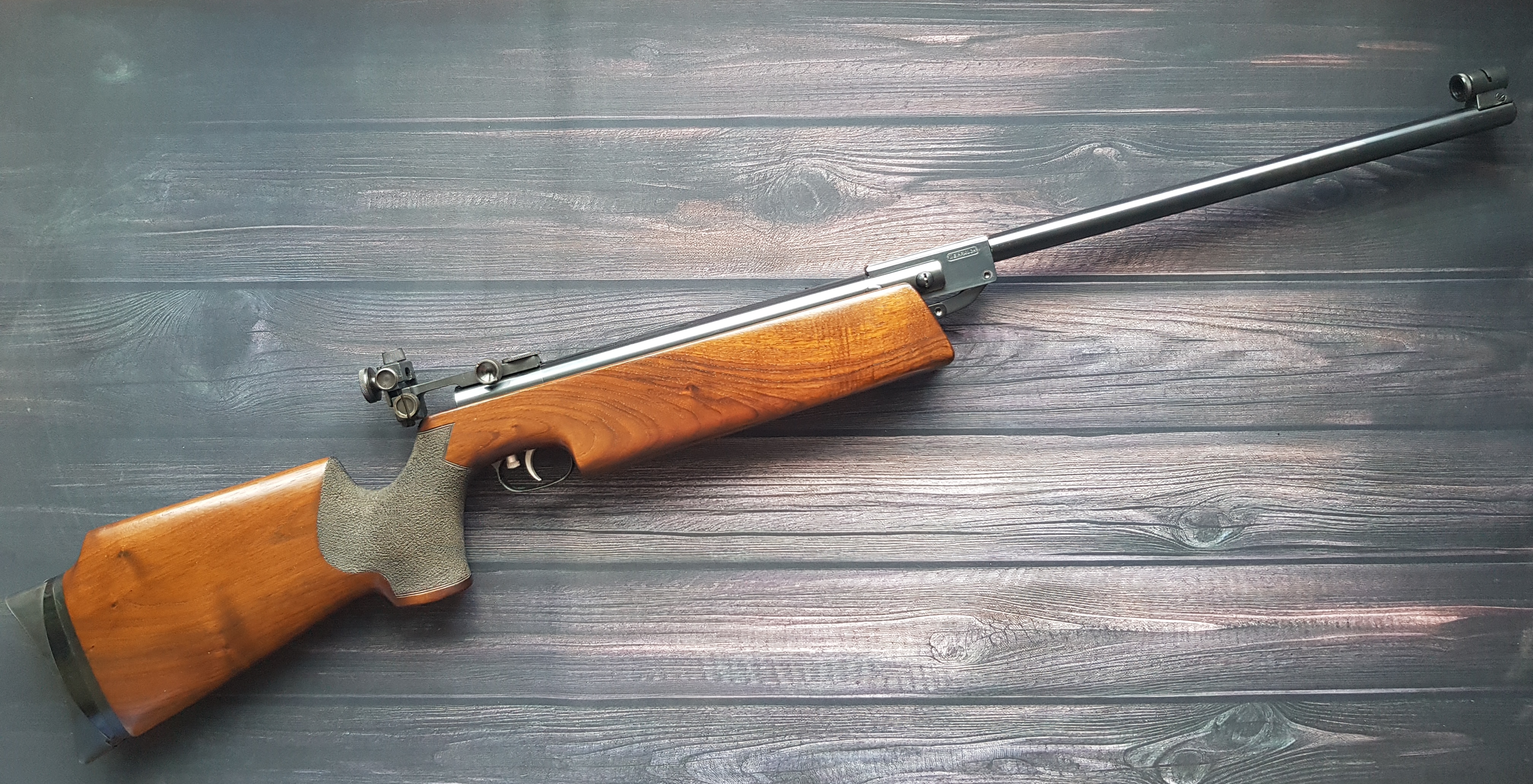

It’s one of the 55’s from hickory . The top one in picture
Definitely a bargain!
I really don't understand gunshop people. Listing a gun like that as a parts donor makes no sense: no wonder it remained unsold for so long. And if they'd spent 10 minutes to clean up the exterior, they could have doubled or tripled the asking price.
Can't say I felt like a thief, but considering the deal I was getting, I didn't bother to check the gun over in the shop: money on the counter, sign the receipt, gun in a slip, and have a nice afternoon!🖐️
Can't wait to shoot it, so hopefully I can strip it today to check and clean the internals - see if it has a synthetic seal.

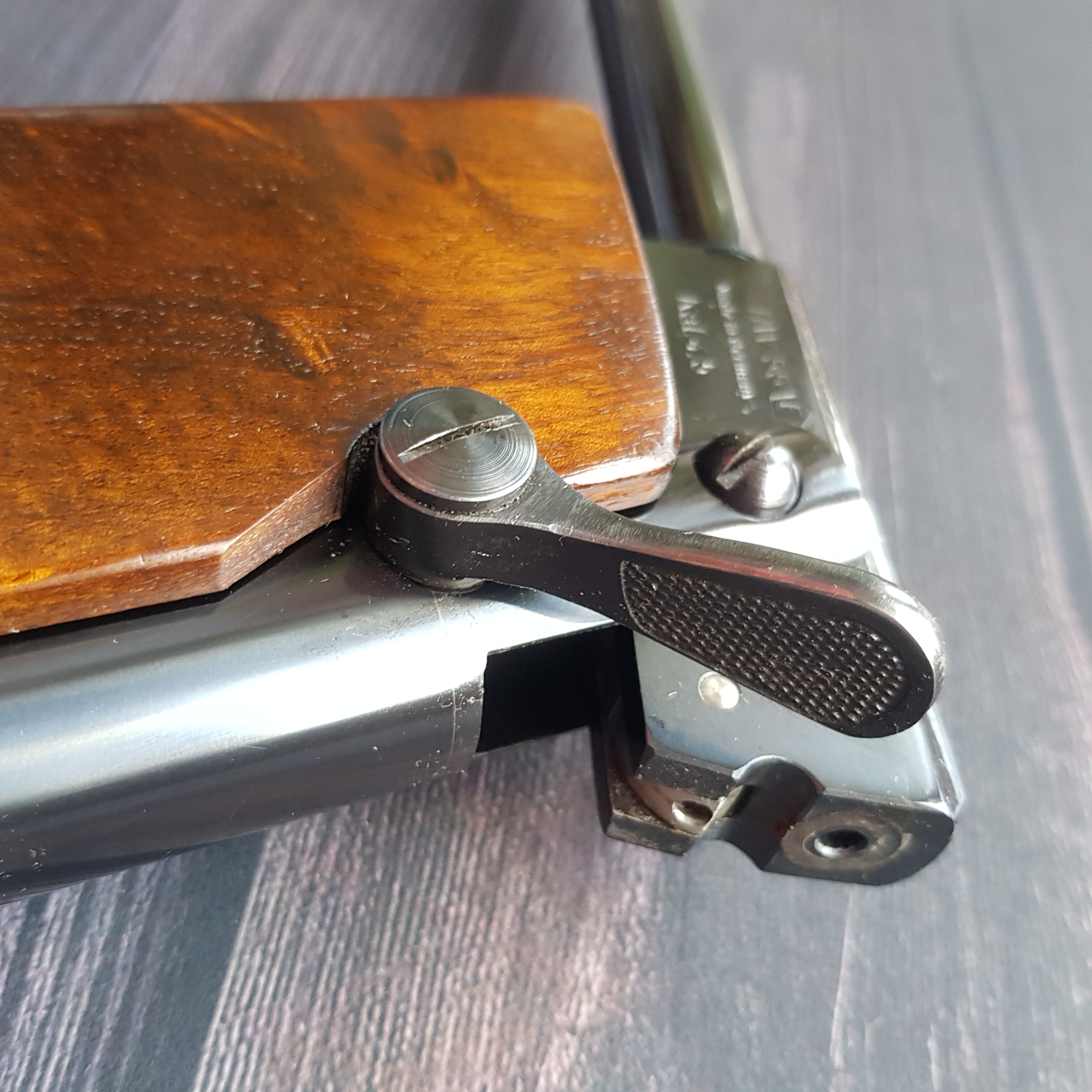

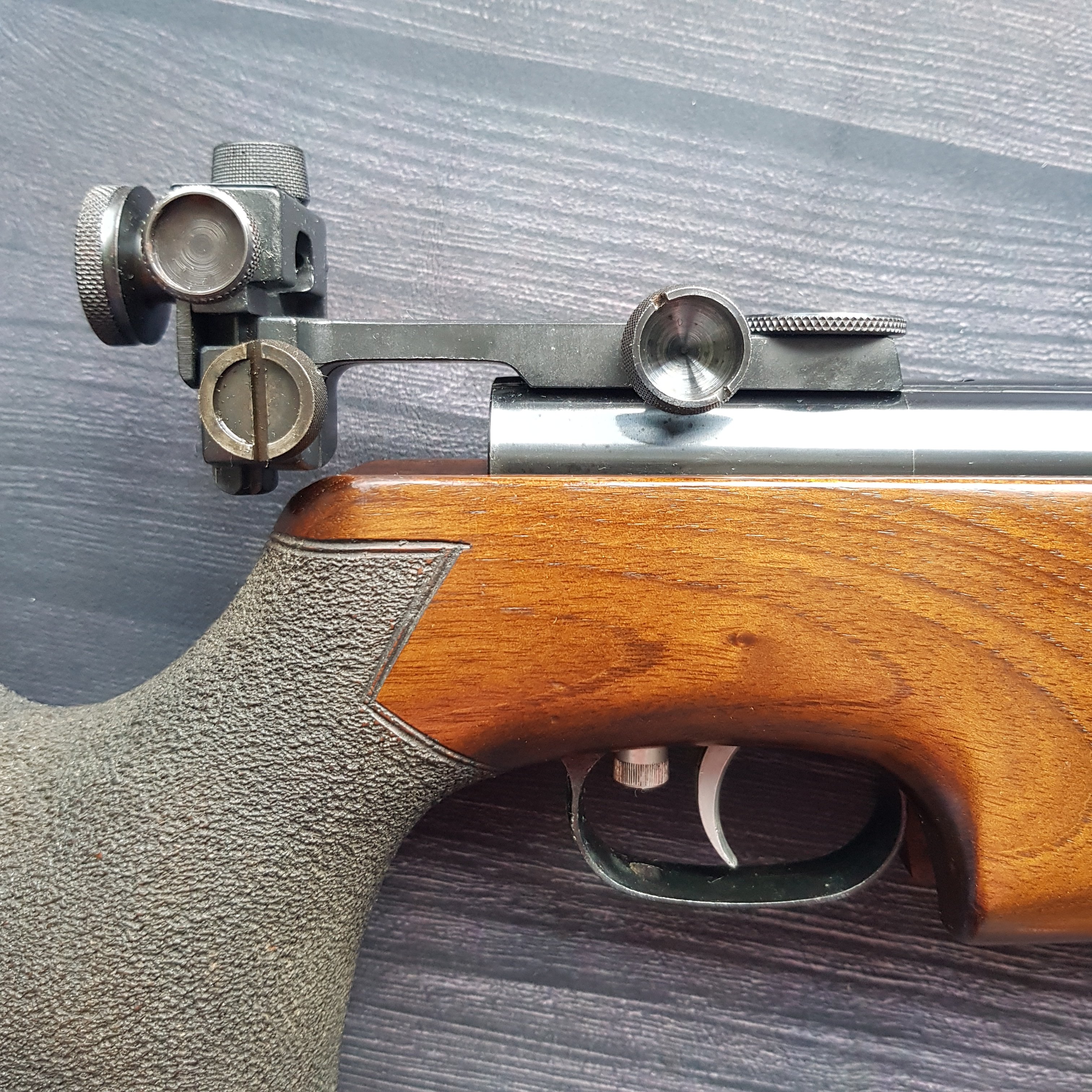

So far I have cleaned the exterior and it already looks good on the outside. Rubbed the stock down with 000 wire wool and my own "Tru-oil" concoction.

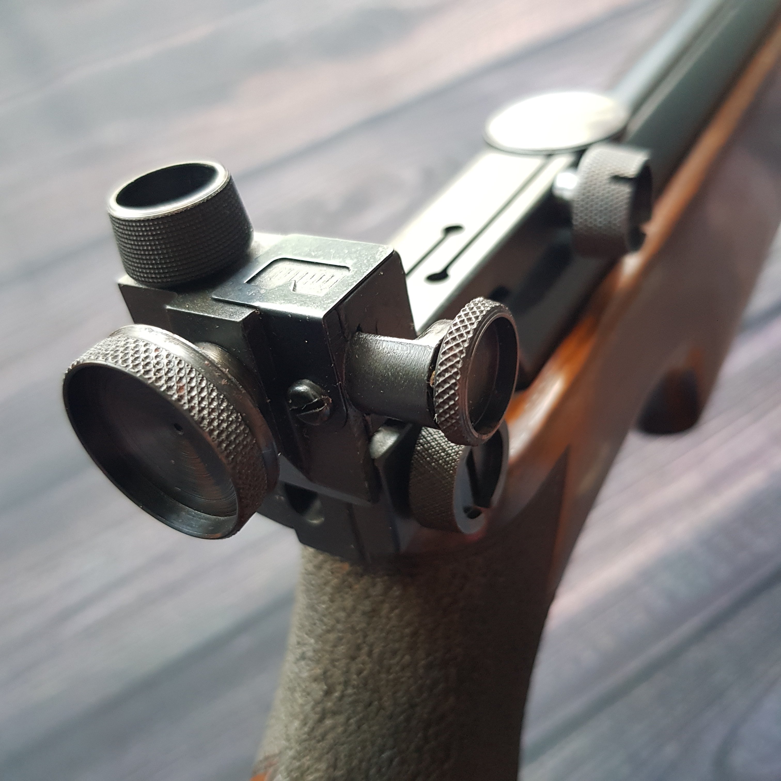

One of the diopter knobs still needs a bath in rust remover though. I stripped and removed the old dried-up grease from the diopter and that's turning smoothly now. Whoever owned it liked to "soot" the sights too.

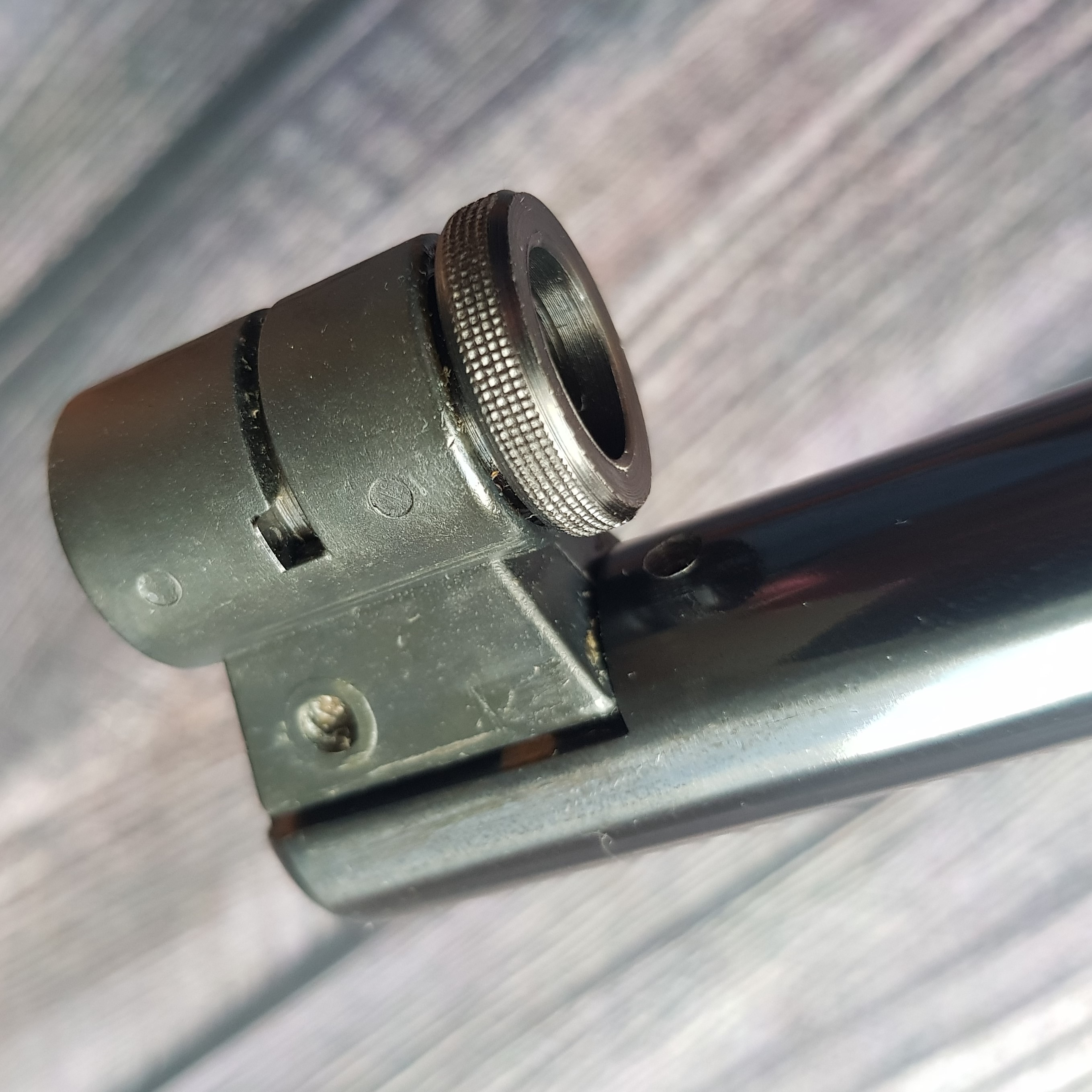

No idea what the glue on the foresight was for as the bolt does its job of holding it on the dovetail just fine. Peace of mind knowing that the end of your gun looks :poop: with glue spread over it, perhaps.
The general contempt that "real gun" guys have for our "BB guns" works in our favor sometimes!

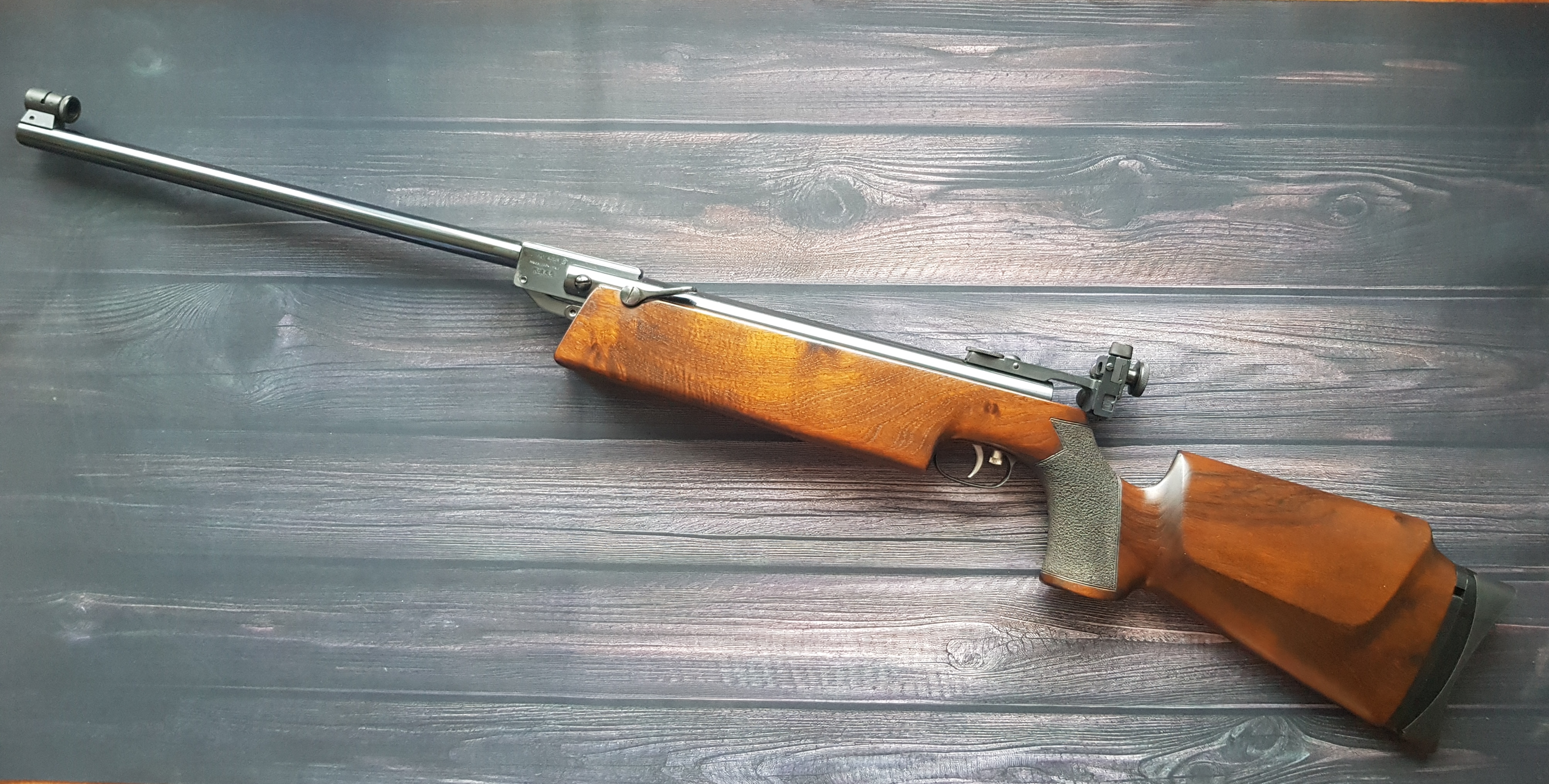

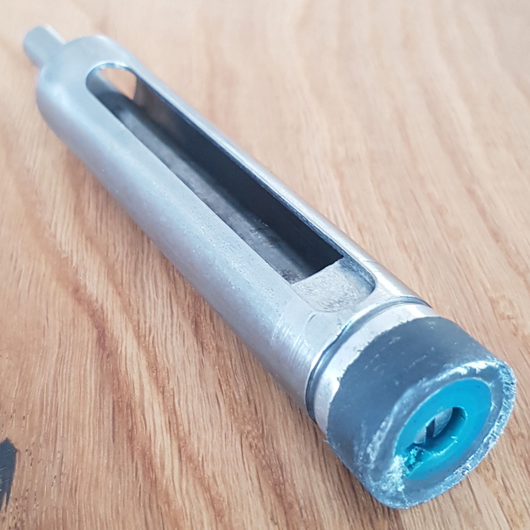

Yesterday I stripped the action down on the HW55 Custom. MikeD's comment about it potentially having a plastic piston seal, but me thinking "I hope it actually has a piston seal!". It did: plastic.
The piston and seal were caked in grease, whilst the spring was just lightly greased. I removed all the grease from the piston, spring and cylinder, gave the piston a polish, then reassembled with just a smear of moly on the piston high points and the spring.
Fired 4-5 shots to settle it down, then recorded 20 on the chrono. Average of 610fps with a high of 617 and low of 601 using Umarex Match wadcutters. Seems reasonably consistent considering the possible variability of the pellets. Trigger release is very nice and the shot cycle is smooth.
Pictures after the successful clean-up speak for themselves. Lovely gun!
Well, shoot...now I'm just jealous! What a beautiful rifle - I amazed the dealer was able to make it look so bad before. :oops:
I was wrong on the piston seal. That one is not plastic, it's a leather cup seal with a plastic filler in the center. It's done a bit differently than other HW 55's I have seen, very interesting.
The velocity is right on the money, that's exactly the speed the 55 was designed for. The receiver is shared with the old HW 50 of course, it can be stepped up closer to 700 FPS and still be quite pleasant to shoot.
Reactions: Swissair
Aha, leather piston seal: I will remember to oil it occasionally.
