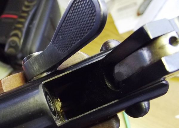

Lucky find! There is indeed a spring detent to hold the barrel up. Here is a photo-
The spring detent is the silver piece-it slides back and forth under spring pressure to latch the barrel against the rather small lug visible below the transfer port. Mine makes a definite click and does hold the barrel up on closing when the gun is cocked.

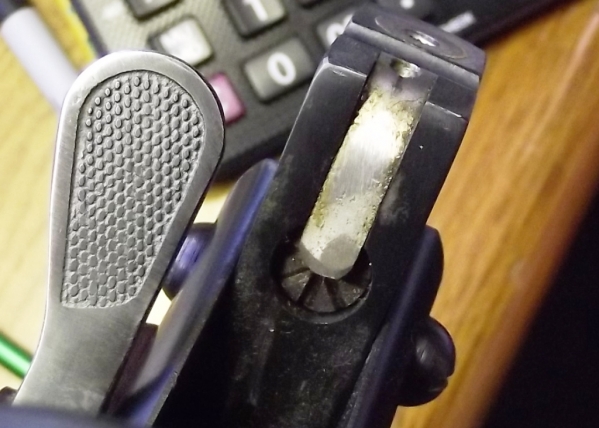

And a picture of the adjusting screw-
The screw is turned counterclockwise to tighten the lockup latch. From what I can observe the detent lug fits into the round hole in the silver bar and is sprung so that it moves back into the breech block as the silver bar passes over it, then springs back out into the round hole in the silver bar to hold the barrel up while the lever is latched. Hope that made sense!

The notes above are correct on how the little auto-latch works. The recess in the pivoting bar also serves as the seat for the auto latch.
The auto latch does wear over time. I have a couple of older 55’s where it works only barely or not at all. And even when working well, it doesn’t hold the barrel closed firmly enough to fire the gun. It’s just there as a convenience to help you out while you reach for the real lever.

I think you fixed this in your subsequent posts, but just to be clear the BIG silver piece does not move when the barrel is closed. It’s the little gizmo under the transfer port that is the sprung auto latch.
