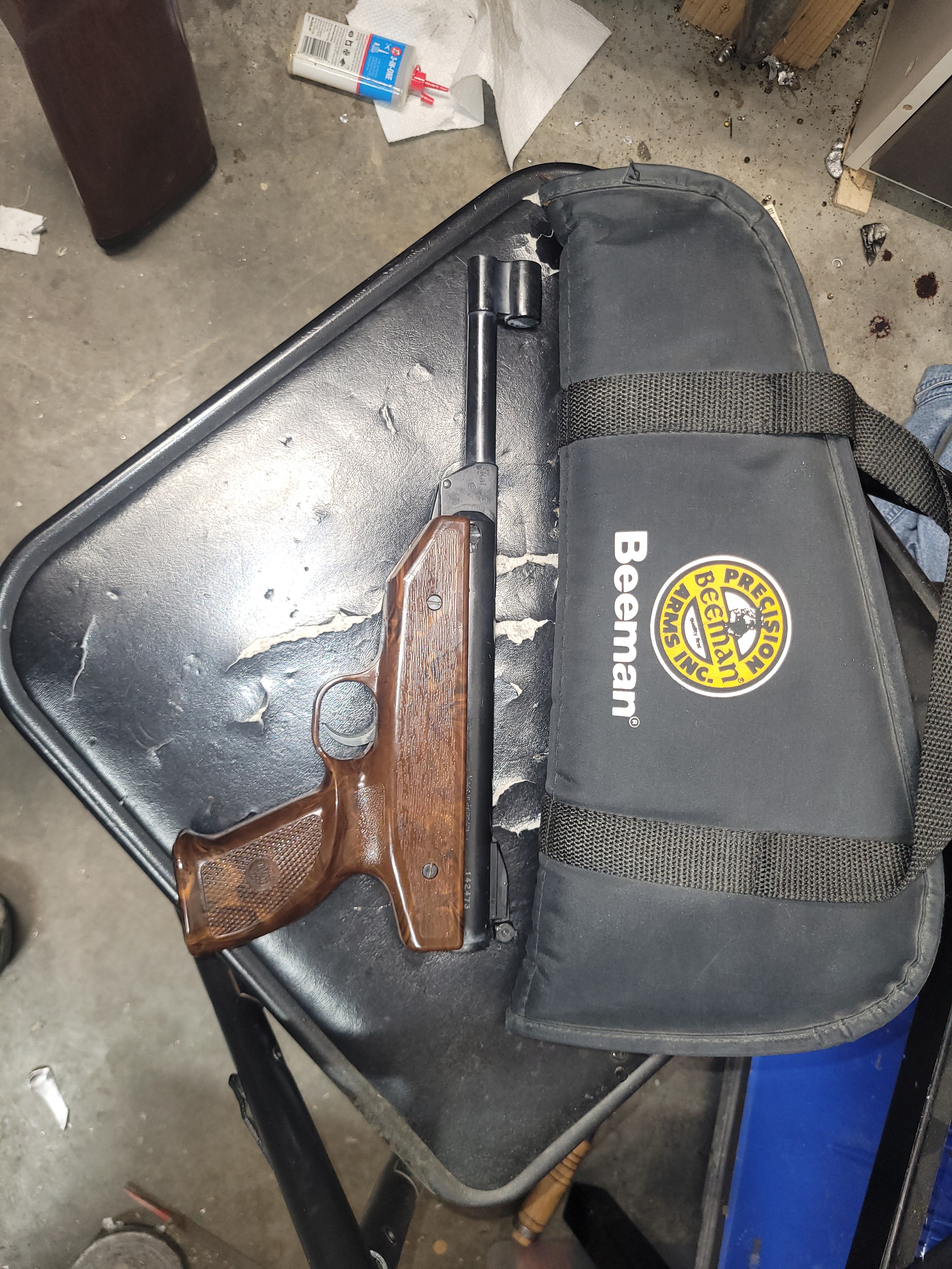

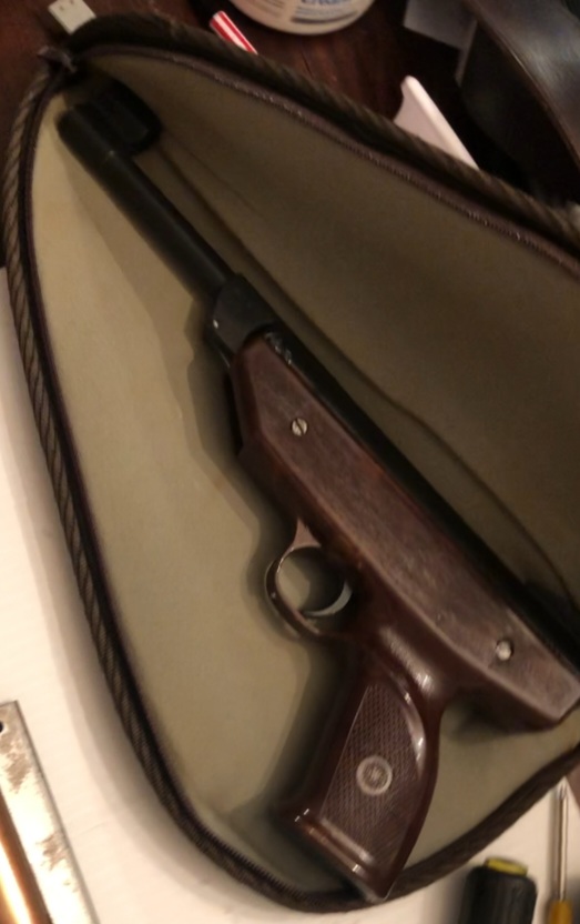

Beeman HW70/Beeman Early pre safety arrived
just arrived in an old Beeman soft case.
I shot it a bit and have orderd seals from Maccari as the breech one was soft and I figured might as well do a piston while I'm at it.
I shot about 20 shots and besides the breech end kinda "fat" and pellets needed a bit of a seat it's a nice little pistol.Trigger not what my HW75 is but so is life.
any advice working on these?

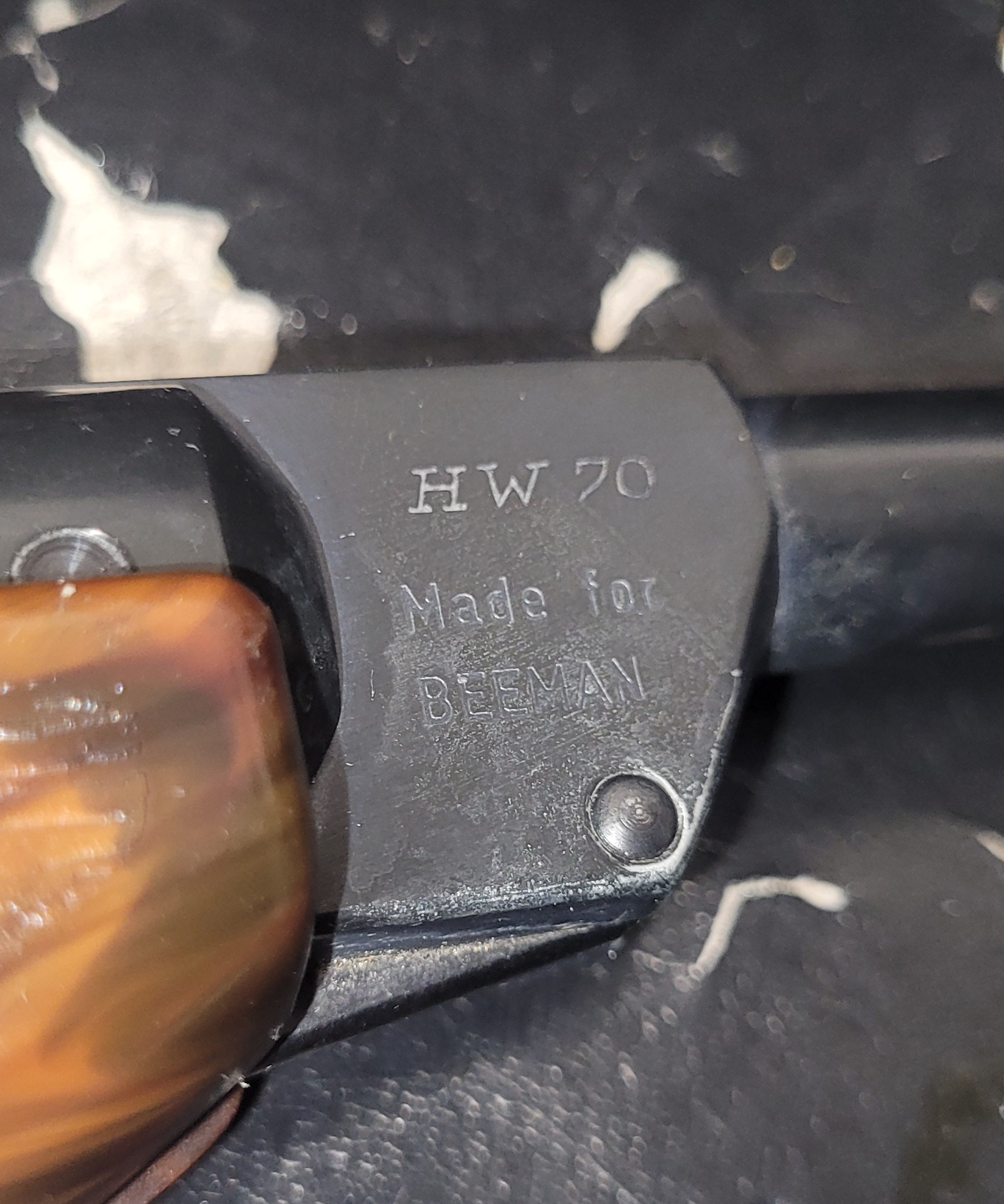

When did Beeman import these early ones?

92 you say? I would have sworn mine was purchased in the eighties.

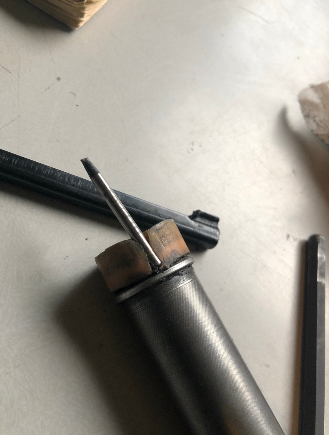

I've had mine damaged when "someone" thought it would be fun to shoot a Dremel bit from it. I repaired it without polishing the pump chamber. It lasted about ten tins before its performance fell off.
Now I have a new spring, and piston to install and I'll need to polish the scratched chamber this time. I hope I don't end up with a wall hanger.
To remove the plug I used a socket with eight pieces of solid copper wire taped to it. I constructed a spring compressor from things I had handy.
