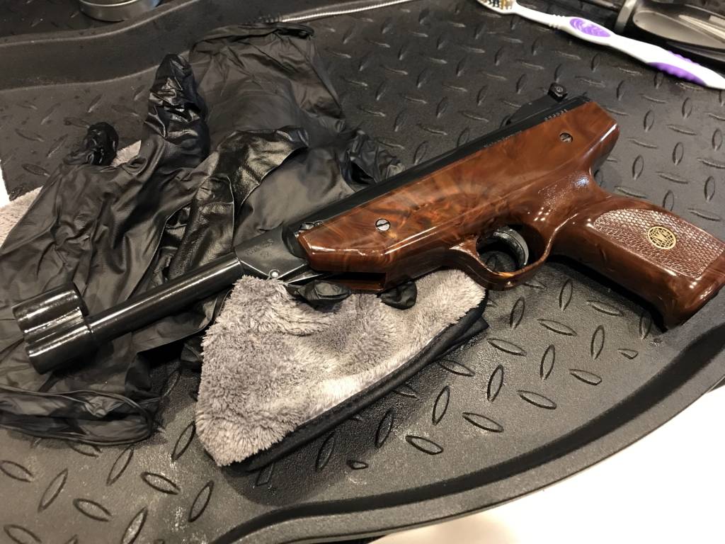

JUST got one of those (used, part of a lot) a couple days ago. Cleaning it up now for eBay or whatever. Thought I'd hunt around for info and landed here.
NICE gun, really pristine and well taken-care of. I'm the 2nd owner. It was born circa 1986.
Shot it a few times after nearly soaking it in some lube, cleaning, etc. Plus a few youtube videos to get more familiar. Appears to be the earlier edition, without the auto-safety.
I just have too many guns and if I don't use it, I sell/trade for something I will. More a rifle guy I guess. :)
Anyway, a quick snap of the little gem as it sits at the moment...
