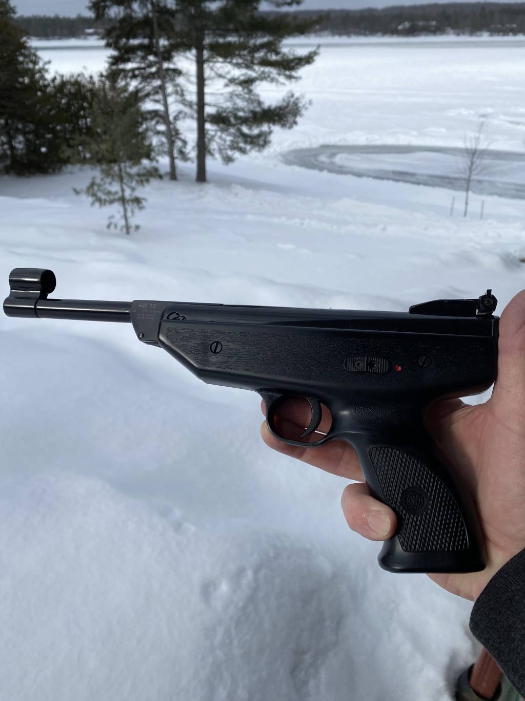

Finally
 got my HW70 out. Sweet pistol. Easy to cock, only one needed. Fun gun to shoot. Accurate.
My question… Can you work on these pistols, same as rifles?
Do they have spring kits for this gun?
Crow
Excellent pistol but no after sale tuning products.
In answer to your question can it be internally modified like an air rifle internals….sure….i've done one but only if you are skilled, you can however, get a smooth 460 fps with lighter pellets stock…I could have given you 490 fps if on UK soil…..but its still a good 50 fps up on a P2/P3/17 SSP stock.
Order your self a 3/8 inch nylon washer from RS and place it over the guide rod or down inside the piston with the mainspring on top.
It will take out rotational thrust from the mainspring and add a mild compression for about 15 fps…A steel one down inside the piston will add the same compression but also add a bit of weight for about 20 fps…Hold the Moly, its too tacky in pistols and slows them…use Superlube PTFE grease ..does not usually diesel in the lighter compressions of pistols and much more slippy …best i can do you if it doing it yourself….it will still out shoot a Tempest for fun..

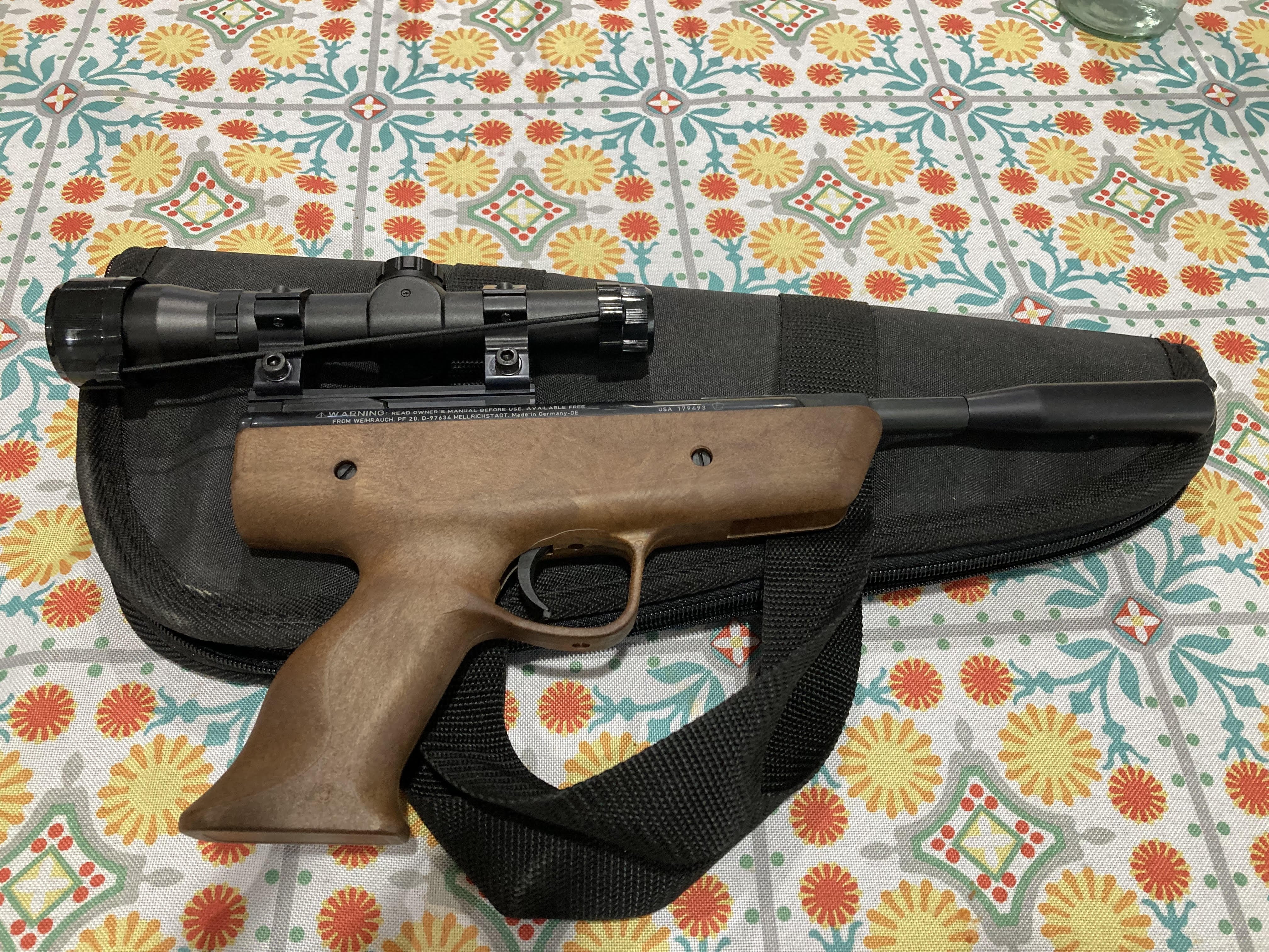

Sometimes you just get lucky. For a time AOA was selling the HW70A Black Arrow with the Weihrauch 2X20 scope together. I ordered and got the last one. Later, they had a new shipment of the pistols, but no scope or open sights. And the scopes are just over $150. It is a great package. AOA must have rethought selling the pistol with the scope included.
