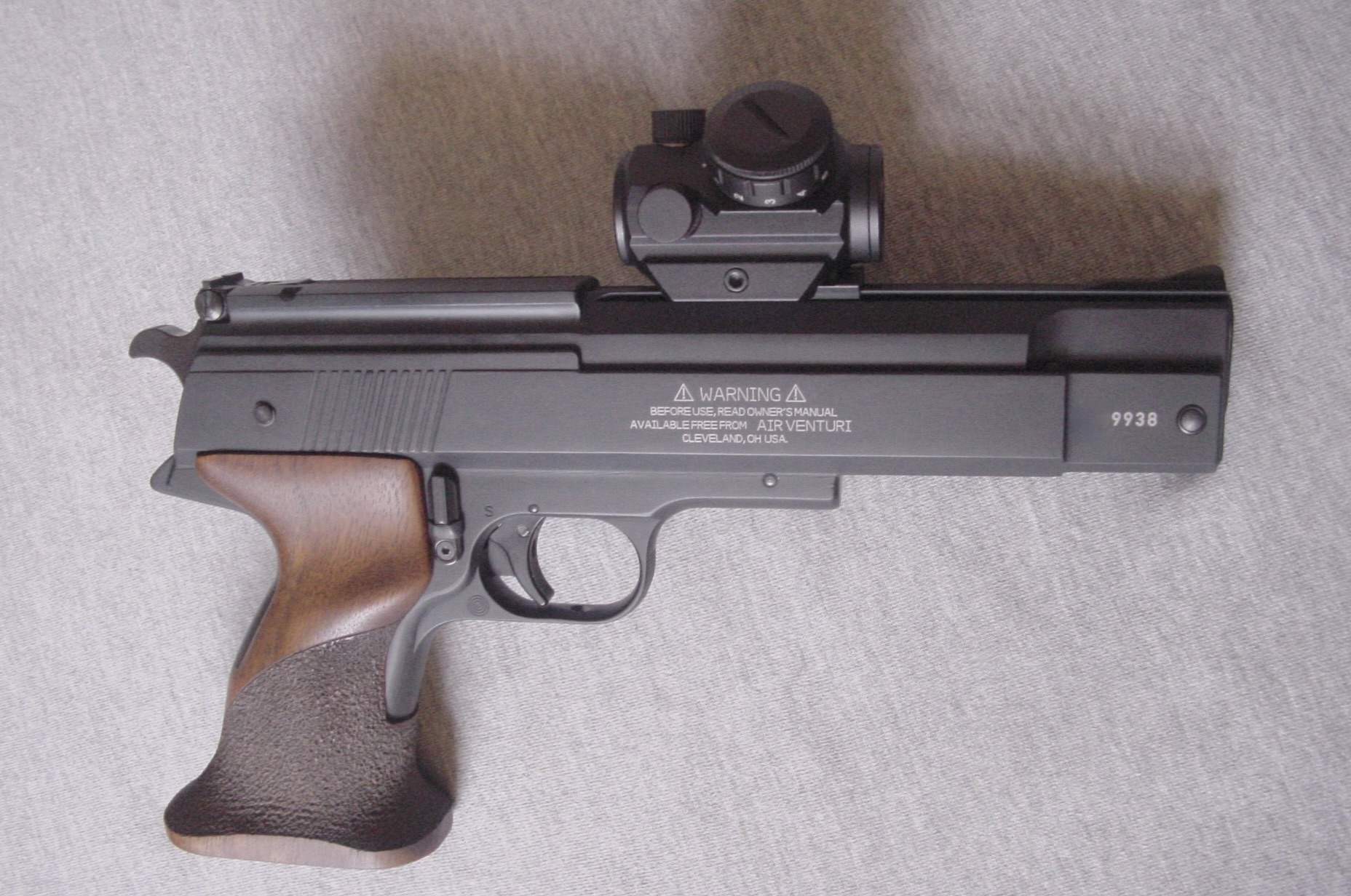

Eureka! I was able to find a 13 mm rail adapter for the HW75. A reflex dot could be in the HW75's future.
I don't know, it was an unmarked loose adapter I found in my parts drawer. I do know that the dovetail on the 75 is 14mm, not 13mm, meaning that many adapters just barely fit, or don't fit at all. This one just barely fit.
I used an eaglevision 13mm adapter and it was perfect.
