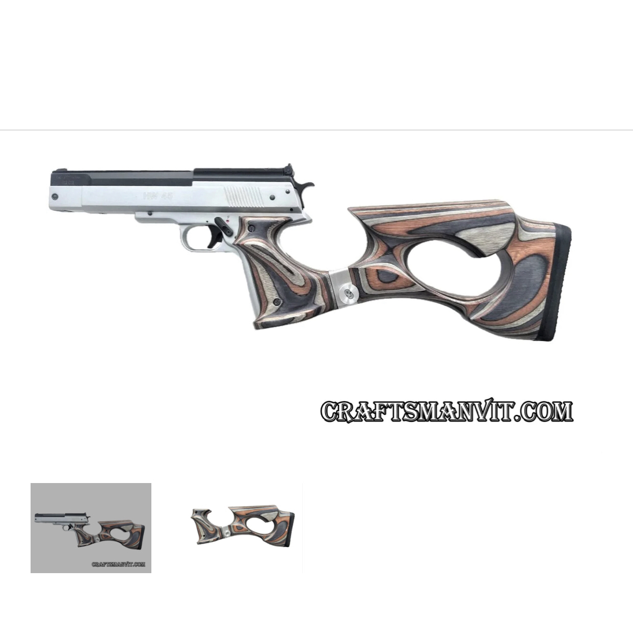

to shoot a HW45 with a shoulder stock you needed an optional 10mm front sight riser, i wonder why you would not need one for this also

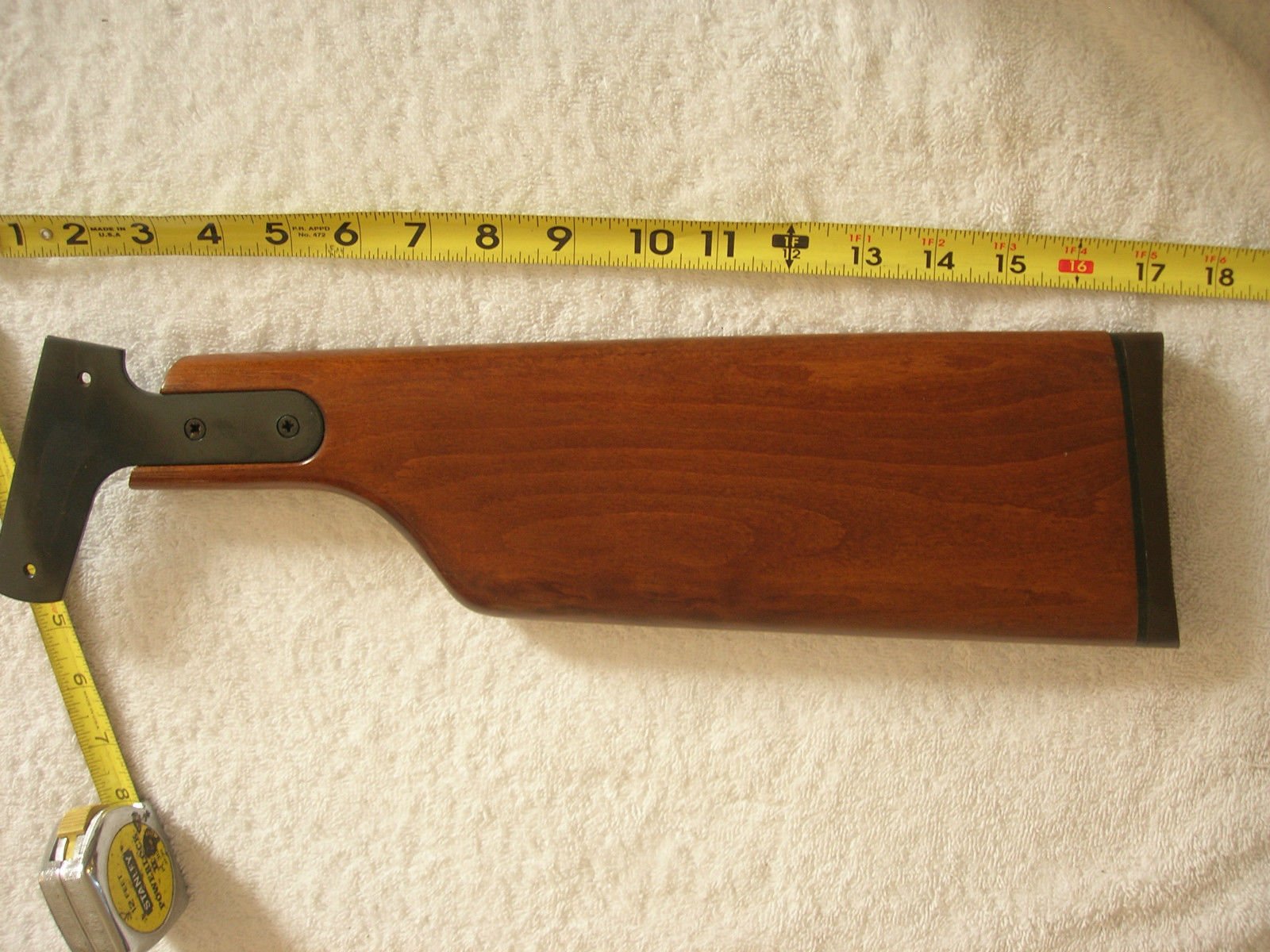

and one thing i have found is these stocks are way to short
oh they look COOL but if you are a big man good luck
so, how do i know, i got one of those that come out of Germany for my LP8, beautifully made way too short

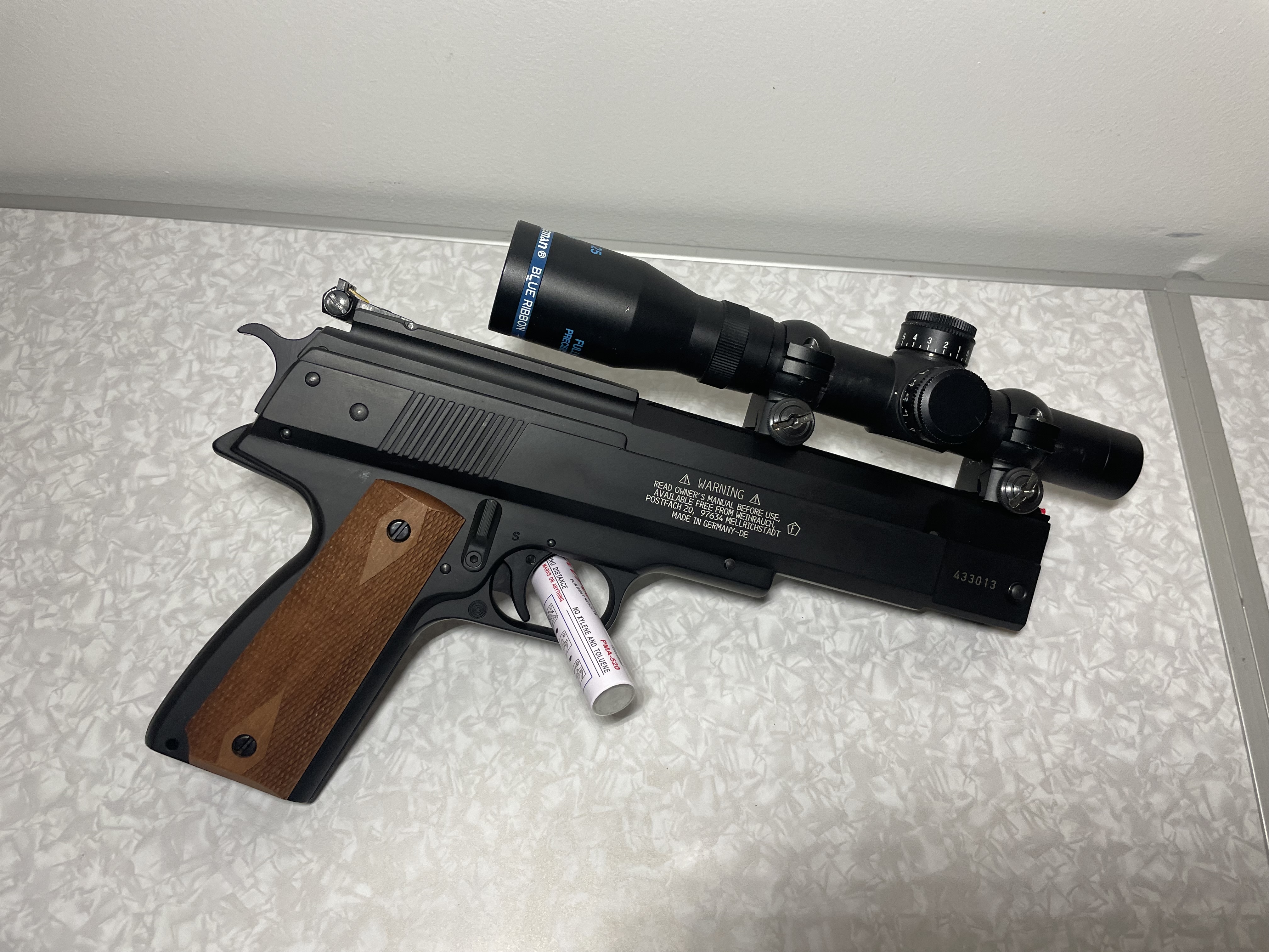

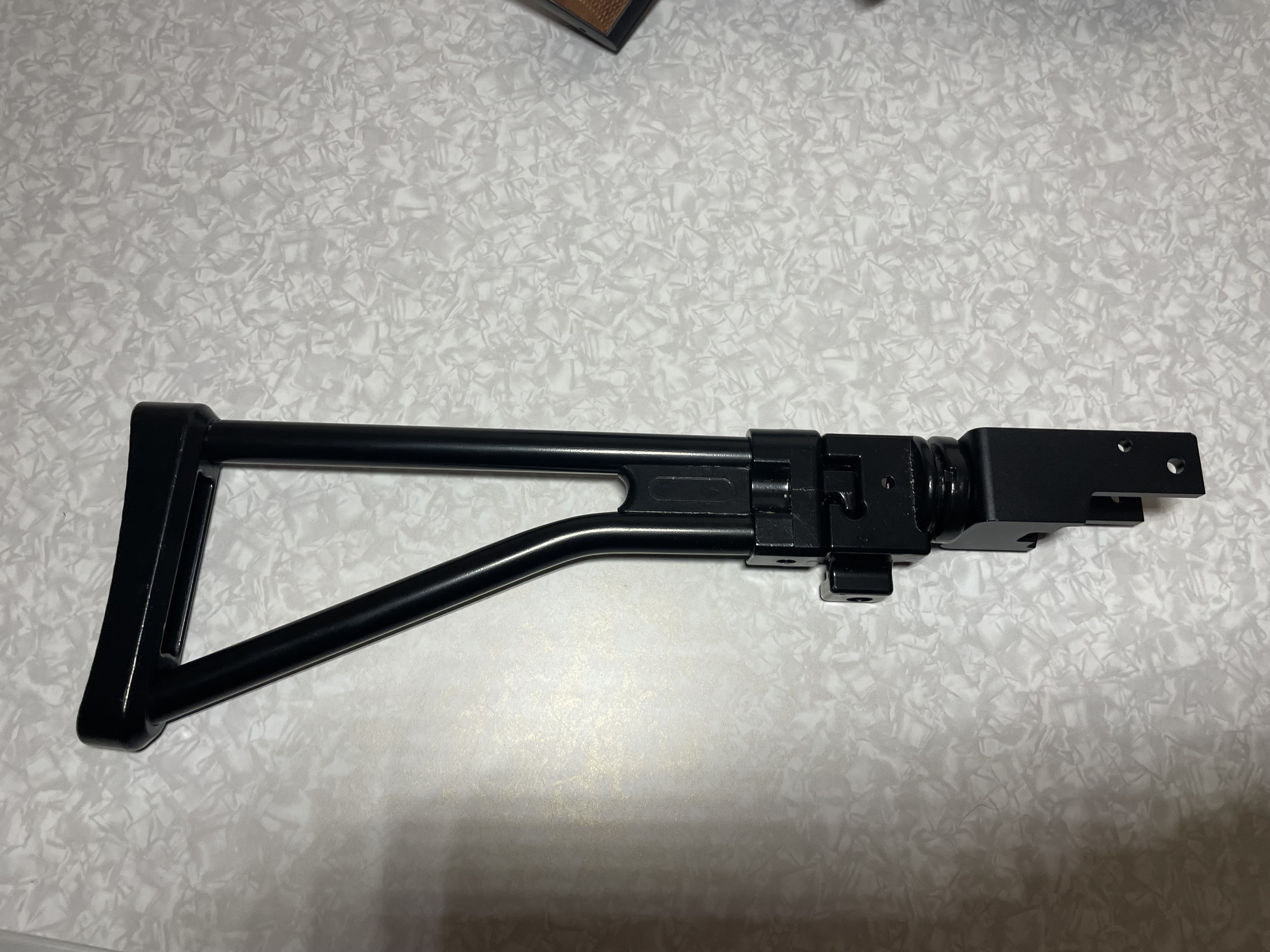

I have a shoulder Schulterstutze stock from Germany, ( currently not installed. ) it does work good with Blue ribbon model 25 Scope I have mounted. It’s easy to install there’s 2 screws to fasten it to the gun. The Stock folds also. I’m a big dude as well, & I have no issues shooting it in carbine rifle form.

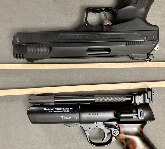

Spring-piston recoil happens in two opposite directions of course (the reason they are so tough on scopes). The first stage is equal-and-opposite reaction to the piston's movement; the second stage, just thousandths of a second later, is a snap in the opposite direction when the piston stops.
A one-hand gun like the HW 45 - with a "backwards" piston sitting above your hand - really exaggerates the effects of recoil. The first stage pushes the piston rearward and gun forward, which rocks the muzzle downward because your hand underneath acts as a fulcrum. The second stage snaps the gun backwards. It all happens so fast you only notice the second stage - but the pellet exits during the first stage.
To put it another way...when you pull the trigger on an HW 45, you are really aiming above the target! The sight setting has to compensate for the muzzle drop. Easy to see why these guns are hard to shoot well - a consistent hold is extremely important.
Here's a lame illustration - both these pistols are sighted in for 10 meters. On the recoilless P17, the sight line is almost parallel to the bore. On the snappy backwards-sprung Tempest, not even close - if it had a stock restraining recoil movement, it too would need a taller front sight.

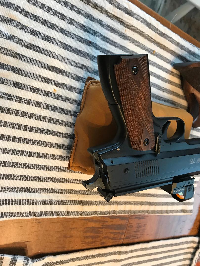

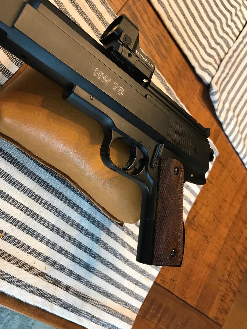

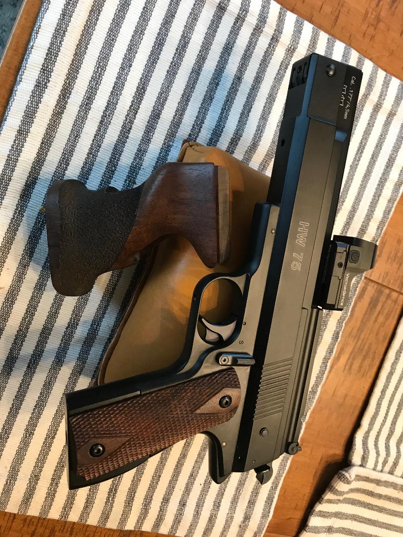

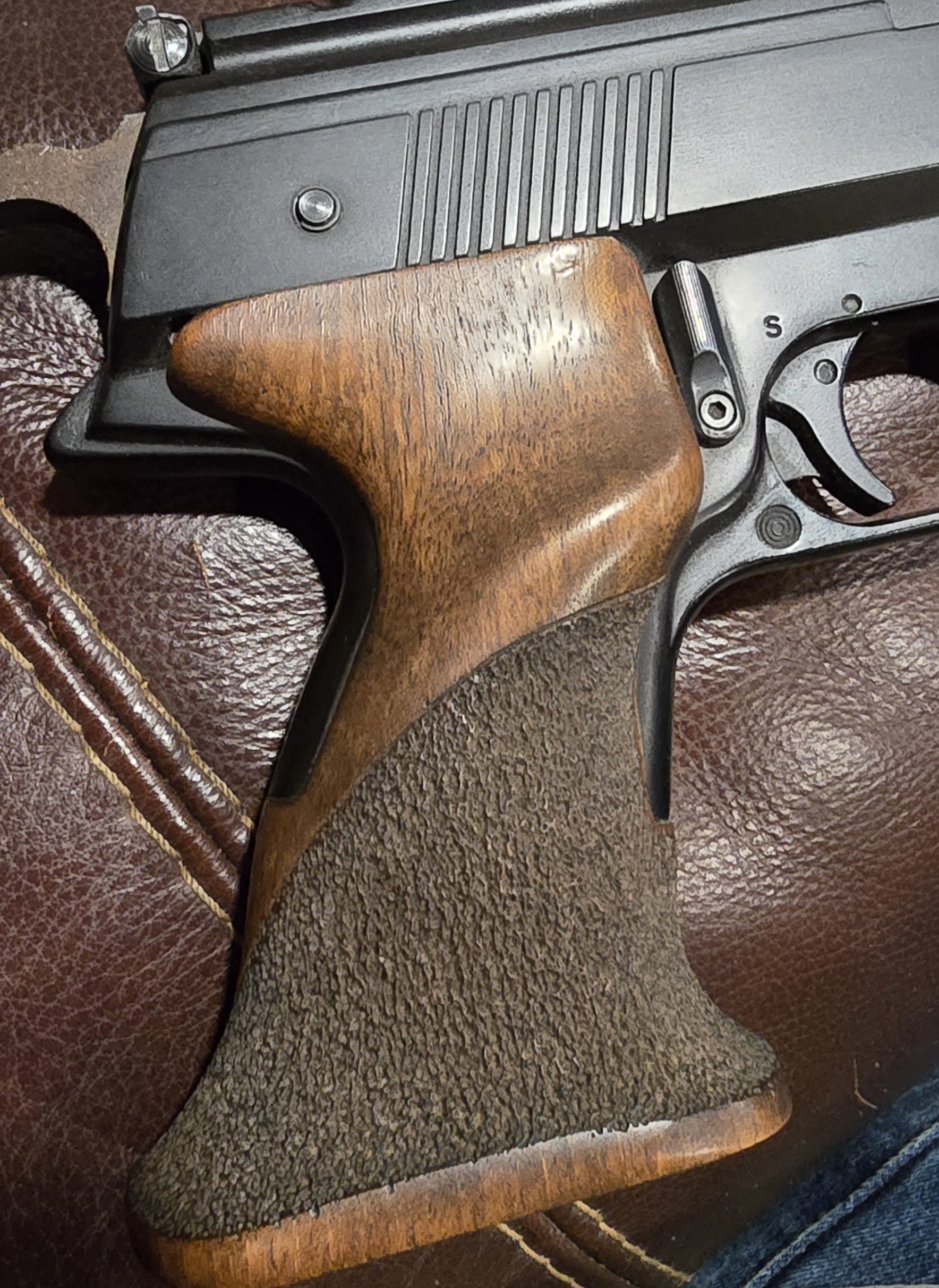

It uses a different grip configuration than the 45. The pistol grip frame is cut short and the stock fits around it. The HW45 takes 1911 grips.
See the photo to see where the frame stops.
I think fitting a HW45 shoulder stock to a 75 would take some engineering. 👍
A one-hand gun like the HW 45 - with a "backwards" piston sitting above your hand - really exaggerates the effects of recoil. The first stage pushes the piston rearward and gun forward, rocking the muzzle downward; your hand underneath acts as a fulcrum. The second stage snaps the gun backwards. It all happens so fast you only notice the second stage - but the pellet exits during the first stage.

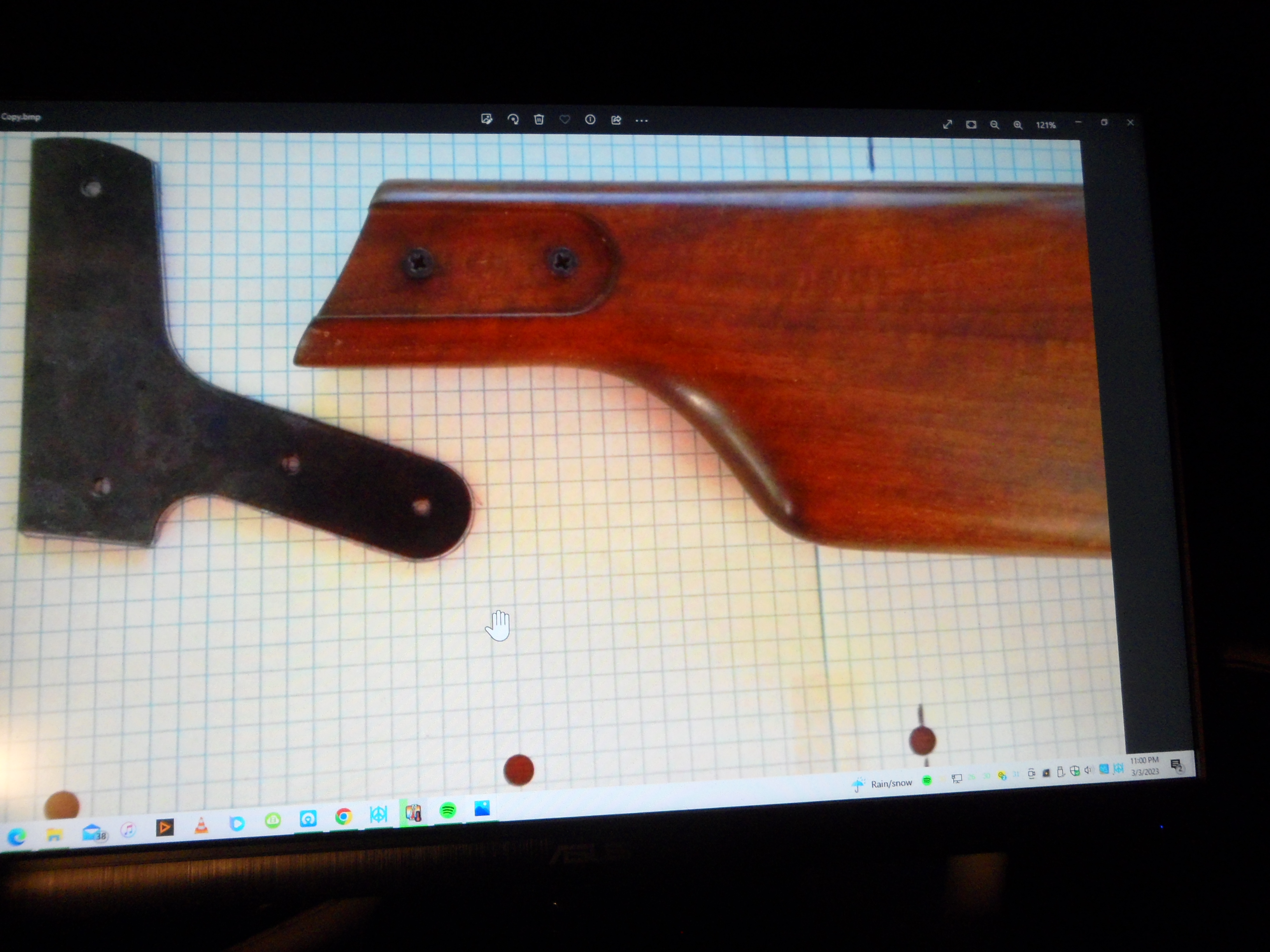

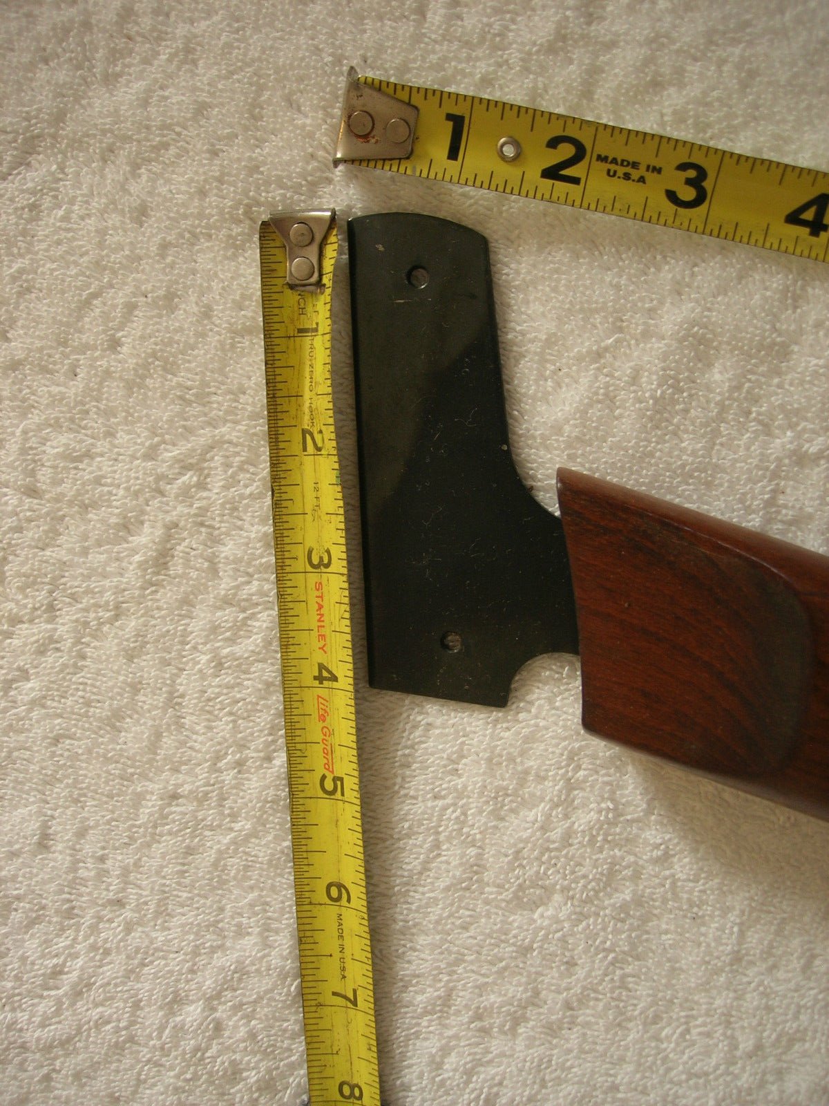

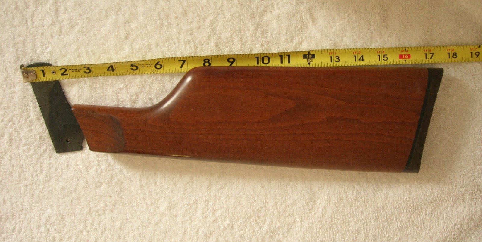

The HW 75 was originally released as the "Beeman P2" in the US. Early ones had the full grip frame so would work fine with the Beeman P1 stock. And there are various newer stock designs out there which are designed for the cut-down frame now used on the 45 and 75.
A note on the original P1 stock - Beeman recommended attaching it with the gun's grip screws, but those are too short for a secure hold in the soft alloy frame. I highly recommend finding some longer screws.
