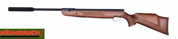

As mentioned above great looking version Luxus Stock and Silencer...
1541807133_647186995be61c1d6aa899.51805748_292314-weihrauch-hw-95-luxus-s-optikou-4-16x-a-dals...jpg

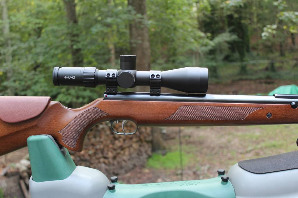

I have no knowledge of the HW80. My wife and I are in our 80s and we both enjoy shooting our new HW95L from our back deck. I upgraded the scope to a Hawke 4x16 44 mm SF IR model and my wife really likes the IR feature of the scope. We use the small targets that indicate where your pellet hits and are able to shoot 2" groups at 25 yards some times. This rifle from AoA is a fine German built air rifle which is beautiful and a joy to shoot. I take the occasional squirrel but my wife won't shoot one. I used the Hawke 30 mm Medium rings to mount the scope which leaves less than 1/8" clearance for the objective lens. This scope has 6 brightness settings along with the side focus and I believe that it is an excellent scope.
