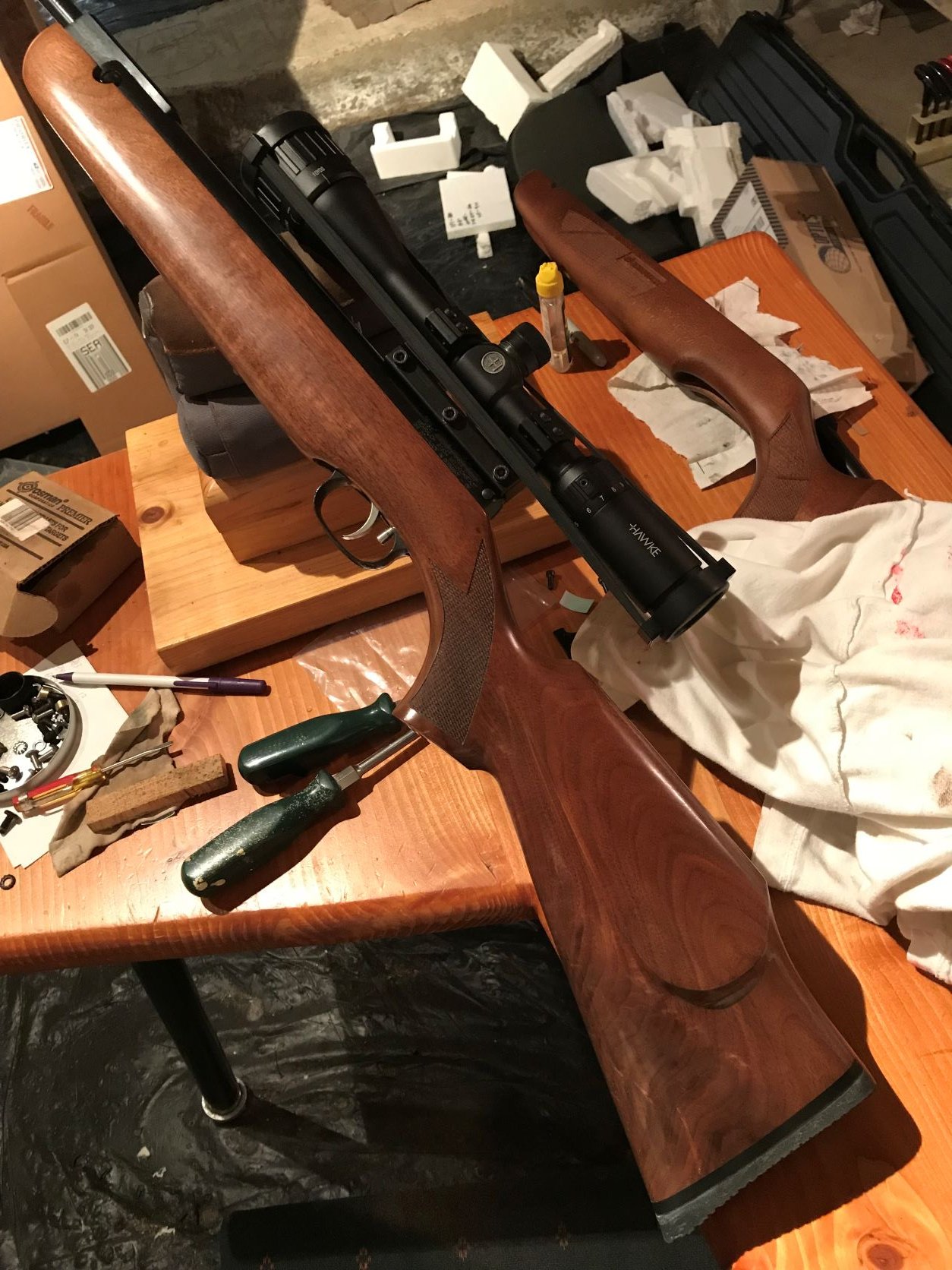

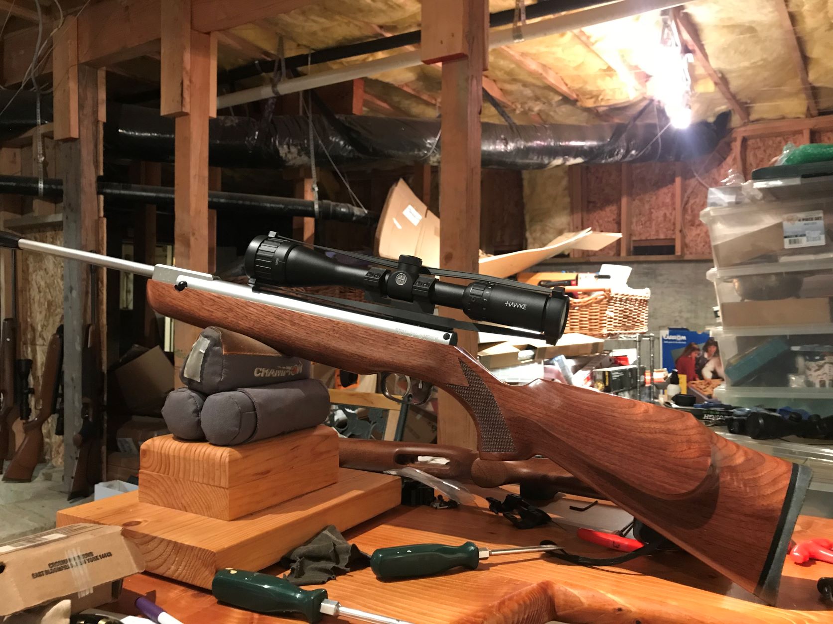

Hi Spiral, no worries i asked myself the same question when i bought it. I have an FT stock for my HW90 which will fit an HW80 with minimal tweaking. I have a HW50 and have soft tuned it, but it's still hard to cock and only puts out 8fpe. I also have a 97 which is set up for FT, but i find it to be too front heavy which is why i'm playing around with break barrels. I enjoy the tuning as much as the shooting, so it's really just a project rifle.

How's the cocking effort? Mine was 12fpe out of the box, but very boingy and not fun too shoot. I've got a PG4 kit in it now, but had to cut lots of coils to get the cocking effort down to reasonable, which left me with 8fpe. Still a nice shooter and i even made an FT stock for it. I originally bought it for my dad to shoot FT with but it's probably the rifle i reach for the most often at the moment.
