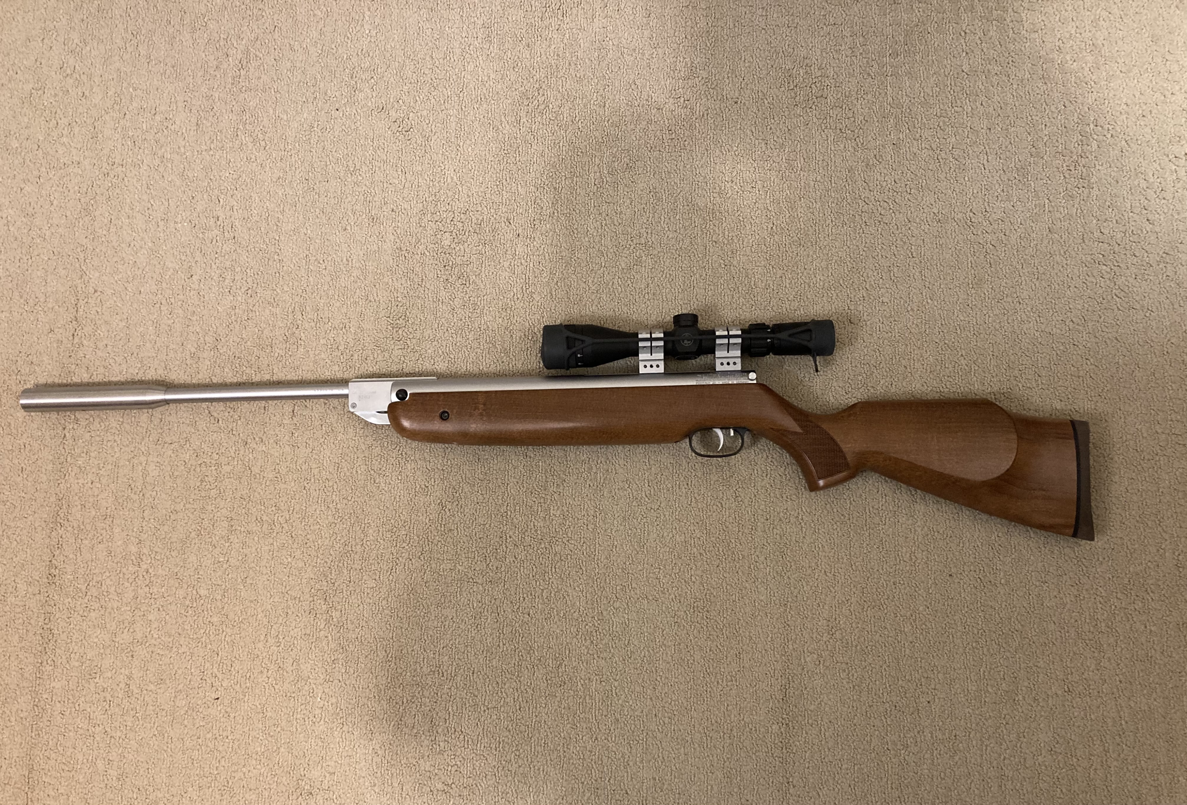

My R1 carbine is .20 Santa Rosa vintage and has never been apart. The Piston seal is shot and fails a vacuum/pressure test. In spite of that it puts out 14.9 ftlbs. An 80k in .20 I bought new was just around 16.5 ftlb. Out of the box.

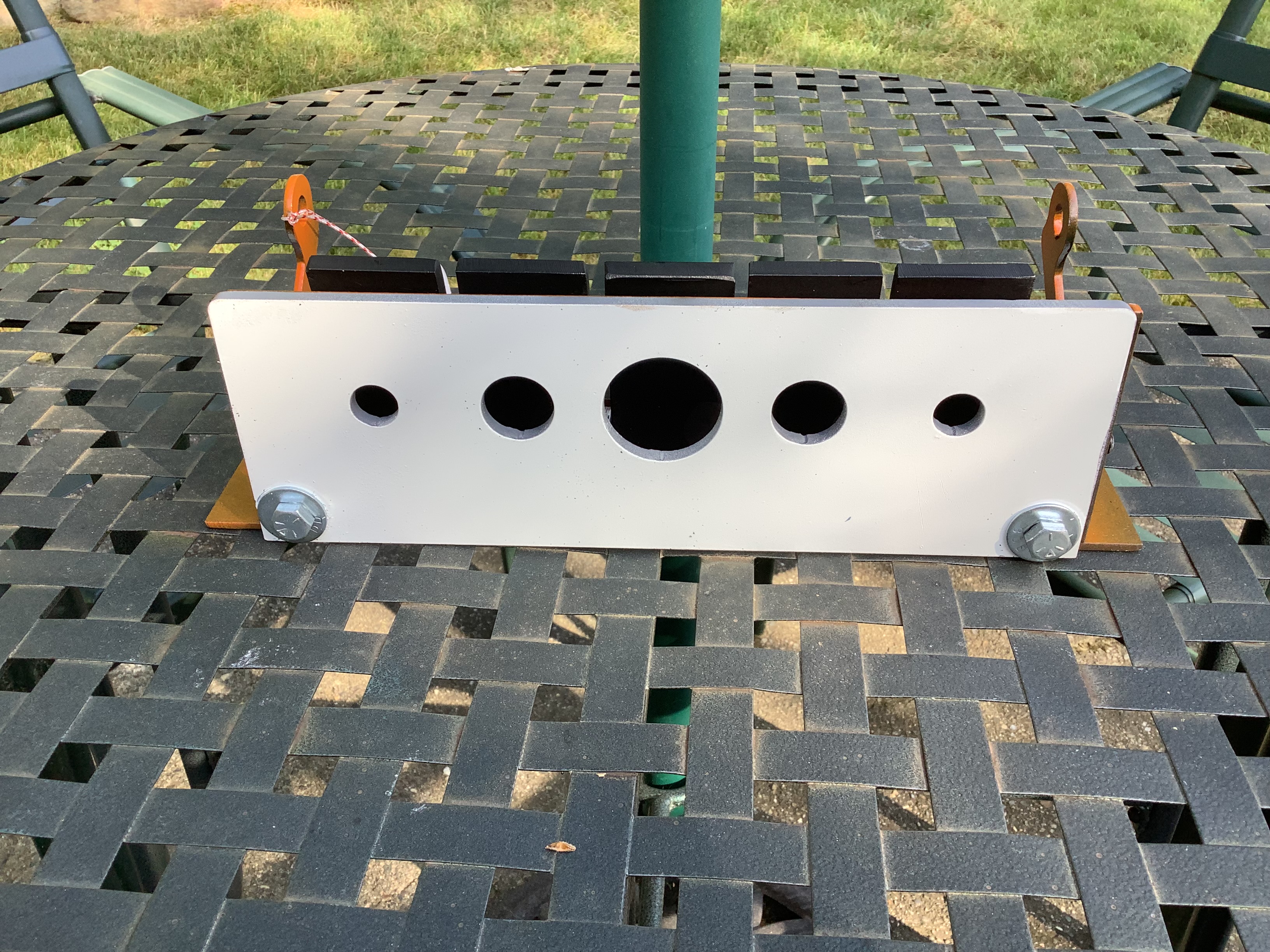

I have an HW80K in .25. It shoots right at 16.4 ftlbs and is the smoothest of this platform I have ever shot. It is laser accurate at 25 yards easily putting every H&N FTT through the 15mm holes on my RX target. Nothing but net!
