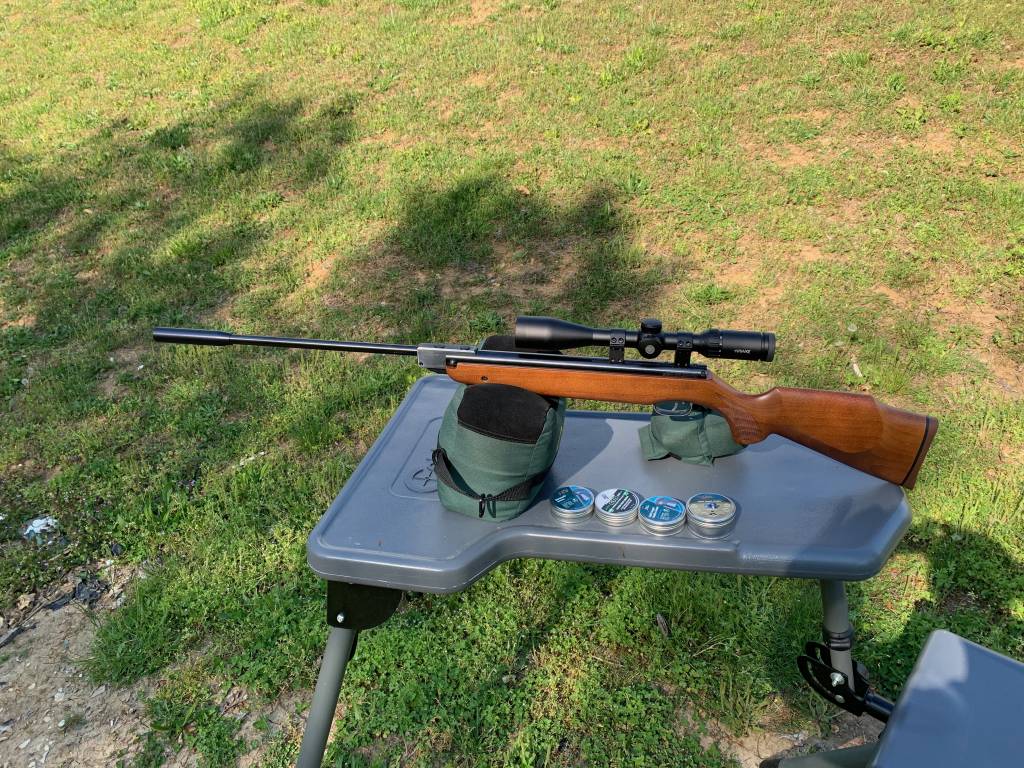

There is no doubt if you have an HW50 you'll be in the "middle gun" range that can do MORE than expected.
I shot a running squirrel along our fenceline at 25 yards (on the run with a scope!) and whacked him off the fence into the neighbor's yard who was happy to "get rid of the pests" as I was.
Deal is though; try out the HW50 in the .20 and use regular weight pellets (JSB Exact) to really see what the HW50 model is capable of doing TODAY! It is an historic achievement and I BOUGHT TWO!

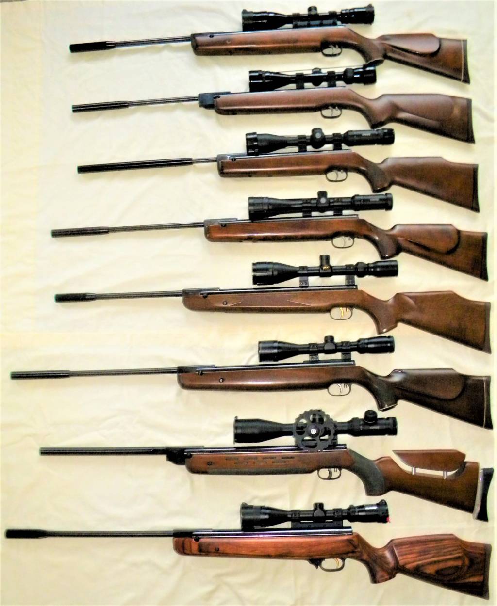

The R10 is the same as the HW85, it's just in between the R9/HW95 and the R1/HW80. Krale may have them for sale, they are made different now then they were years ago. The old ones had a screw on rear cap like the R1 and a separate raised scope rail.
Here is my Beeman R series for comparisons; R1, 6, 7, 8, 9, 10, 11 & RX2
Appears to have a thicker compression tube with the dovetails cut into it now instead of the old screwed on base that had it's roots in the BSF 55. Ask me all springers should have screw on bases. You should be able to choose your own bases like powder burners. 11mm dovetails are intended for low recoil .22RF. Barely adequate for springers.
