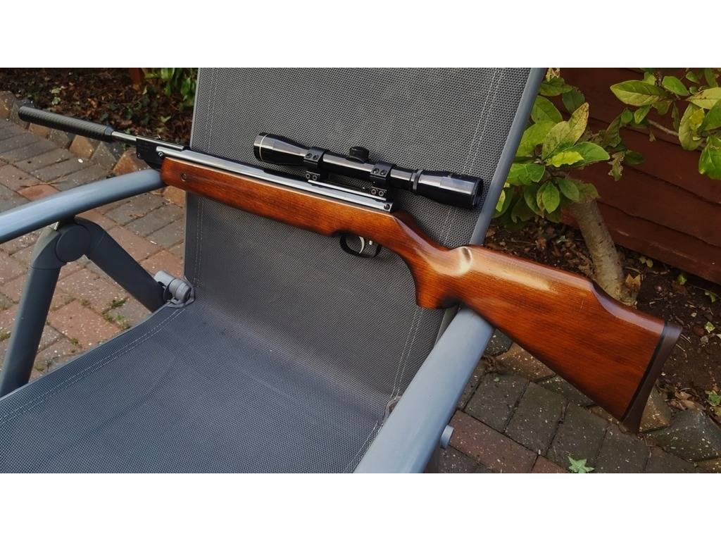

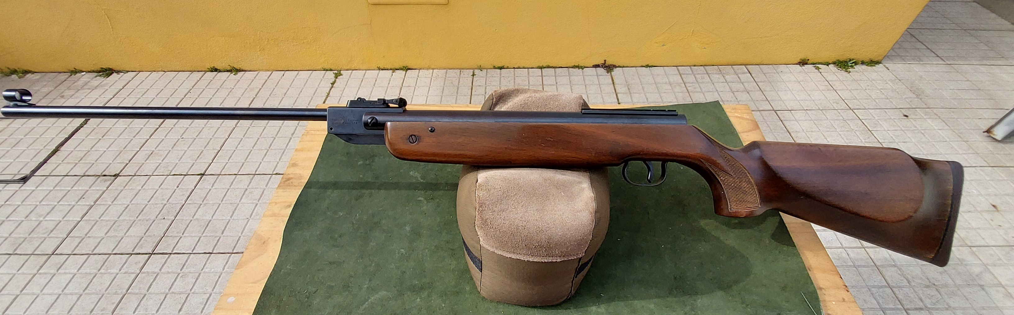

This is my 20+ year old Russ Best tuned HW-85 in .22cal, absolutely love it, feed it H&N Field Target Specials and Barracudas.
Sorry Dude i dont think that is a Mark 1 HW85 they had no rails in the comp tube
They had a seperate mounting block that slotted into the Cylinder as it was to thin walled to machine into
it also has the screw in back block as per the 80 yours is a later version
Enclosed is a pic of a 1986 Mk1with the scope block shown it was one of the first to be imported to the UK
It is 38 years old
Yours does look very nice though i must say but the Original is getting quite rare

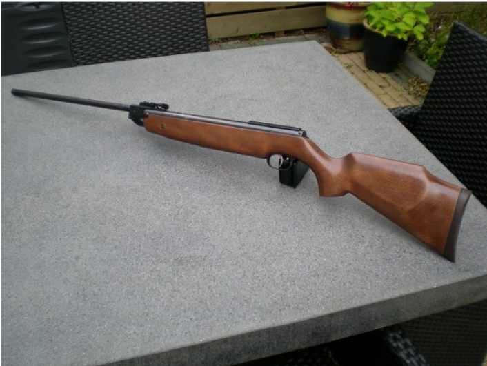

The old 85s were the same as an R10 they were thin walled compression tube with an additional scope rail attached on top. Later models were the same as the current 95 with a longer barrel.

I agree. I now have 2 85’s. Current models. Would love an older model. Crow

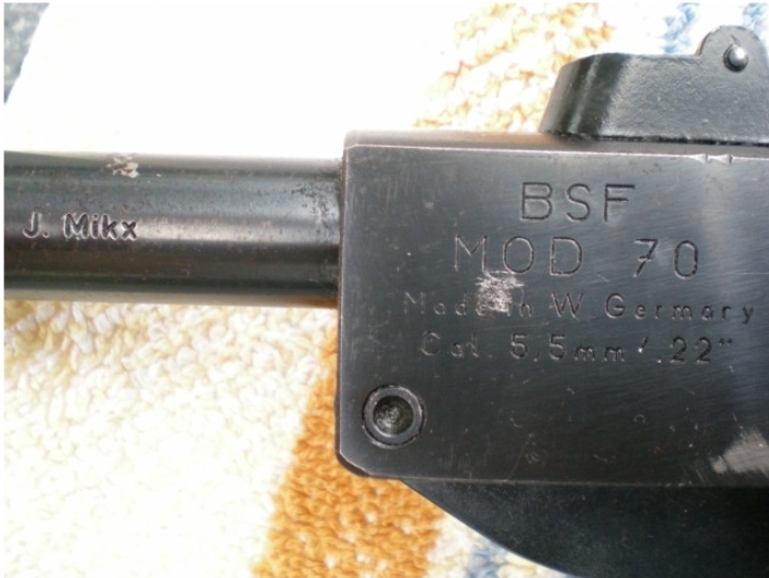

Have you owned or shot the bsf/hw hybrids? I have a marksman 55,70, 58s. They are all basically hw85's with bsf sights on them and different stocks. Some had the old "perfekt" trigger, later ones have the "rekord" trigger. All of mine are rekord trigger versions, and I absolutely love them! I also have a san Rafael era r10 deluxe in .20....lefty! It is my understanding that the only reason The r9 was created is because the r10 was far more expensive to manufacture. So when I think r9, I think "cheaper made r10"

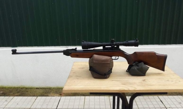

San Rafael R 10 20 cal Carbine. I rebuilt this couple years ago with a Maccari spring and Vortek seal. Made Delrin spring guide and top hat. Lubed with Krytox 205.
This is really a nice rifle. It is light and powerful. I'm getting around 800 fps with (Field Target)? ammo.

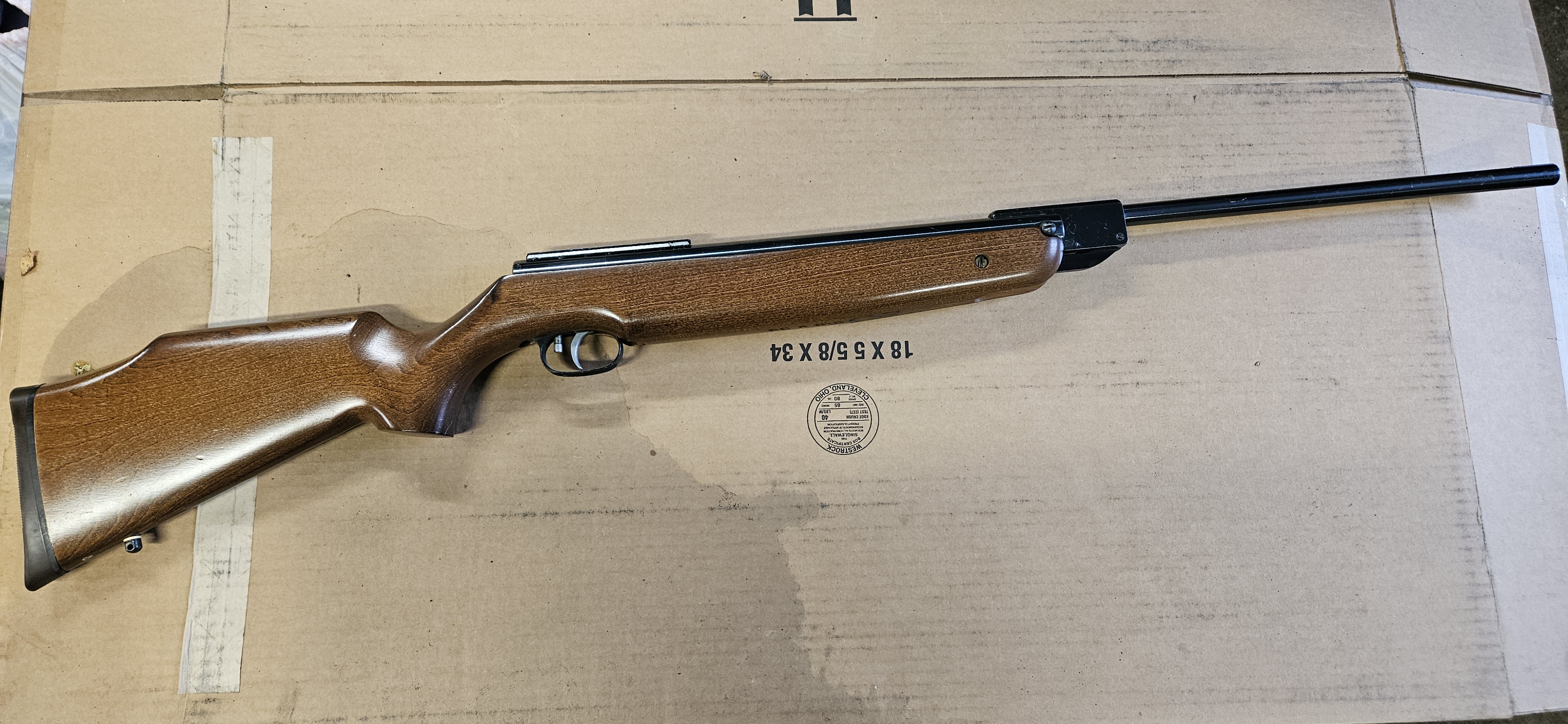

Very nice! I have the same stock style on my R10 (HW85). These old R10’s shoot great when rebuilt with correctly fitted guides/springs. Mine has a Maccari kit and his “Accuglide” piston seal. These were made of some sort of seemingly indestructible material with a flat piston head. I can’t imagine a gun that shoots at this velocity being any smoother. I wish I would have stocked up an a few more of these piston seals which are unfortunately no longer made.
As a side note, I’m not sure why HW recycles their model names (ie the old HW 50 is not the same as the new HW 50) which will forever confuse people as to which one is being referred to.
The old HW 85 (R10) had the threaded end cap and bolt on scope rail. The new 85 is the same as the HW 95.
