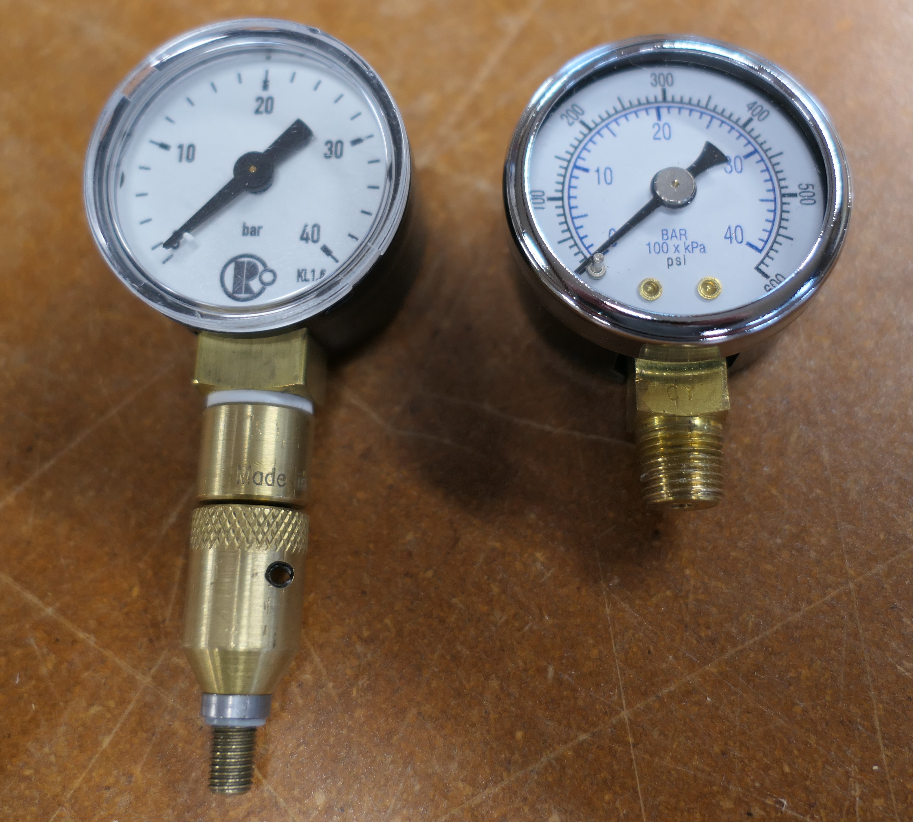

Do you have the Weihrauch manometer? or is it another manometer?

When I first started tuning my HW90 I was curious about the accuracy of the Weihrauch gauge. I bought a generic gauge from Amazon to test it against. (Weihrauch on the left). I tested by pumping the ram to 20 bar, then switching the gauges. They read within one bar of each other.
Note that the Weihrauch gauge has two bar per each division mark. General practice for analog gauges is to round the pointer value to the closest mark, i.e., 10, 12, 14, bar etc. However, you can interpolate between divisions, just don't go smaller than 1/2 of a division. The Weihrauch is MUCH easier to read.

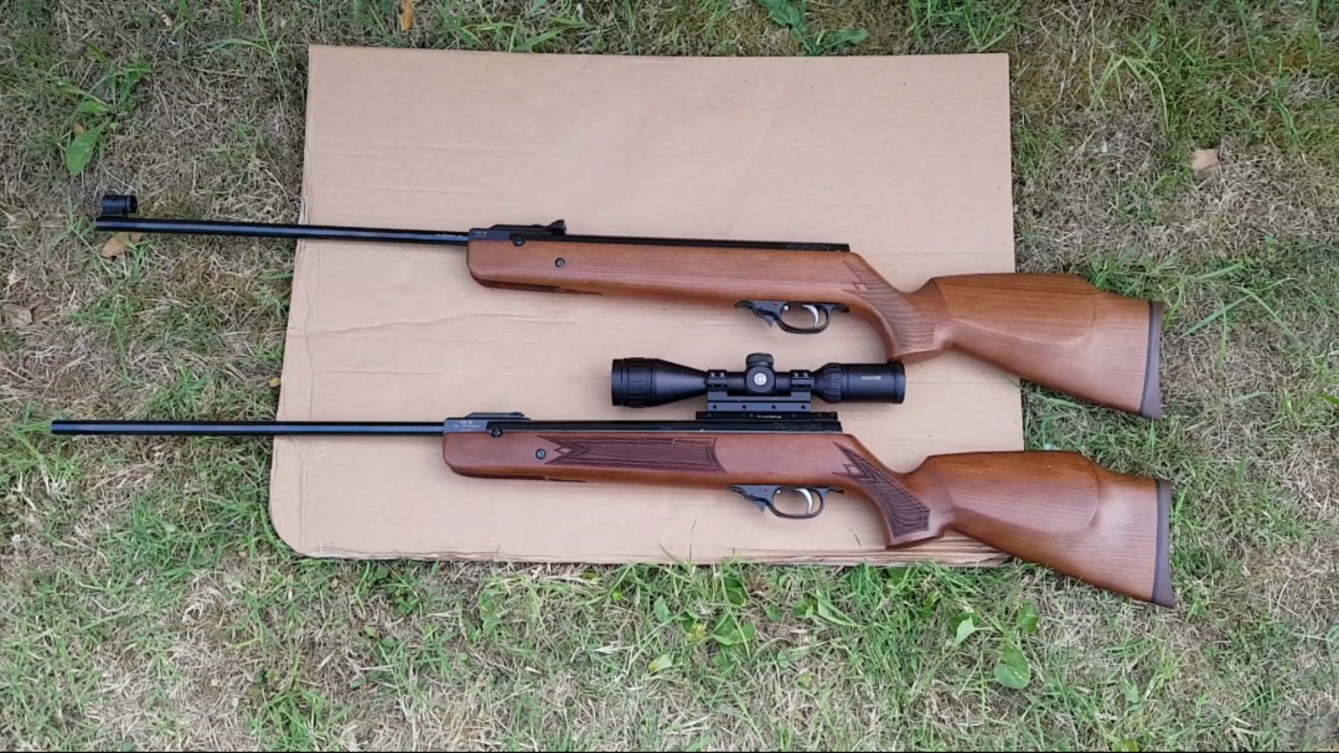

Yes I have a HW90 .177 (next gen 2020-2021) with engravings on the handguard and a HW90 .22 (old gen 2018 or before) without engravings on the handguard.
The 2 HW90 have the factory seal.

I am reassured my manometer works well
