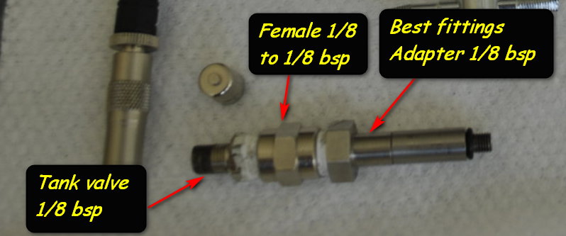

No worries! I am still in it for less than any of the other options. I needed a shock pump for my kids' bikes so I would have bought a shock pump regardless! I wonder if your RS adapter is physically different. I think if the adapter would have had the threads cut all the way to the shoulder of that non-threaded step, it would have worked. Thanks for pioneering the original alternative!
Reactions: fishing43
I did consider it would dump all the air so when I tried it the first time, I attached the adapter to the pump first and spun the pump to thread the adapter in. I did try pumping to see if it would do anything but it would not build any pressure, but I only gave it a few strokes... I will give it another try. I assumed the adapter would depress the valve and you would be able to use the shock pump gauge to determine the pressure.
I assume this means that the only way to estimate the pressure is to release all the air so you know you are at 0, and then build it back up with the shock pump and assume maybe you are a 1/2 to 1 bar less than the shock pump indicates from the slight loss when disconnecting?
you can always pump up until you hear it going in.. plus the gauge on the pump should climb slower when you reach ram pressure, just like PCP guns the pressure goes up fast when you are just filling the line and then goes slower when filling the additional reservoir.

FOR ANYONE STILL WONDERING ABOUT ADJUSTING HW90 POWER=I use the ROCKSHOX 600 PSI pump Schrader adapter with teflon tape to pump up my HW90/.25. Works great, adapter cost 9 bucks:
Rockshox Monarch Air Valve Adaptor Tool
Use small metal rod to tap out pressure. For this unit, using either old DIANA MAGNUM 20grain or H&N FTT 20.06grain, i get 19.0FPE from factory setting with 60LBS cocking effort, ~18.51 FPE=20BAR with easy 40LBS cocking effort; 12.5FPE=14/15BAR with very easy cocking. BAR measurements using Rockshox High Pressure Fork & Shock Pump-
Cocking force measured with bathroom spring scale. The brass AOA Quick connect male to Schrader valve only works if I take off stock, because our Benjamin hand pump's female head is to big, causing interference with stock.
