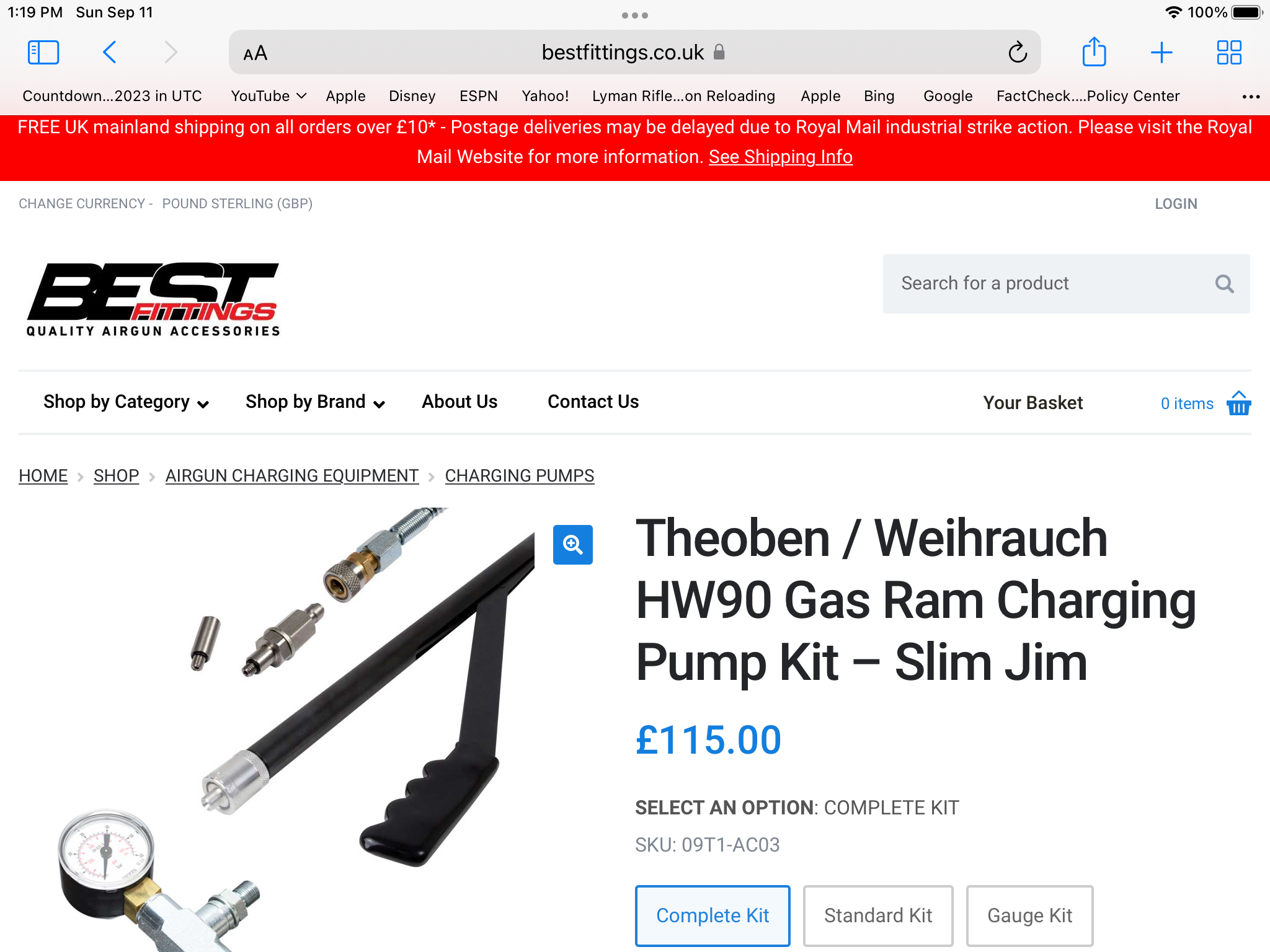

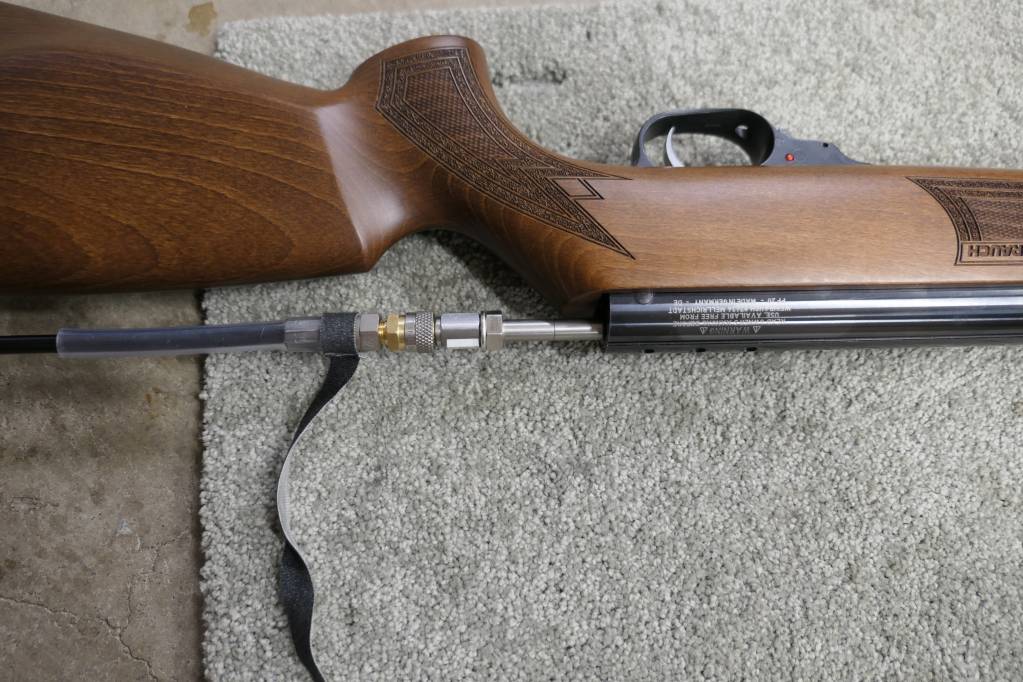

  • To charge the piston I used a Hill Mark IV pump, and two adapters.
    • A Schrader to 1/8 BSPP adapter. Available from Best Fittings in UK.
    • A quick release to 1/8 BSPP adapter. From AoA.
    • You screw the two adapters together, and they connect the Hill pump and the schrader port.
  • The Hill pump’s gauge is meant for much higher pressure levels and doesn’t have fine resolution for this job. But it’ll get you pretty close to 26 bar in about 10 pumps.
  • You start high, and work your way down to the target pressure.
  • The Weihrauch pressure gauge is ideally suited for the job. You just screw it into the schrader port in the back of the gun. You take a reading by depressing the head. Each time you depress the head, it empties its small internal plenum, and takes a new reading. Doing so drops ram pressure about 1/4 of a bar. It’s easy to creep down to the target level.
