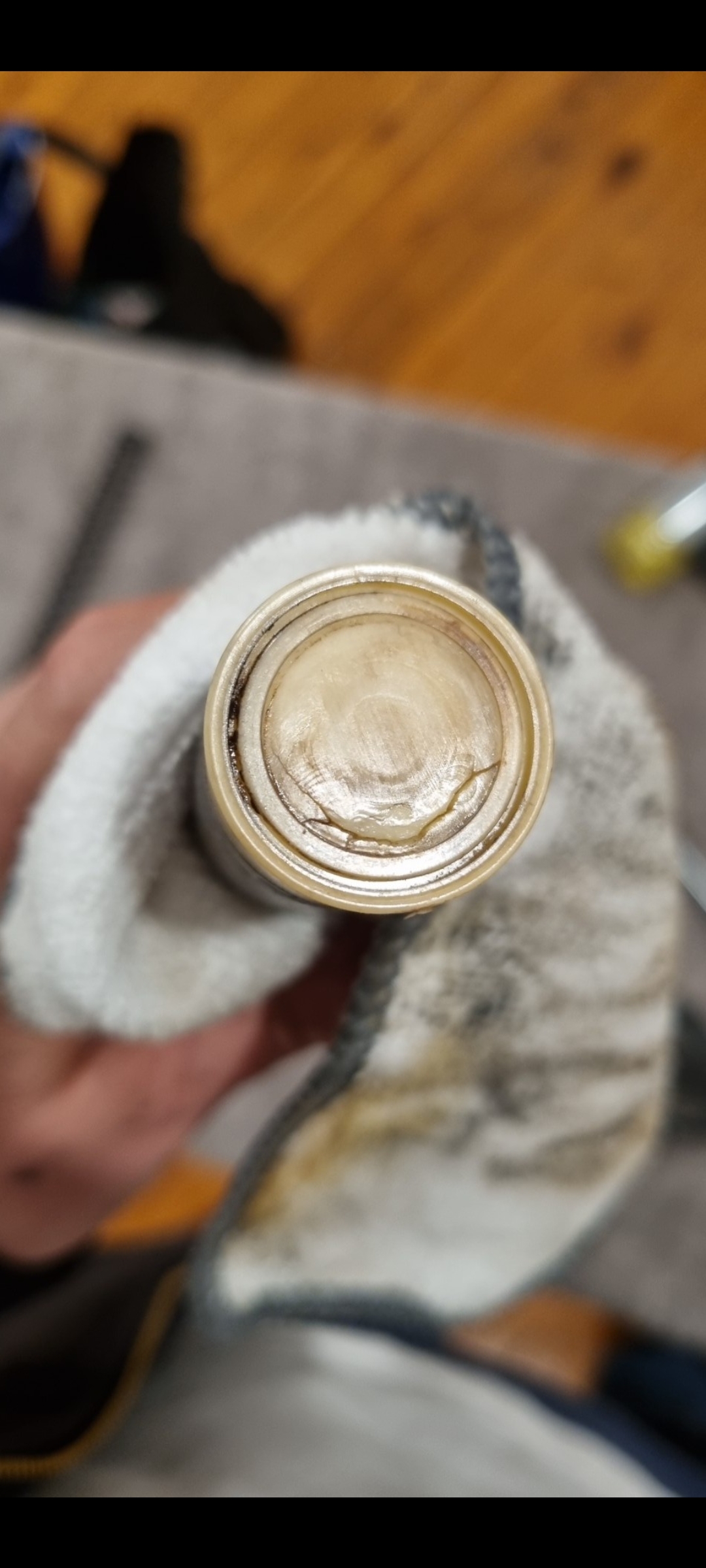

Picked up a used 20 cal 95 yesterday in very good condition and came with a few thousand pellets most ftt and a tin of barracudas.
I headed straight to the range and mounted an old nikko stirling I had on another gun and sited in. Barracudas, ftts and jsb all grouped well.
Chronograph showed 7fps variation over 10 shots (699-692) 6 shots were 698.
I noticed it was a little gritty to cock accompanied with a honking noise. Firing cycle very twangy but no loss of sit picture.
Fully stripped the gun degreased an relubed and cocking feels like a completely different gun.
The seal looks worse for wear but is giving really consistent results.
Do I change the seal? If so should I go the red concave seal or green eco seal from custom air seals?
Cheers
Or arh , but may require fitting of his seal.
Ya, looks like a typical hw factory seal
Notice the transfer port mark that been stamping into that seal ..
Probly from slamming . Could be caused by poor seal, breech seal or I'll fitting / loose or too lite of pellets or dry fireing a lot ..
One of my old factory seals ..

Vortek vac seal all of the way

I ended up going with the green more traditional CAS seal
