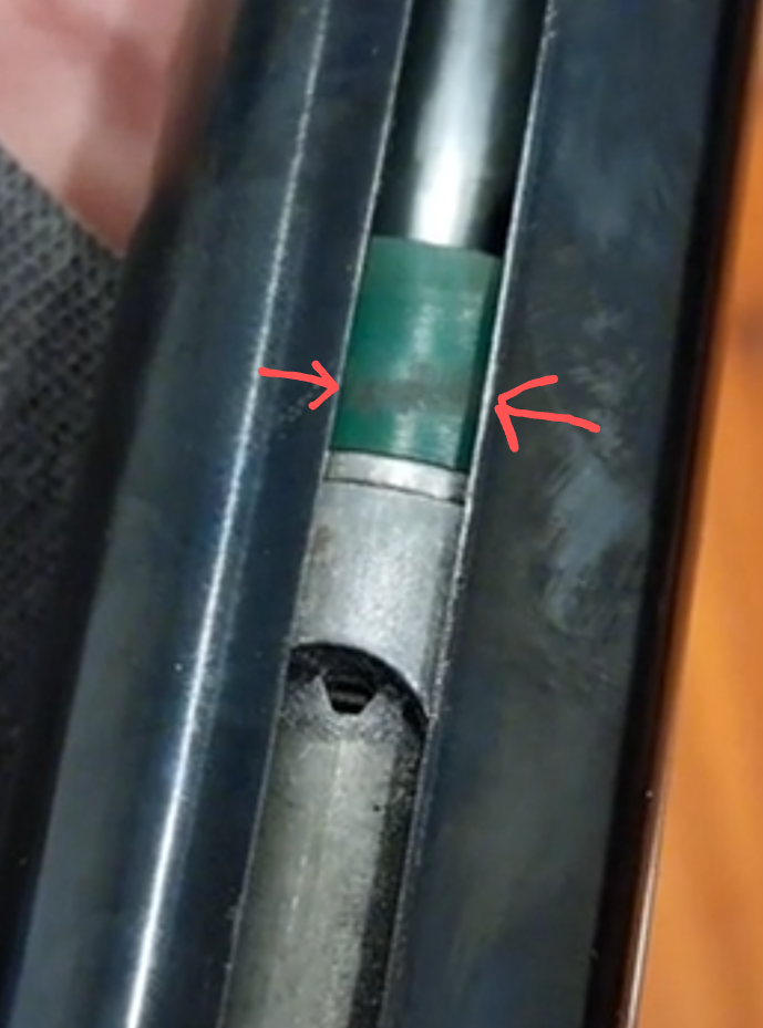

In your video, id say you are correct that you are not sealing well. Whats strange is that the seal looks to be rubbing on the sides, back where the piston nose fits in it. But there's not much evidence of it sealing on the lip where it should. Ive seen this before on older guns. The piston nose is oversized, and stretches the seal too large at the back. I cant tell exactly from the video, but it looks like it could be an issue in your case.
If it comes back apart, pay close attention to where the seal is contacting the tube. You need the front 1/4 of the seal making contact ideally.

Mate you are correct, the seal was a tight fit to the piston button and slightly buldged the seal.

Your are right! When fitting the seal was a tight fit to the piston button, causing a slight buldge. Initially when I test fitted I was getting a good seal. Shot cycle after a few shots was slammy (disassembly shows evidence of this).

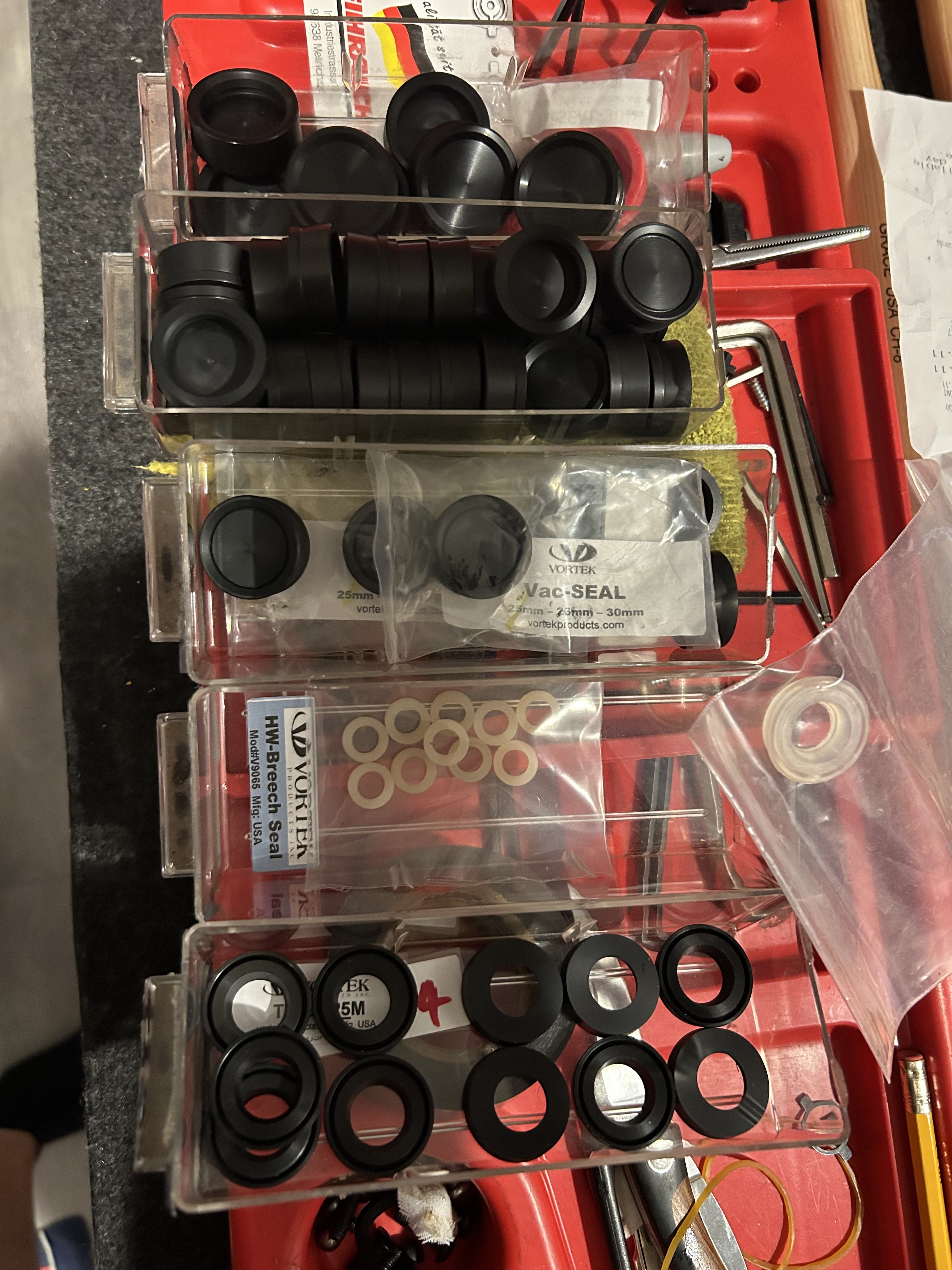

I’m not an expert but I listened to all the expert advice on this forum. The Vortek piston seal won my vote.View attachment 490980Getting ready for the changeover. Crow

I have used ARH and Vortek. In my Beeman R9 .22 it worked very well, but you have to be patient with this seal, because it actually conforms to the cylinder, so shoot at least 500 pellets before you decide to try to "size it down", like you would with and ARH seal. I also have a Vortek seal in a Diana 34 classic. I shot around 400 rounds through it before I chrono graphed again, and I could literally see a couple of FPS increase every 10 shots as the seal was still settling in.
