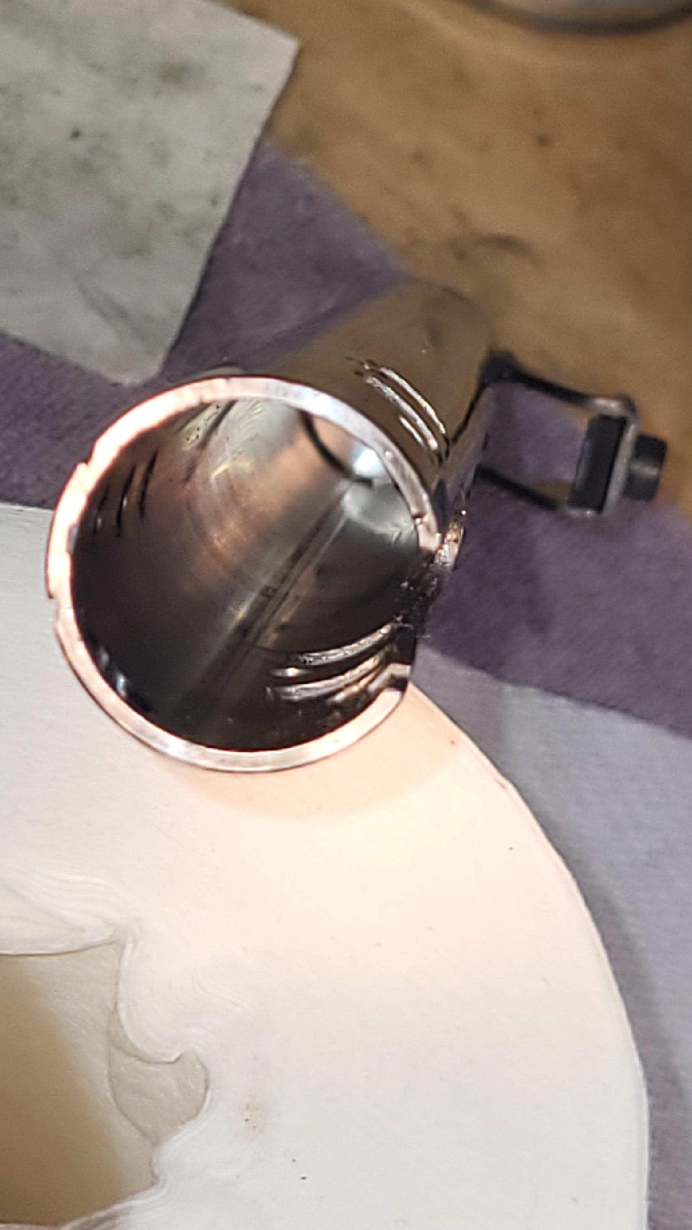

They're also using welded tubing now. The weld seam is sometimes recessed, allowing compression and grease to bypass the piston seal.

That weld seam blows my mind. This situation has really gone over the top.
Good photo of a dreadful situation!
Yup. That tube gives me the willy's. Proper cylinder sealing was everything back when I built race engines. Even as a high end automotive tech, good cylinder sealing was important.
