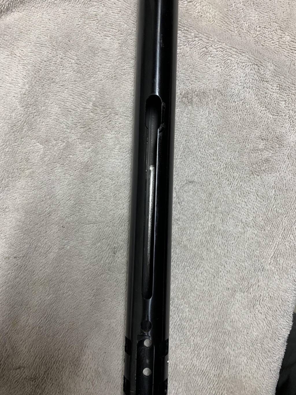

When I opened the gun up, this is what I found. Any idea how I can prevent this? Or is this normal?

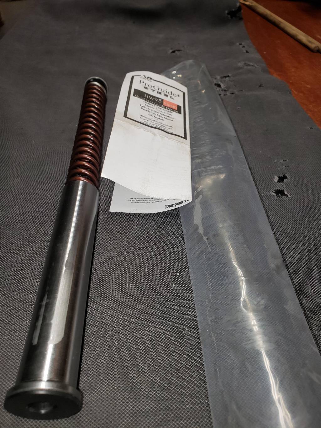

I had the same thing happen to my HW95 when I installed the PG4 Vortek kit. I tried to sand down the cooking shoe some to prevent the contact. I eventually gave up and just put my ARH Maccarri spring back in as I was really happy with it. I never called Tom at Vortek to let him know what was happening. I just may now that I see I am not the only person to have this happen. The steel guide may not have gotten machined down enough?

Looks like the cocking lever shoe is dragging. I'd polish the under side of that shoe with 400-1200 grit wet/dry sandpaper and then do the same to the guide. Make them shine! I may even slightly (very slightly) round off the pushing corner of the shoe where it would meet the guide. After that, a thin coat of moly paste on the outside of the guide and on the shoe.
Credit where credit is due though. Thumper did call this from a mile away. I've never had an issue like this with a Vortek kit.
Looks like it was starting to gall. You caught it just in time. Galling creates bits of hardened metal that needs removed and is difficult to sand out. I use a carbide scribe to scrape the hardened pieces out. I don't think you have that problem. I too would recommend moiy paste. Polish the cocking shoe rails and moly lube.

You're focus really only needs to be on the contact surfaces between the spring guide and cocking shoe. Polish and moly should do wonders there.

That rubbing on the spring guide is not normal and it doesn’t look as if a dab of moly will address the problem. It is also impossible to say whether the problem is an oversized guide from Vortek or something unique to your hw95. I have used probably a dozen Vortek kits with good outcomes, but there have been a few fit and sizing problems that I needed to get fixed too. I’d get in touch with Tom and explain the problem and see if he can suggest a remedy.

After hearing so many positive results, I had to try the PG4 in my HW. I am very capable of machining down my cocking shoe but am not taking gun apart AGAIN to do this. Maybe I'll try it when the ARH spring gives up? It is a bit disappointing as this is to be a drop in kit. If I find a HW98, I may try this kit in there. Or, it may turn up on the classifieds.
I tend to agree, he might consider polishing the guide tube with a more course finnish and a finer finnish on the cocking shoe. The reason is, it is better to have one of the mating surfaces having a more course finnish to retain lubricant. Steel on steel surfaces tend to cause more issues if both surfaces have fine polished finnishes. For the small shoe, try a cratex polishing wheel mounted on a dremmel tool mandrel, works like a dream !!

The steel on that outer guide is so soft I'd probably won't even polish well. And if it does, it so soft it wouldn't matter anyway. The one I had was like it was made from cheese it was so soft.
That's why the metal got scraped off of the guide, and ended up between the piston and receiver. That's where that wear mark came from, they don't just gall like that all of a sudden when it was fine before the tune. There was debris or metal from that guide in between there. Clean the receiver out good before you put it back together, and make sure there isn't any of that soft steel embedded anywhere.

You are right, everything you’ve said about the pg4 kit has been true in my experience. I think the metal guide is a bad design. I would not order this kit again. The only thing that’s keeping me from ordering a different kit is that I already removed and destroyed my piston sleeve. I’m assuming I would need a new piston to use an arh kit. So I’m stuck trying to polish this one and use moly.
Nah you don't need a new piston for either kit. The sleeve isn't required on an ARH kit, and you may need to remove it anyway for the front guide to slide in. But not always. I like keeping the sleeve, or making a new one from PTFE sheet because I feel it helps dampen noise and requires no lubricant on the spring. But not necessary at all and most guys toss em anyway. A sleeve is super easy to make, especially from plastic type material with nothing but a straight edge and a pair of scissors.
The Vortek kits have always used the outer guide setup, but they were always plastic up until recently. The plastic was much better since it is self lubricating to some extent and doesn't gall like the soft steel. I predict very soon that Vortek will go back to a plastic guide. There is really no benefit at all to it being steel, but lots of downfalls, as you have found out.
