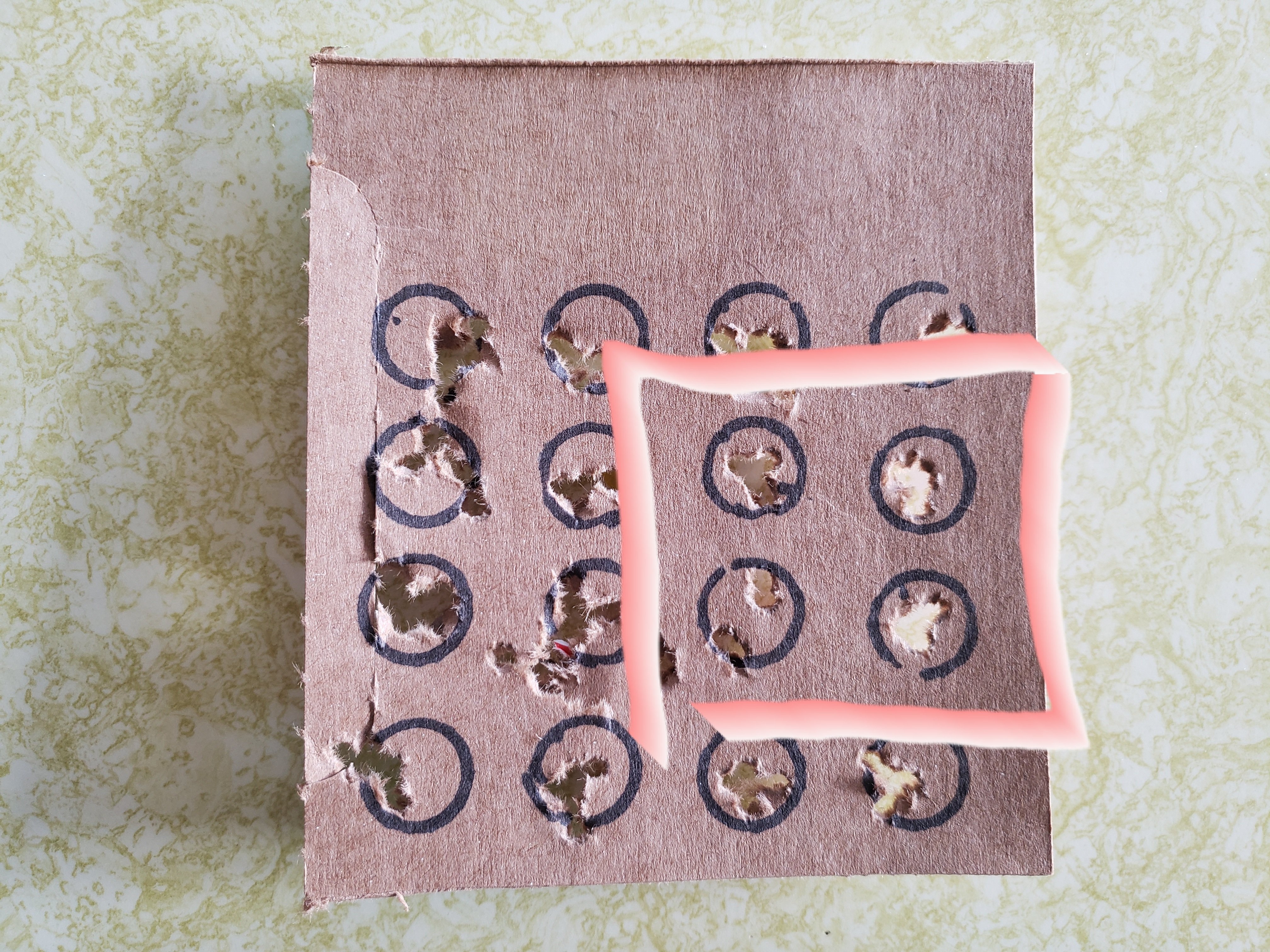

Here's a few 5 shot groups at 22 yards off my fancy bamboo shooting sticks and milk crate seat. They are the 4 groups outlined. Thats with the JSB heavies(10.34). The Baracudas were similar. The JSB 8.44 exacts were not very good but they were sailing over 900 fps.
