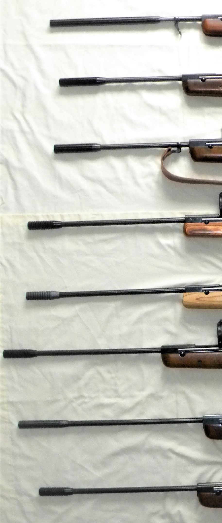

For me I use them very often and I enjoy and often feel a need for additional weight up front. Especially for offhand shooting they stabilize and or help balance the gun and lessens or removes the feel of the gun "floating". There are many different weights and lengths available so the effect or tailoring from one gun to the next is possible. I also prefer the look over nothing at all but be aware pending on the weight the front sight dovetails may need to be reduced or fully eliminated to install.
Here are a some of the ones I have installed.
346 Beeman R1 collection- left side .177, LS .22, .22 San Rafael, .25 Santa Rosa, .22 Laserize...JPG
