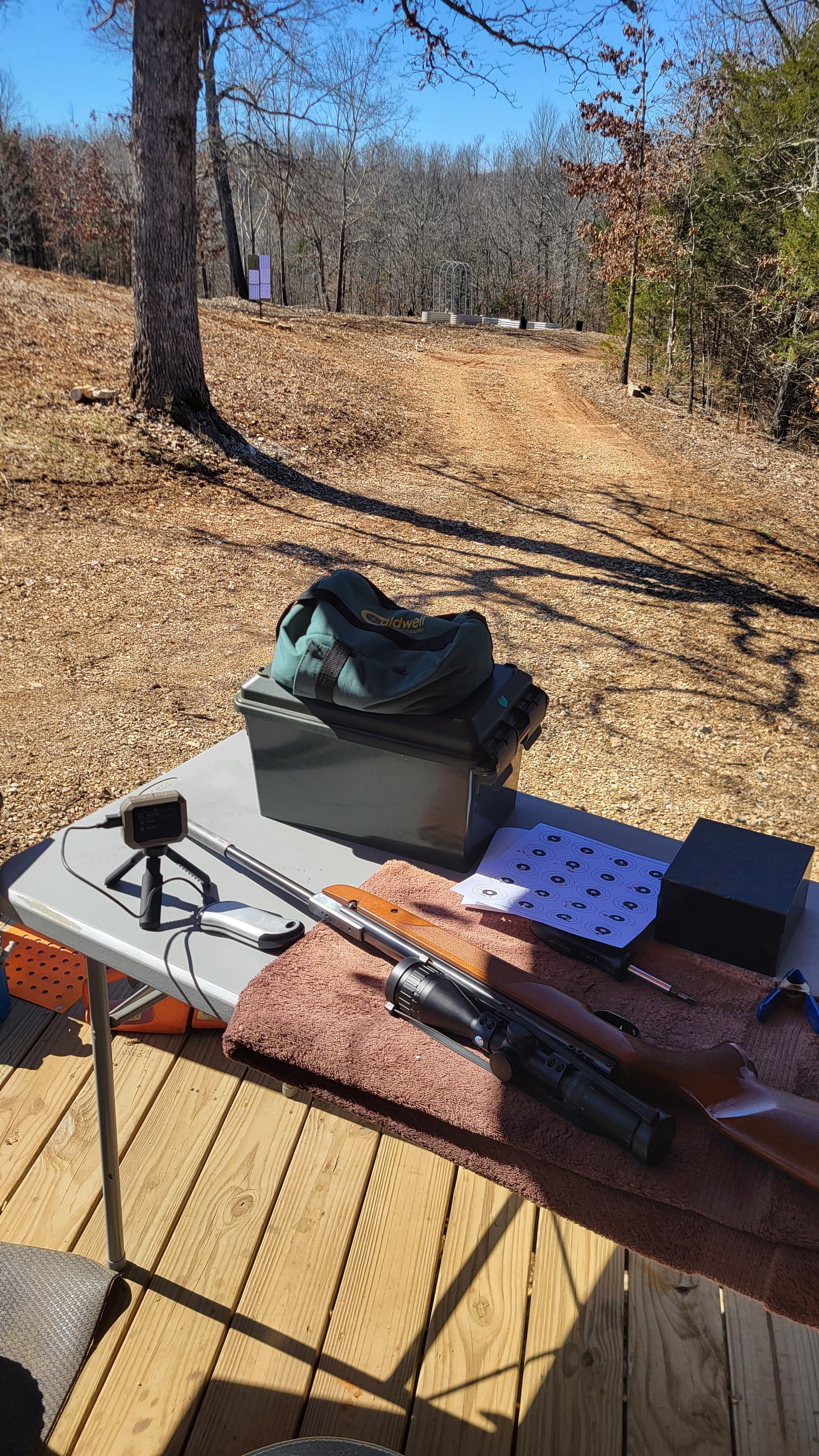

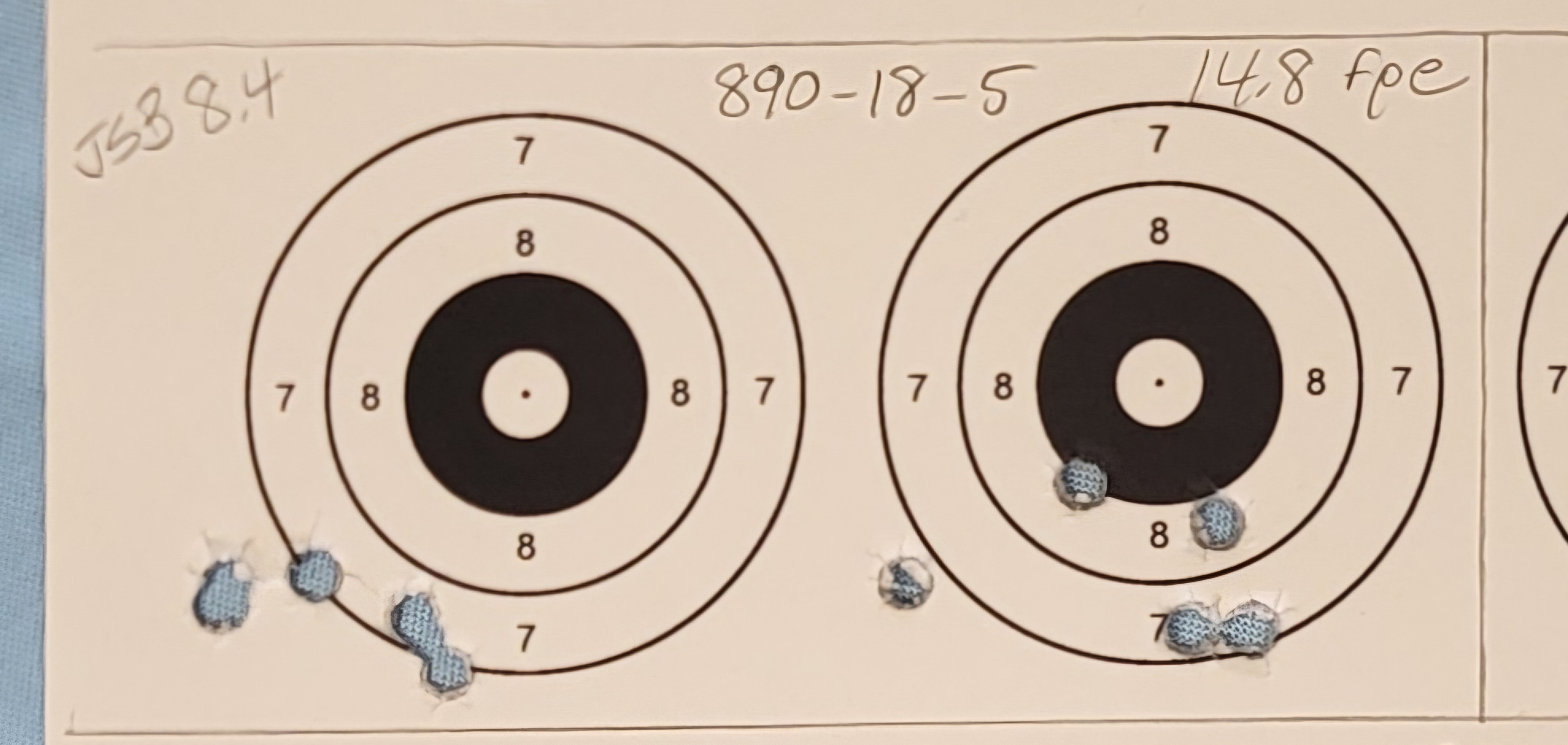

Today it's gorgeous outside so I did some shooting. I started pellet and scew torque testing with my Hw50. Then I broke out my big dog Weihrauch. My Hw95. It was my first Weihrauch.

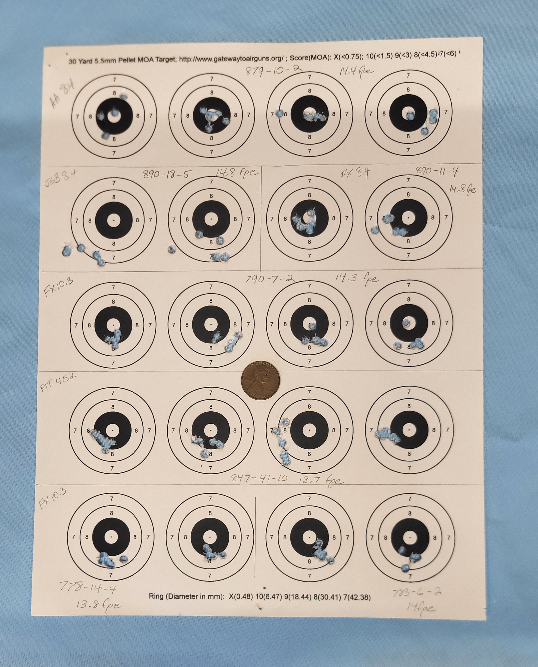

All targets are 5 shots at 25 yards. The numbers are AVG velocity- Extreme spread- Standard deviation respectively.

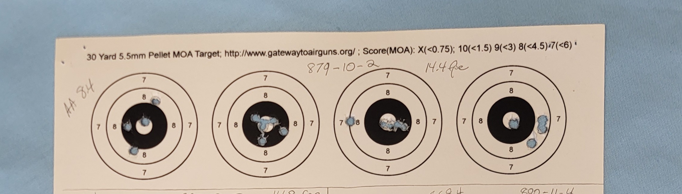

I started with Air arms 8.4 which are made by JSB in a single JSB die. The first group is not great, but that's fresh off the rack. Besides the flyer on #3 the rest were good by me.
Next two are regular JSB 8.44 Exacts that will come from multiple dies. This tin and the other 9 that I bought at the same time print poorly in my other guns as well. The generic unsized JSBs tend to run small and comparatively inconsistently sized. This is why I don't buy more than ten tins of regular JSBs. The JSB specific sized tins like 4.53s are better.

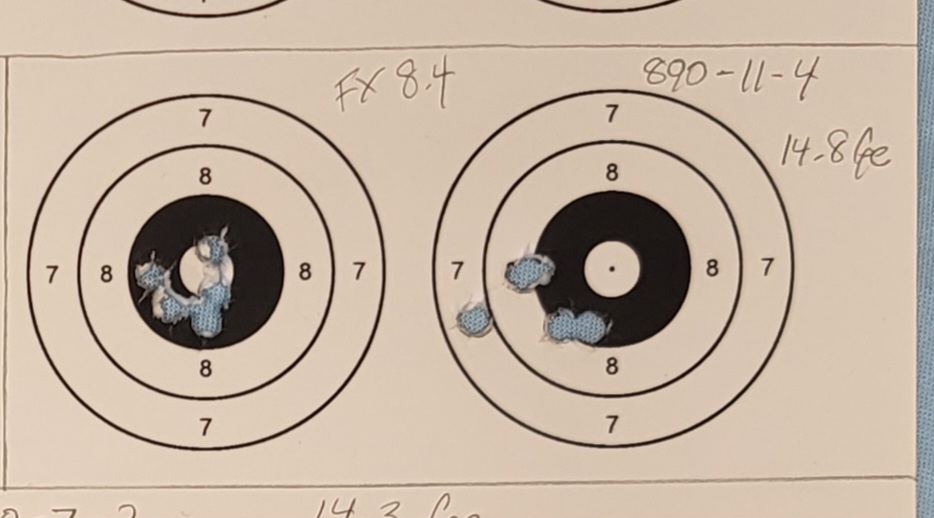

The next two were FX 8.4 which JSB also makes. I suspect these are single die packaged as well. Very uniform fit. Good accuracy and top energy.

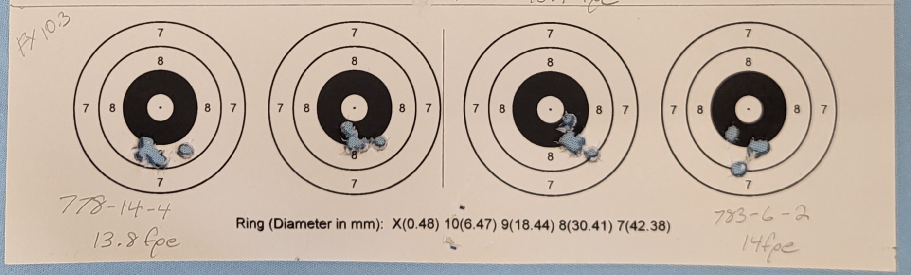

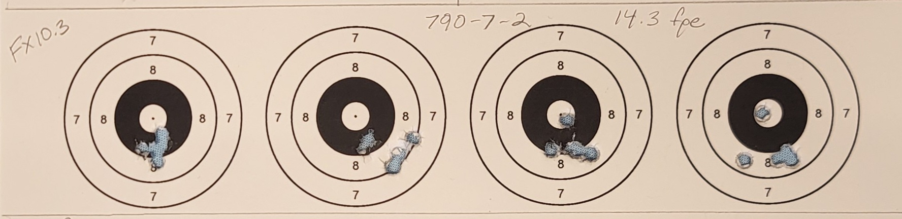

Next up was FX 10.3s. I don't normally shoot heavy pellets in my springers because they generally aren't efficient and can be tough on springs. I tried these 10.3s because so many people have had good results with the JSB (and rebrands)10.3s. The first group blew my mind. The next three were good as well.

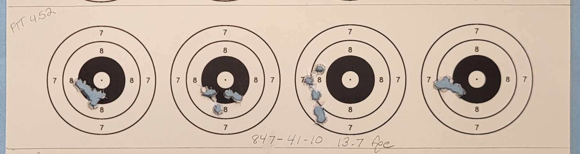

Next up was H&N FFTs 4.52. These started fast and continually slowed with shot count. This is typical of running H&Ns on a barrel seasoned with JSB lead. Notice the wide Extreme spread and low energy. The velocity and energy eventually stabilizes but always lower than comparable 177 JSB pellets. Except for the third group accuracy was good. That third group might have been me losing concentration. I pulled myself back together on the next group.
To show the effects of barrel seasoning I went back to the FX 10.3s they started slow on the H&N lead and slowly picked up velocity as they seasoned the bore with their own lead. Notice the increased energy and tighter extreme spread on the second ten shot string. These groups were good again. I'll have to pick up more of these 10.3s and do some actual BC testing on them. The way they hit the spinners harder than the 8.44s at 35 yards I suspect they have a considerably better BC.

How did you end up on the screw torque?
Inconclusive. Yesterday my 50 was shooting poorly and I remembered that the groups went bad once when I tightened the the small trigger guard screw only for good measure. Turning it back to where it was and the gun went back to shooting well. Yesterday and today i didn't realize I had a bad tin of JSB exacts so testing was pointless. I'll do the test again with better pellets. I'm fairly certain overtightening screws has a negative effect on accuracy. That and breaking tuff😅. A Fat Wrench is a wonderful tool for these things. The only more important tool is a good chronograph

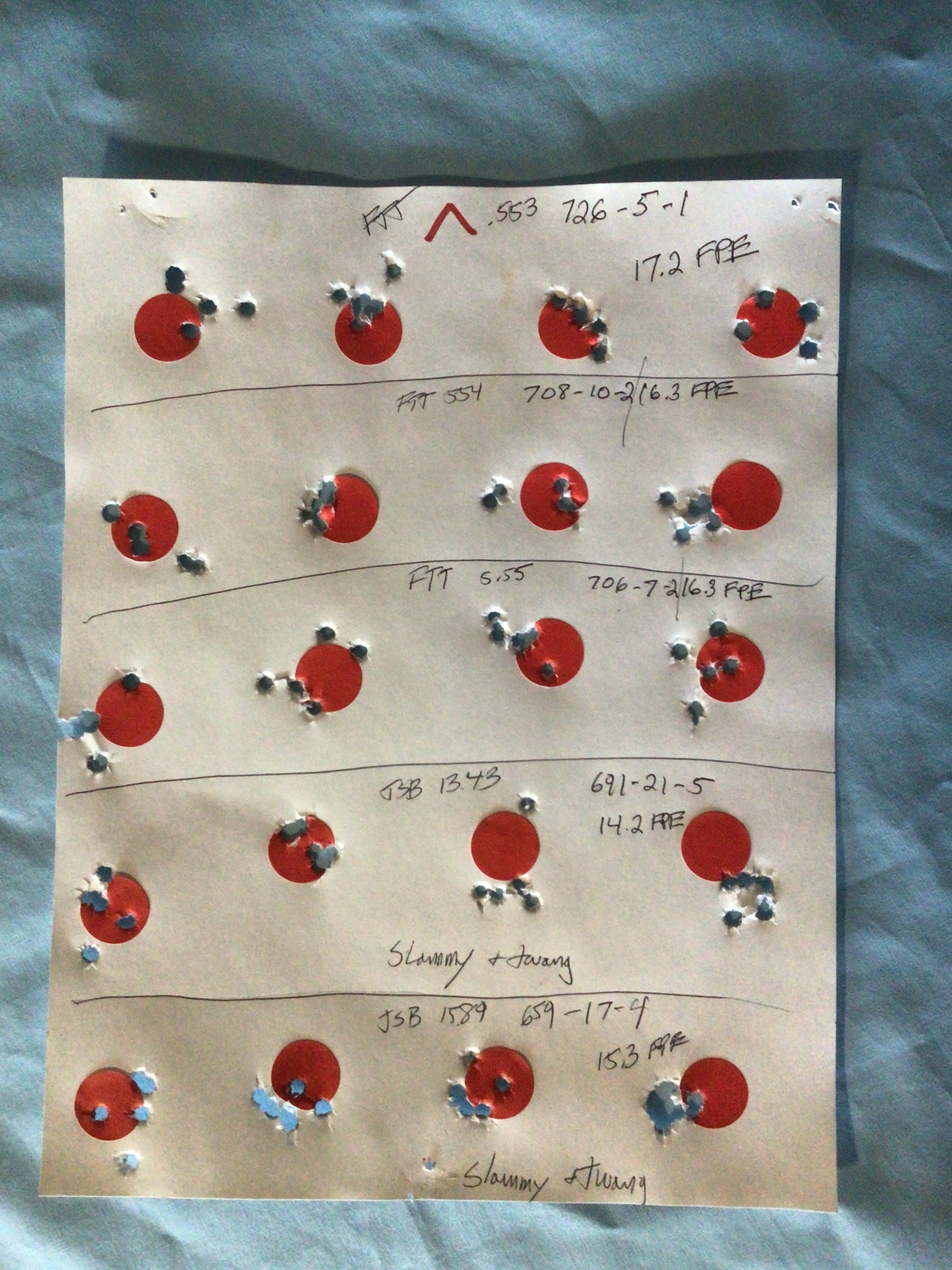

Here's a tune test on a 22 caliber Hw95 I just did that will illustrate what I'm talking about. First it needs to said that 22s are more efficient than 177. Because of the increased area behind the pellet a 22 requires something like 60% less starting pressure than a 177. Look at the energy. Remember energy is efficiency (providing there's no considerable dieseling).
First row H&N -FTT 5.53 = Avg 726fps, ES 5, SD 1 & 17.2 fpe
Second row--- FTT 5.54 = Avg 708fps, ES 10, SD 2 & 16.3 fpe
Third row------FTT 5.55= Avg 706fps, ES 7, SD1 & 16.3 fpe
Fourth row JSB RS 13.43 = Avg 691fps, ES 21, SD 5 & 14.2 fpe
Fifth row JSB Exact 15.89= Avg 659fps, ES 17, SD 4 & 15.3 fpe
A couple interesting things with this. First look how much difference head size made in energy between the FTTs. Almost a full foot pound. Just shows how small differences in resistance and can make big changes in efficiency.
Next look at the JSBs the lighter 13.43s made the least energy and the 15.89s made more than the 13.43s but still less than the FTTs. This is because the JSBs have a looser fit and softer thin skirts. These pellets don't offer enough resistance and start their way down the barrel earlier in the stroke than the FTTs. The JSBs are more or less pushed out the barrel exhausting swept volume without reaching a high enough peak pressure. Where as the tighter fitting FTTs create a higher peak pressure that pops them out at a higher velocity. I call this the pop gun effect.
Also the higher the pressure, the higher the compression heat. Air expands when heated so there's likely some additional energy added by thermal expansion of the minimal amount of available air. How much? I'm not sure because it's not alot of air and it only lasts milliseconds. That's really getting in the weeds but it's a possible source of additional energy. After all there's enough compression heat to combust petroleum greases.
Also notice as efficency drops, extreme spread grows. ES can be a sign of mechanical problems with a gun. In this case it's just another sign that the gun isn't operating smoothly inside. When it's not operating smoothly inside its tougher on springs.
Everything is a very fine balance of resistances. Energy is efficency. Its best to find a pellet that is accurate while being close to peak energy. Finding the right pellet can be a chore. Smarter people than I tune guns to pellets by altering transfer ports and other things. Messing with things like transfer ports can radically change these balances so I just try to work within the guns design.
In short springs are consumables and if you get better accuracy from heavy pellets go for it. Just be prepared to change out springs a little more often. If you want to get the most life from your spring find an accurate pellet that creates close to max power. This is ALL only relevant to healthy clean running guns. Guns that don't seal well and diesel need to be fixed before any of this even remotely matters.
first row H&N -FTT 5.53 = Avg 726fps, ES 5, SD 1 & 17.2 fpe
A couple interesting things with this. First look how much difference in energy between the FTTs almost a foot pound. Just shows how small differences in resistance and can make big changes in efficiency.
Also the higher the pressure, the higher the compression heat. Air expands when heated so there's likely some additional energy added by thermal expansion of the minimal amount of available air. How much I'm not sure because it's not alot of air and it only lasts milliseconds. That's really getting in the weeds but it's a possible source of additional energy. After all there's enough compression heat to combust petroleum greases.
Also notice as efficency drops, extreme spread grows. ES can be a sign of mechanical problems with the gun. In this case it's just another sign that the gun isn't operating smoothly inside. When it's not operating smoothly inside its tougher on springs.
Everything is a very fine balance of resistances. Energy is efficency. Its best to find a pellet that is accurate while being close to peak energy. Finding the right pellet can be a chore. Smarter people than I tune guns to pellets by altering transfer ports and other things. Messing with things like transfer ports can radically change these balances so I just try to work within the guns design. In short springs are consumables and if you get better accuracy from heavy pellets go for it. Just be prepared to change out springs a little more often. If you want to get the most life from your spring find an accurate pellet that creates close to max power. This is ALL only relevant to healthy clean running guns. Guns that don't seal well and diesel need to be fixed before any of this remotely matters.
