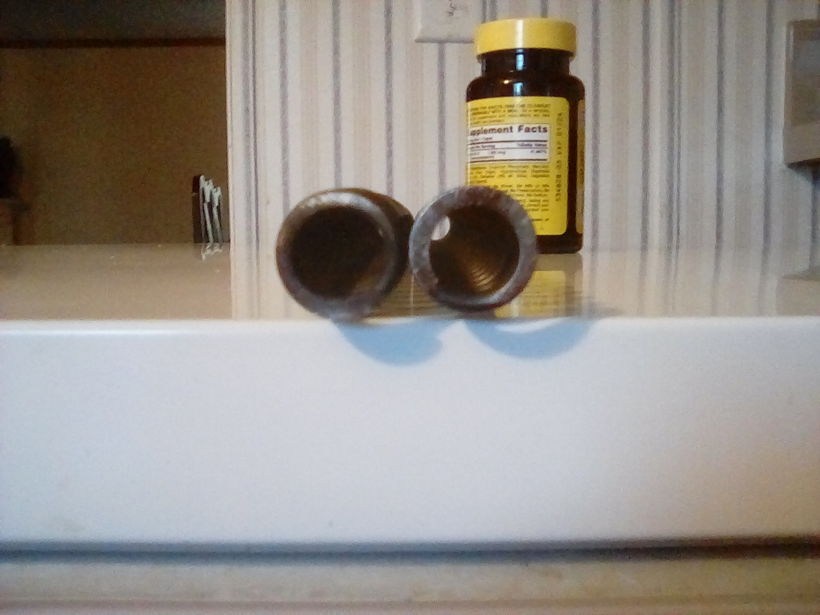

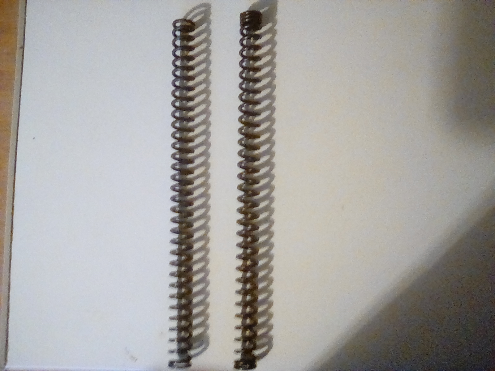

jink 1963, the OD of the JM Hornet Spring is the same as the factory spring. Keep in mind JM makes different springs so who ever said the JM spring has a larger OD might have been talking about a different one. Both ends of the JM Hornet spring match up perfectly against the factory spring. The inside diameter of the ARH spring looks a little smaller. As I said it was a tight fit on the factory spring guide. Side note. The ARH spring is a half inch longer than the factory spring.
ARH spring on the right. Factory spring on the left.
The Vortek kit adds in extra metal-to-metal friction that's entirely unnecessary. They also by design are forced to use a smaller outside diameter spring, which is higher strained than a larger diameter spring. There also several reports (mine included) of problems when fitting. Overspung and overly complicated with cheap construction.
The ARH kits have a proven track record over MANY years. They are able to use a larger and less strained spring, and should last much longer and be easier to cock. There is no outer guide to take up extra space in the piston or cause friction/galling. The ARH moly lubes are also excellent and copied by many.
