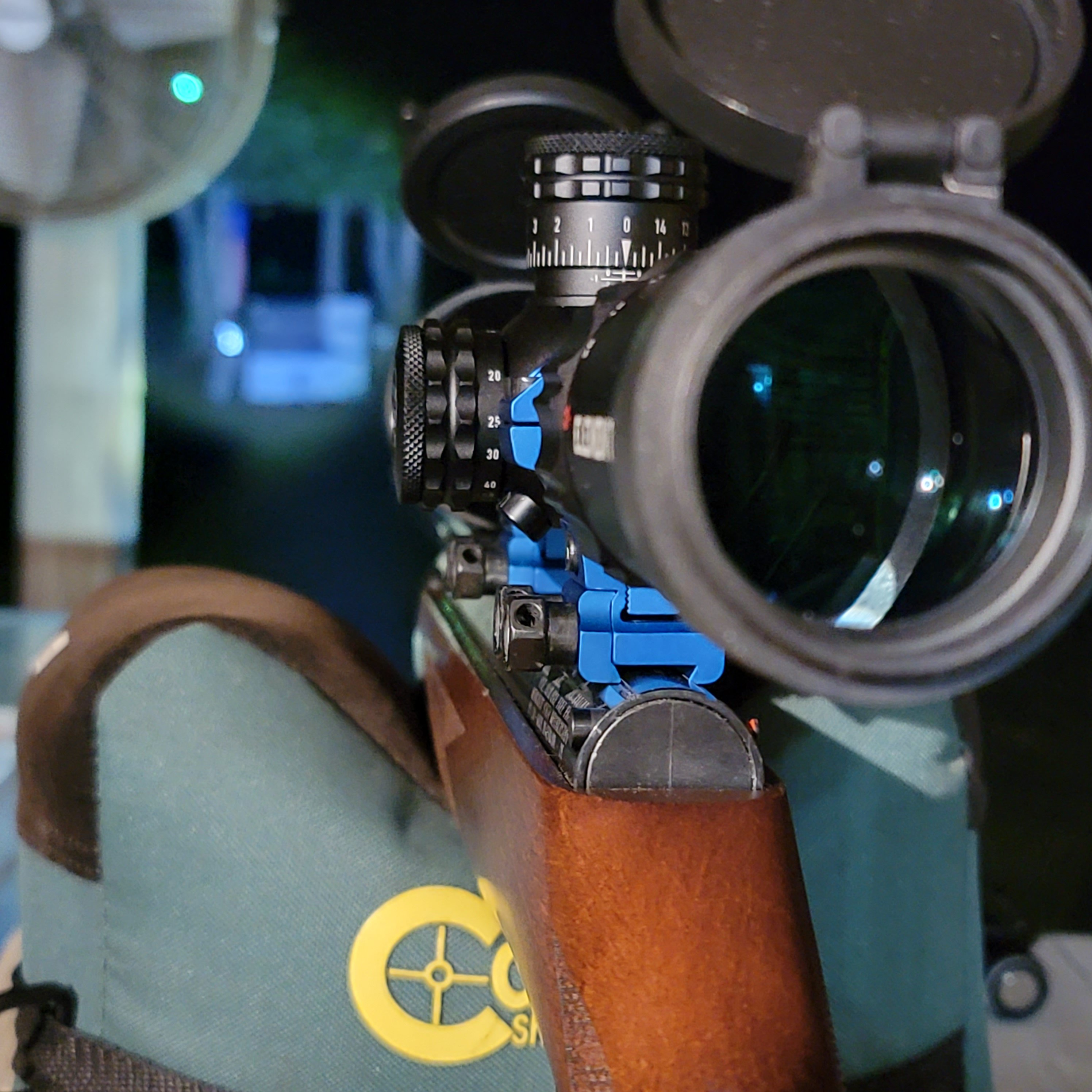

The rings come with 30mm or 1inch capability. Screenshot_20240325_083523_Gallery.jpgScreenshot_20230713_082826_Samsung Internet.jpg
