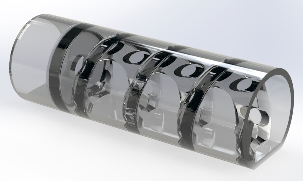

Just the other day, I was shooting my HW97 and the accuracy was getting spotty. So, I cleaned the barrel, and in the process, I forgot to reinstall the cap that goes on the end of the moderator. I didn't know I had forgotten it, and went back to shooting. The pop from the muzzle was so loud I thought it was dieseling. I tried a few more shots, thinking it would go away, but it didn't. Then I discovered I had failed to install the cap. Once I installed the cap, the gun quieted right down to normal. I was really shocked at the difference in report with the moderator assembled properly.
This lead me to think about installing a baffle in the space the moderator provides. So next I designed and 3D printed a mono-core baffle.
This is a rendering of it in acrylic so you can see the helical baffle. I 3D printed the one I installed in the gun. It had a very positive impact on the report volume and tone. It's now more comfortable to shoot inside, and the lower tone is more pleasing to my ear.

Hi Mike, Does that baffle slide onto the moderator or the barrel? I just received a small 3d printer as a gift and have been searchinging for an stl file for a moderator or baffle for my R9. It would be my first project. I believe the printer will print in PLA and ABS, but I'm not at all sure they would be suitable materials. Any info and your experiences would be greatly appreciated.
Yes it does slip into the end of the HW97. I made mine from PLA. That should be just fine. Send me a PM with your email and I’ll send you the STL file. It should take about an hour to print. I used the most basic settings and no support.

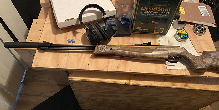

I got my HW77 moderator today from AoA. The install was straightforward, though tricky with the tiny allen wrench routine; as the Byrds say, Turn, turn, turn. Then turn some more. It's a good item, definitely quieter overall, from the shooter perspective, the sound is lower, which is more pleasant. Instead of a pop, it's more of a dull thud. I would say that the moderator definitely works well.
The sad part, is that with tinnitus, there is no way I can deal with a springer. The vibration effects have my left ear going nuts. Bummer, but it's too painful. So, I'm going to remove the moderator and pack everything up and sell it. I'm curious about PCP's, AoA recommended the Daystate Revere with a moderator as a good choice. I'm hemming and hawing about that. Currently, I've been happy shooting my HW75 and so I'm wondering if perhaps pistol is the way to go since there's nothing against the bones of my head. There's an indoor air gun range nearby so I'm going to check them out and perhaps I'll meet someone that will have a PCP rifle.
