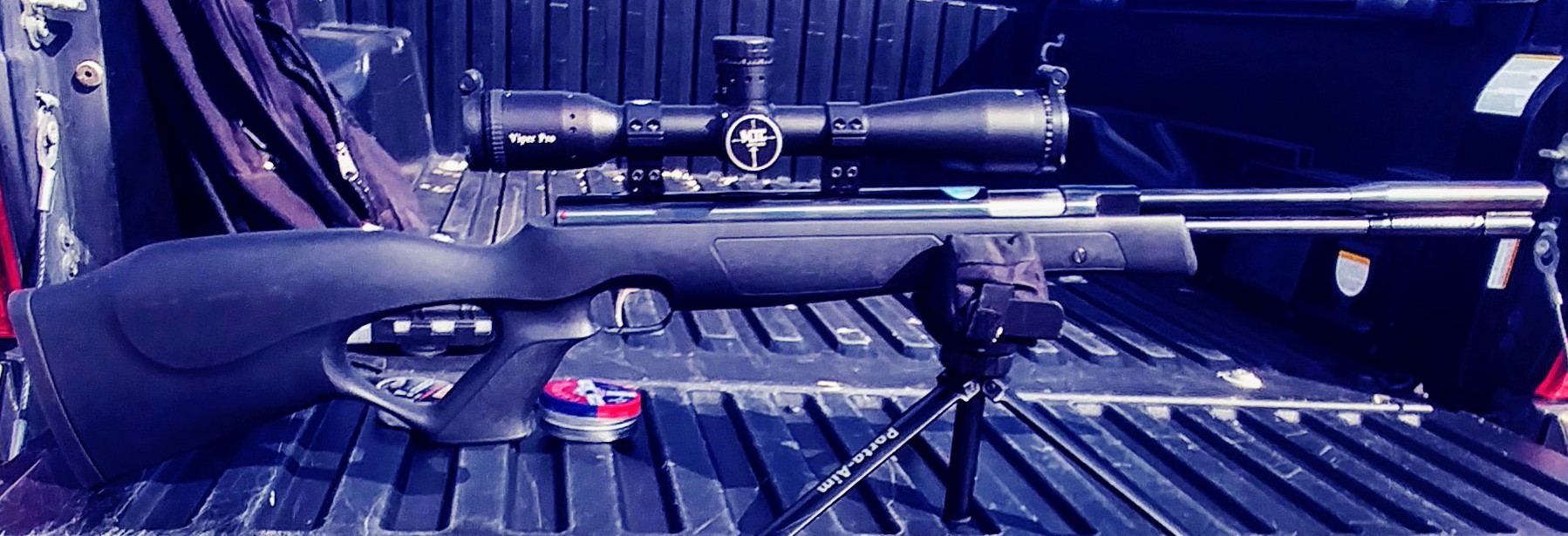

After purchasing an HW97k I really wanted it to like Crosman pellets because I shoot high volume, and realized that the pellets cost more than the rifle in the end. The rifle shot impressively but not like I had read about. I would occasionally try JSB and H&N but they were no better and cost way more. I was sort of happy that my Weihrauch HW97 seemed to like the cheap pellets.
