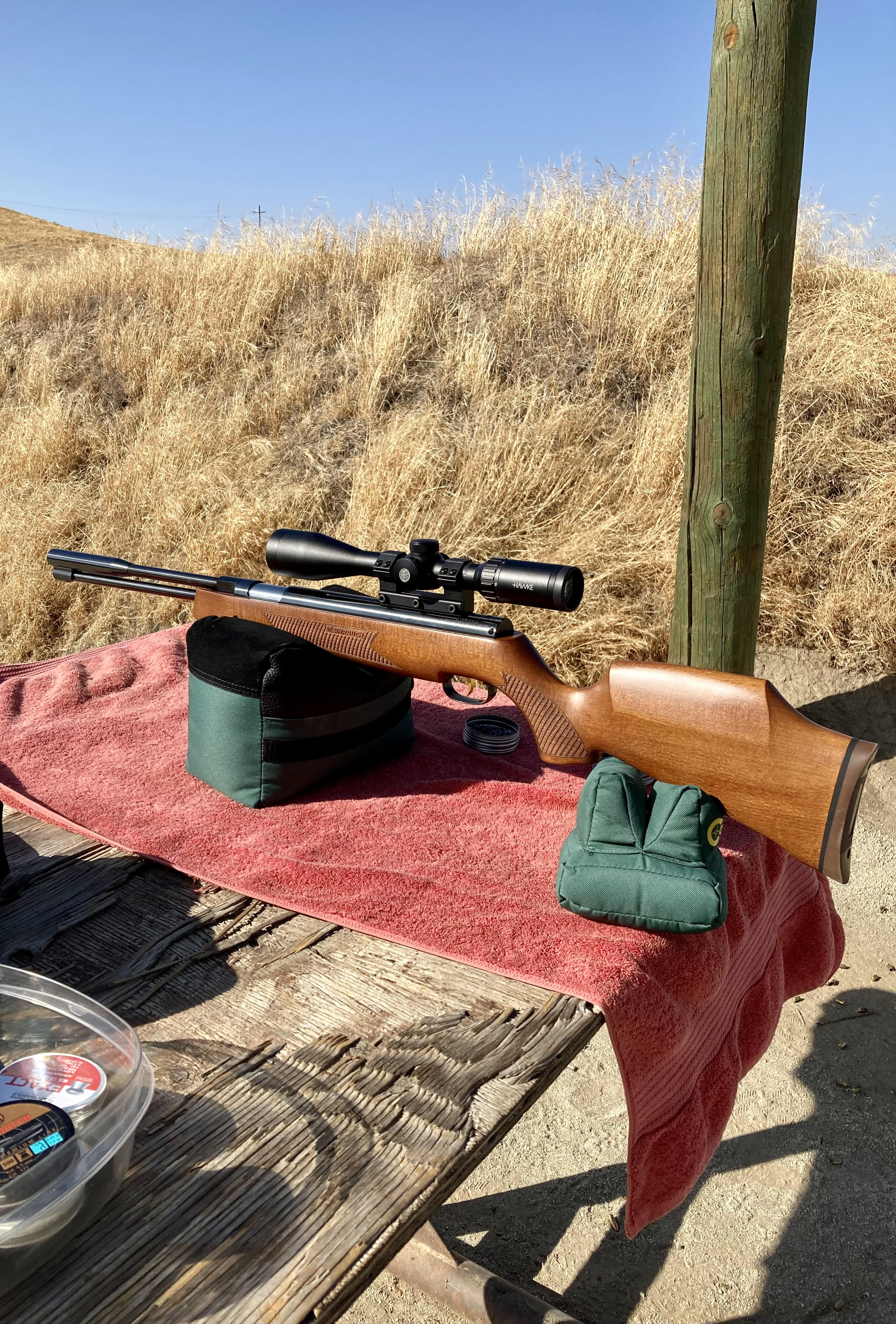

I made it out for some 50 yard groups at sundown. I could barely see the reticle since I was losing daylight. Managed four groups from the tailbed of my truck. I shot 3 with JSB Express and one with FTT. On my last group I lost track and shot only 4 instead of 5. I plan to do some more testing with other pellets when the weather improves.
