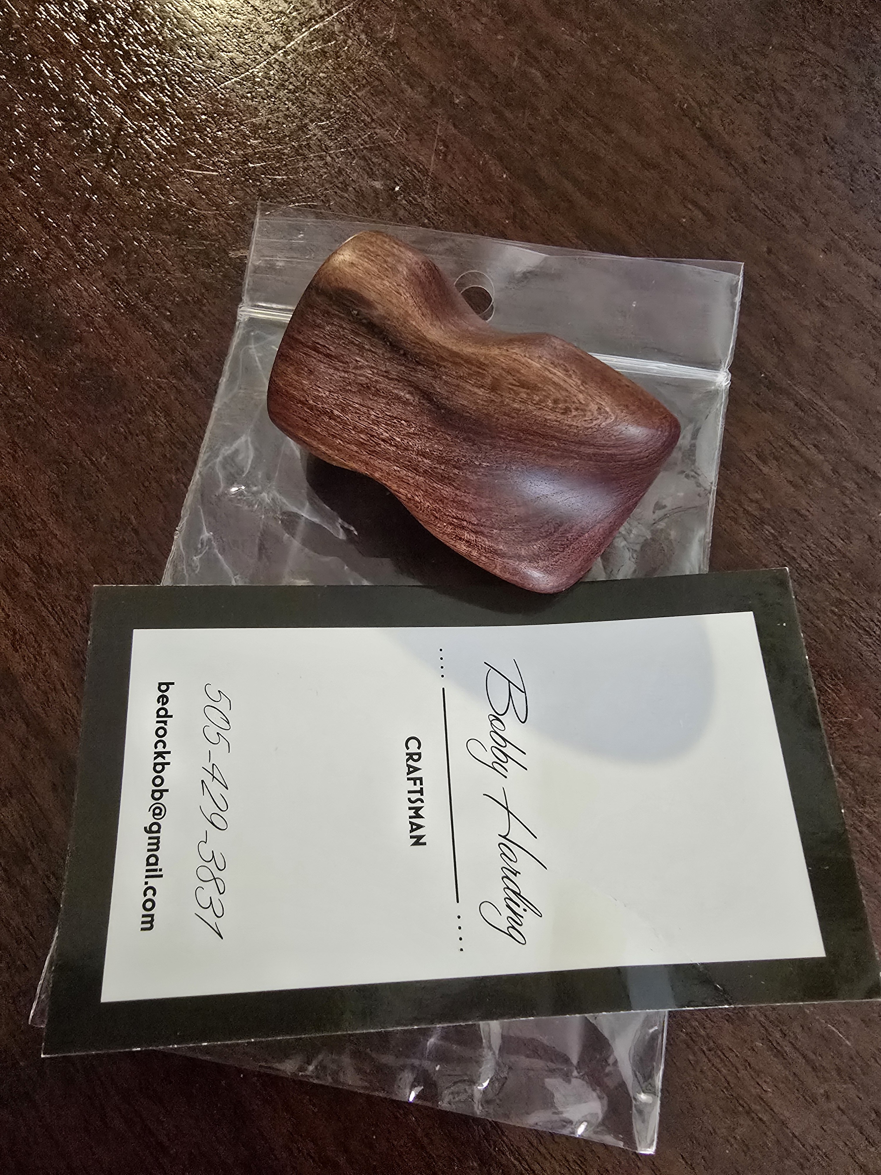

Now, when working on my 97K, I've got this really cool safety device that I put in the breach, I can't remember who makes that thing???, but it's beautiful and looks as nice as any of my rifles stocks, ✋👀 👍 well what would acetone do to such a device as that, if I were to drip some on there?
It would dry it out and strip the wax/oil.
I just use a damp patch so it does not pull off a drop when the patch compresses. It just brushes by the wood. But after some solvent hits that wood its bound to strip it. No worries. It's just a chunk of wood. Oil it up and shoe polish it of it gets dry.
Acacia grows fast but it's super dense. It's hard. They used to use it for nails in drilled holes. It won't absorb acetone or much oil. So it's just the surface finish that's wiped off.
