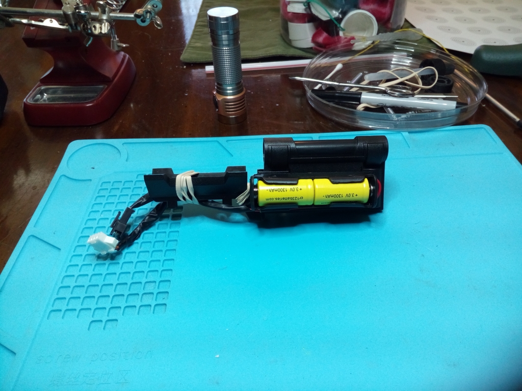

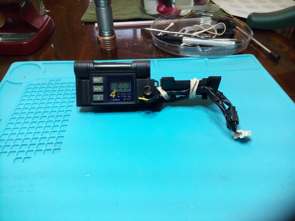

I have the Combro cb-625 and F1 chrony in the green box and they read exactly the same, I modded my combro with the external 6v battery so I do not have to push the reset after every shot and now that is the only one I am using. I always had problems with the light and the alignment on the F1. As for your other questions about the HW97 and Gammo I do not have any experience with them.
