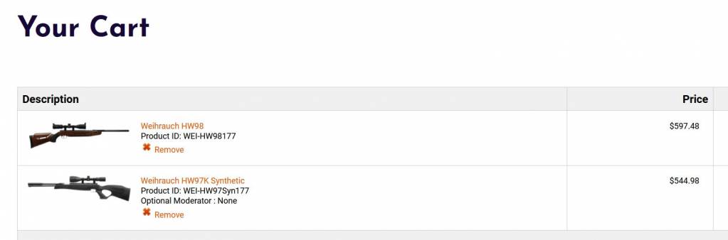

Well.... I guess it's gonna be the 97K. Synthetic stock, as I'm likely to put on a paint-job and want the weather-resistance.
Just gotta sell a couple air-rifles I have listed, and I'm on my way to my very first HW. :)
Thanks all for the input, keep it coming, won't be a done-deal until it's in my hands. (pics then of course!)
