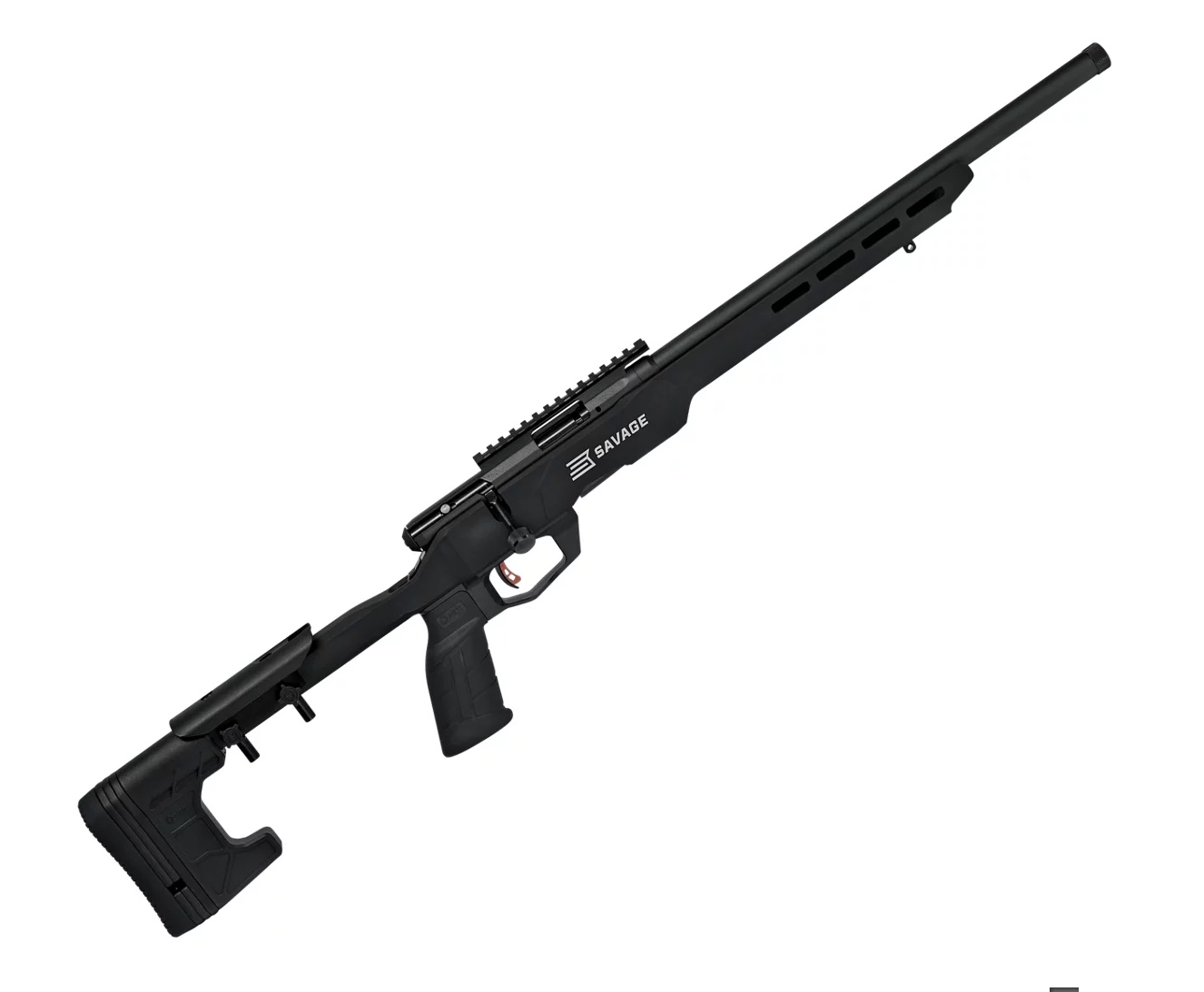

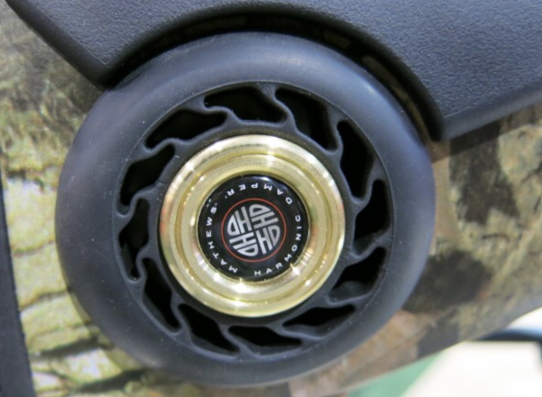

I wonder how a MDT aluminum stock loaded with harmonic dampeners would change the springer world. The receiver could be fastened much more securely to the stock. I have been enjoying shooting 22 long rifle out to 300 yards lately. My Savage B22 Precision has the MDT stock and suppressor. What a difference from a wood stock model. Hitting 3” discs at 300 yards. Take this stock and with the addition of harmonic dampeners like Mathews uses in their bows.....
It was previously mentioned that springers will eventually make their comeback. If so, it will take a breakthrough in technology. Maybe a springer with a Aluminum Chassis and a Harmonic Dampening system. The receiver screws can be tightened to 60 in lbs. I think I will build one. (Borrowed pictures)
