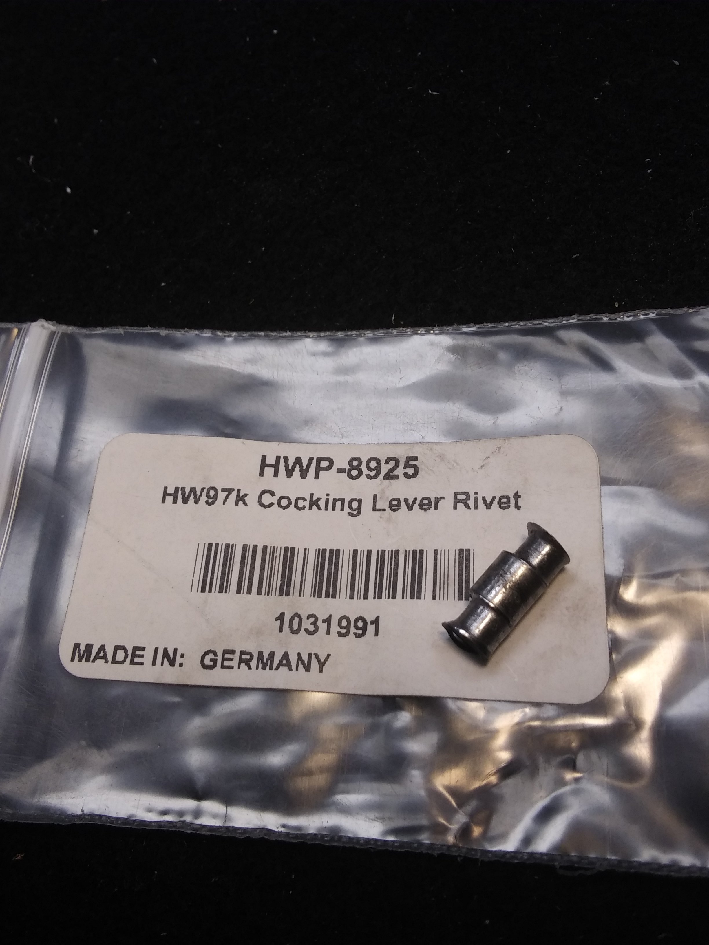

I think it's slack in the linkage causing a short stroke. It's the only thing I can visualize that would cause that. It's just a wild guess. I know the stroke length is super critical. It's really easy to short stroke my 97 now that the new linkage is worn a bit. No doubt a few more thousandths of wear and it will start acting funky. Maybe not reset?
That was the condition that caused me to send mine for warranty. I didn't notice cocking arm slop, but it finally wouldn't lock any more, so I sent it back.
