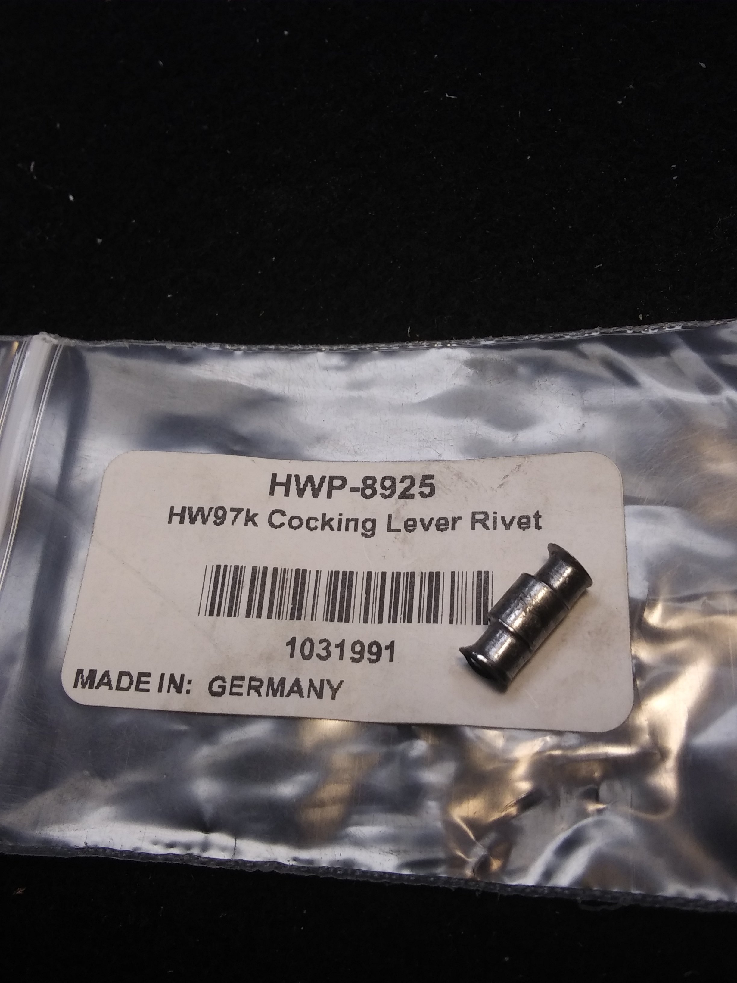

About 1500 shots. It failed quickly. Here is the pin.
Replaced the cocking lever and the pin and I oil it every time I use it. I've got 3-4k shots on the new linkage and it already has a lot of slack. It still engages the safety (most of the time).

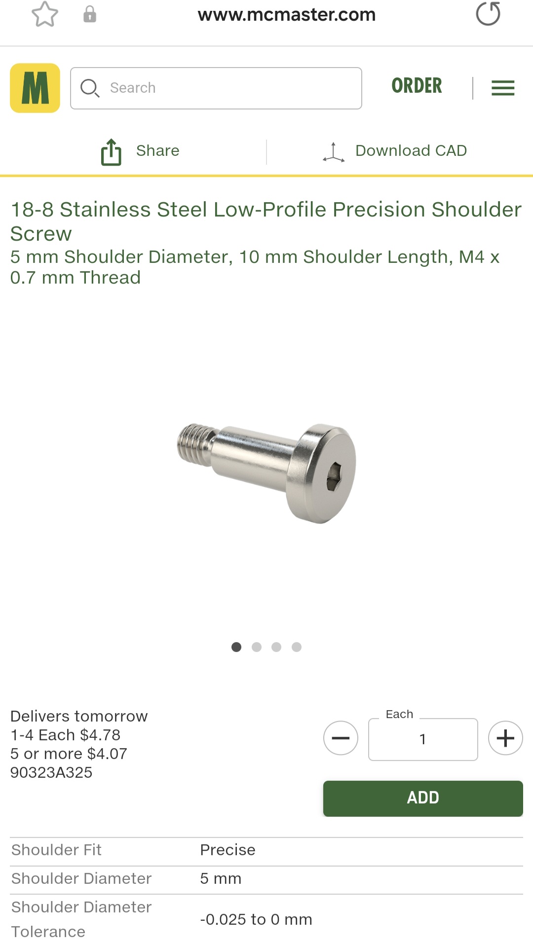

I had the same problem and found a solution that has lasted me many years and thousands of shots. Details here:

The peened over pin works great if it fits in the cocking lever tightly. If it does not press fit in the cocking arm the pin wallows a little and it wears fast. That's why just replacing the pin dosent work. Once the bore in the cocking arm is worn a pin alone won't fix it.
Once you get a tiny bit of pin movement it creates slack in the linkage. The slack translates to a shortened stroke at both ends. At full stroke it shortens it just enough the safety won't engage. And locked in the return position it won't quite hold the comp tube against the breech. The fit of the linkage on these rifles are critical to their function. Just a tiny bit of slack matters a lot.

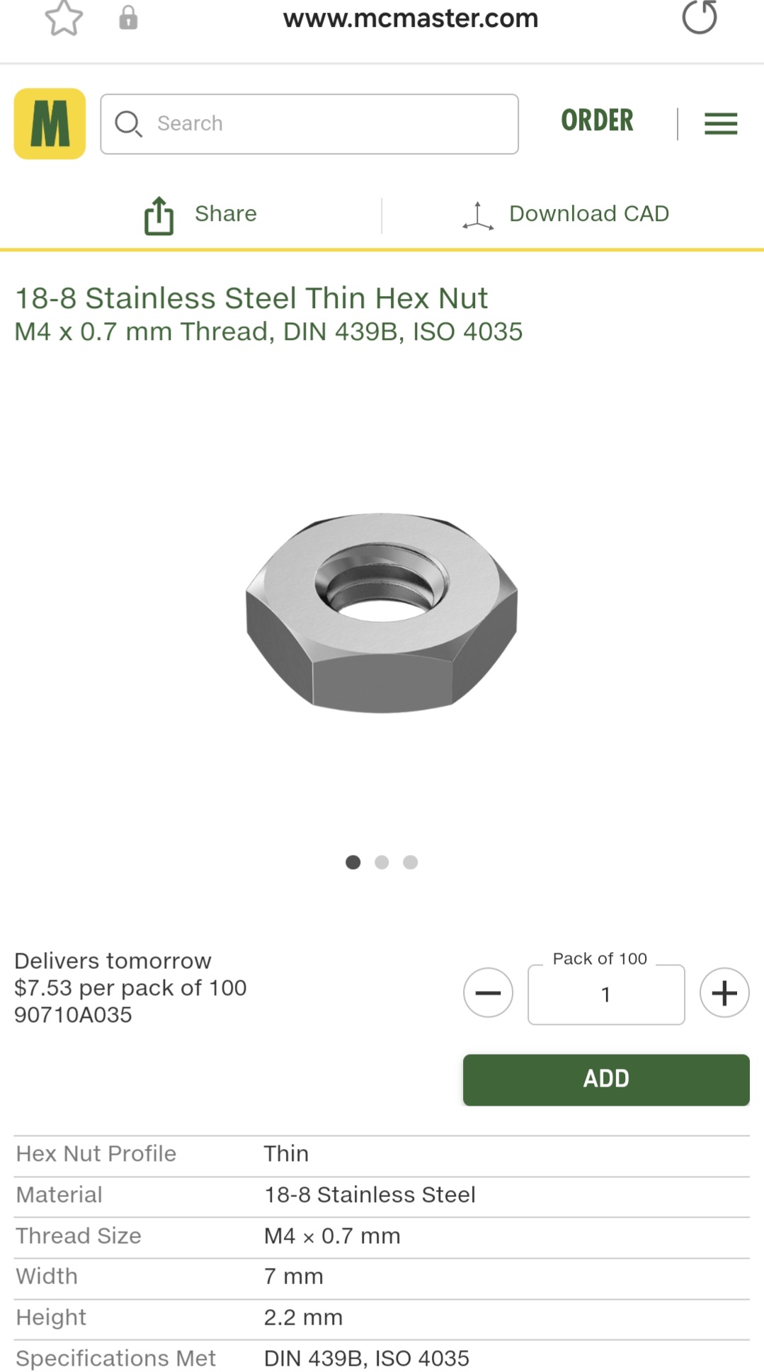

Yeah... the bolt keeps the wear down. It's a better way to make that connection for sure.
The pin gets loose and "wallows" with every stroke. A nut and bolt gets loose but dosent wallow so the wear is exponentially slower.
It's still going to wear there. Imagine the force on that pin. It's only rotating 1/4 turn but it has a whole bunch of lateral force against it. It's gonna grind.
I fit a little bolt in mine as a temporary fix. Had to grind the head and the nut thinner. It worked until my replacement parts were delivered.
I thought about cutting a channel in the synthetic stock to clear the bolt head and nut but decided against it.
I just thought I would add the pics to your post.
Screenshot_20250106_094939_Samsung Internet.jpgScreenshot_20250106_094958_Samsung Internet.jpg
