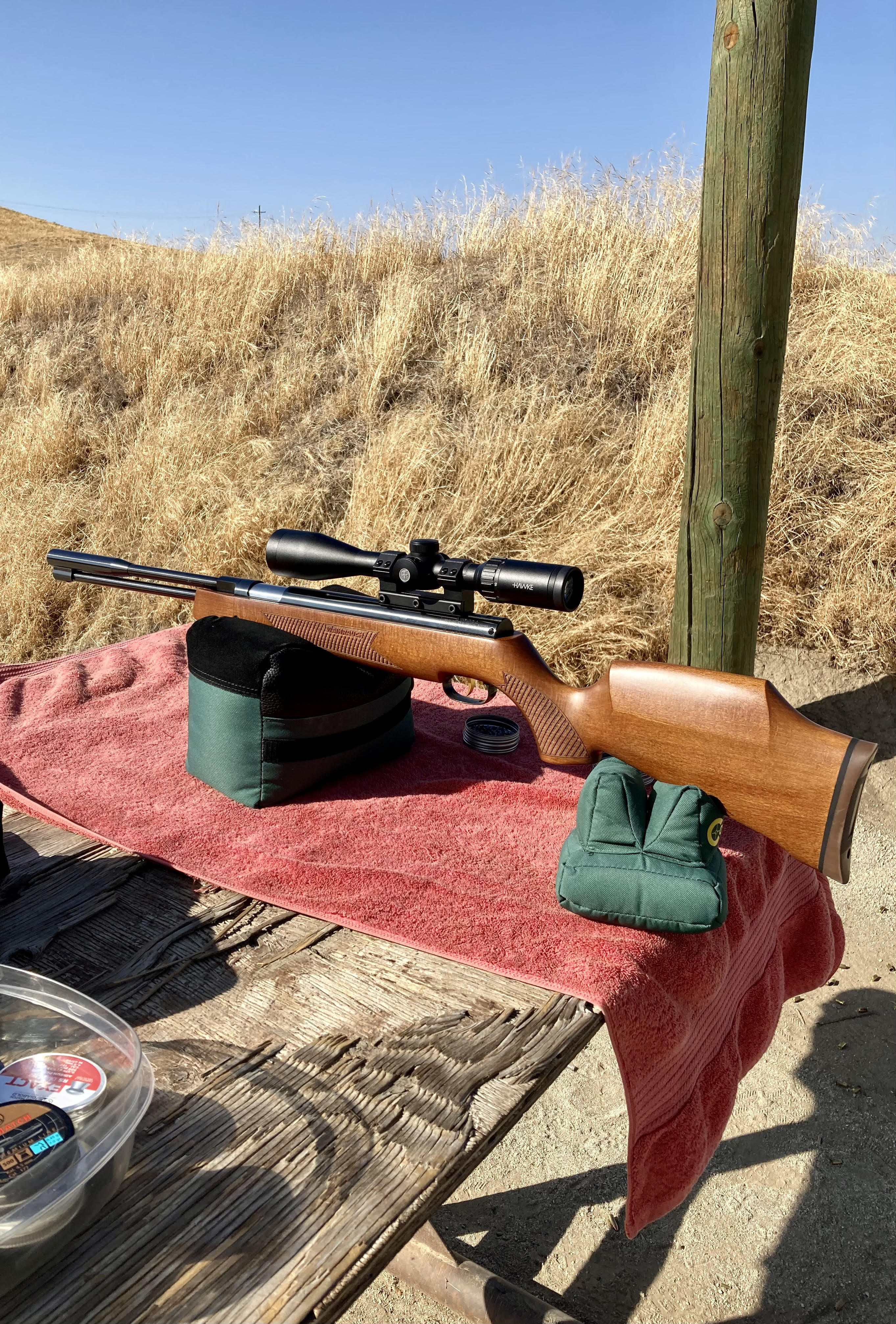

I did a vortek 12 foot pound and ended up with 11 fpe. I put in a power washer and I got 12.4 foot pound but I have to cock it harder for the safety to engage. I should have left the power washer out. I’m not sure if I messed something up or the washer is the problem. With two washers it would not cock. I have a full power vortek kit waiting to go in it. It is a joy to shoot at the lower power but I’m and American and I like horsepower.
The piston or compression tube is bottoming out on the washer before the safety is engaged. You need a smaller diameter washer. I've run into this and outer guide flanges that were too thick a few times with the Vortek kits.
The second washer prevents the piston from latching. The piston latches first then kicks out the safety. Your one washer is borderline. Be careful, it's possible for the trigger to latch with out engaging the safety.

I don’t shoot the gun often and only at the range for that reason. I might try a smaller diameter washer because the gun truly is a joy with the lower cocking effort with the 12 fpe kit. My guess is that the kit is closer to 12 fpe with .22 caliber and lower for .177. I got greedy and put the washer in for more speed and was left with a bench only gun for safety purposes.
