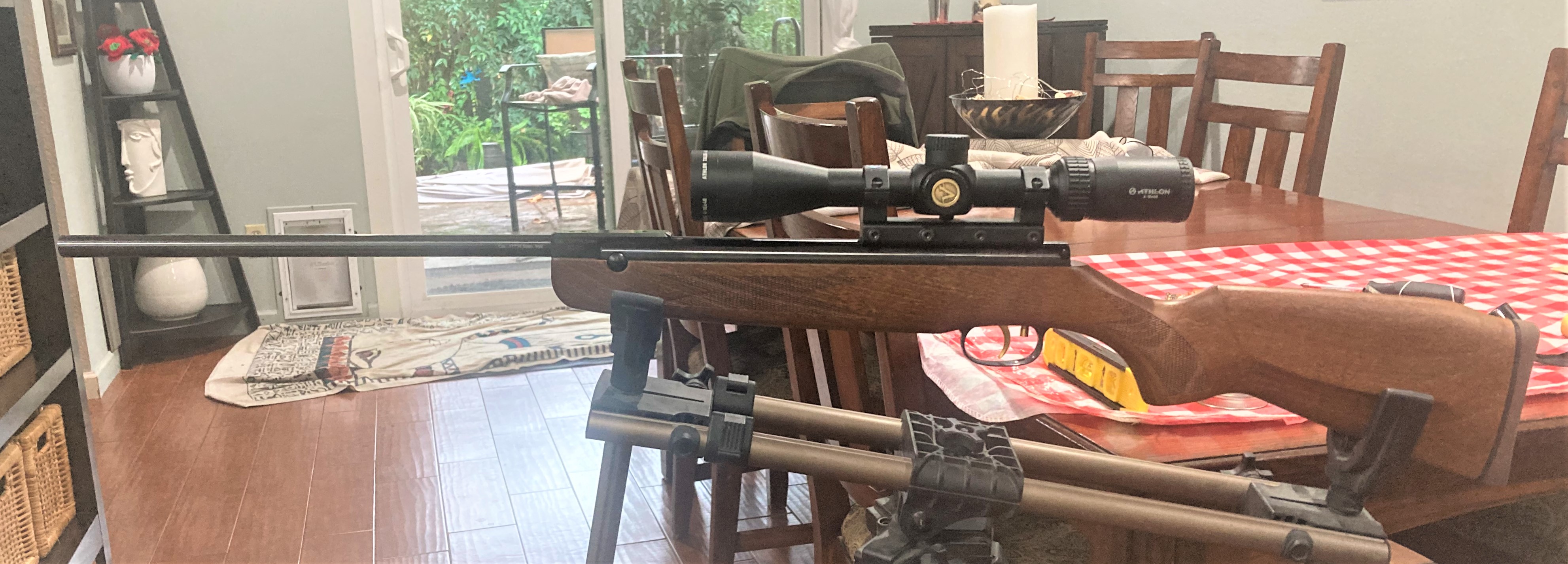

I will let Motorhead in No Cal do the tuning. He is ultra-experienced and has done 4 different rifles so far. that I own. Recently my 1979 FWB 124D . Before that my Diana Air King 54 in .177, my Beeman R7, my Air Arms TX200 Mk. 111 HC in .22.In the fall I will let him tune my HW98 in .177. The firing cycle on the Beeman R7 is almost recoil free. What a great little rifle.

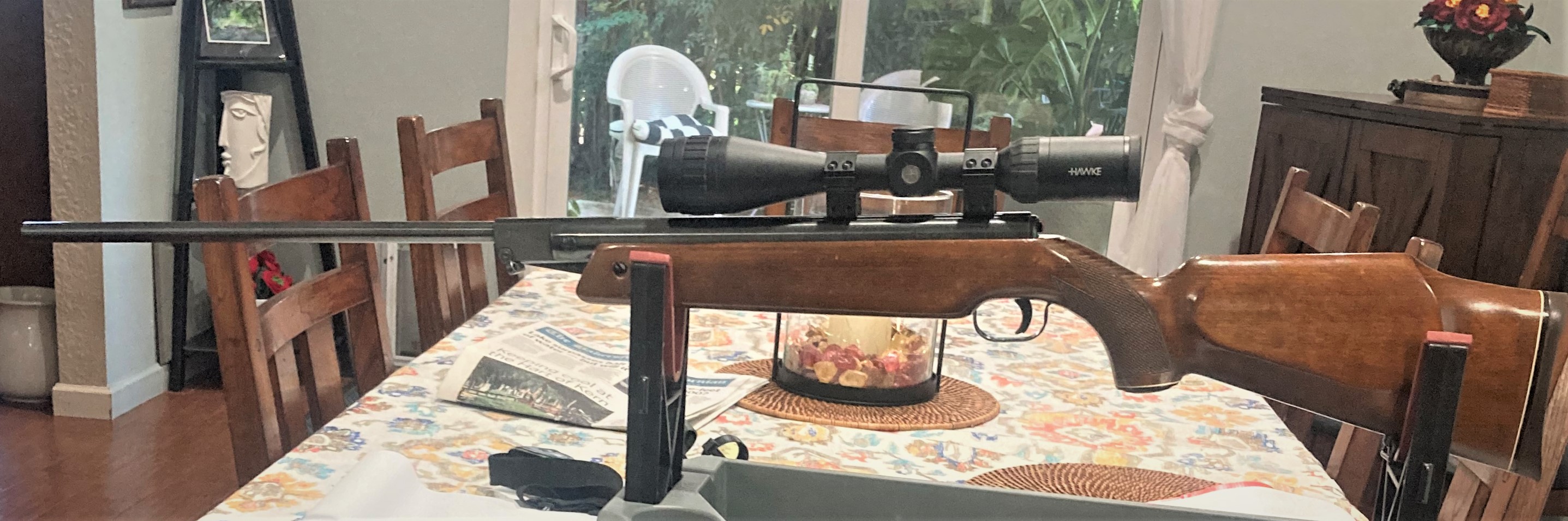

I have had four spring guns tuned by Motorhead. Honest, amazing work, and not hard on the wallet. Good work on my Diana 54, TX200 HC, Beeman R7, and my 1979 FWB 124D just back. This fall my HW97K and HW98 will be under his care. Here is the FWB 124D back in service.

That's a really cool rifle! I like the white inlays in the stock. Amazing how older rifles are built so nicely. Which one of your springers is the most accurate?

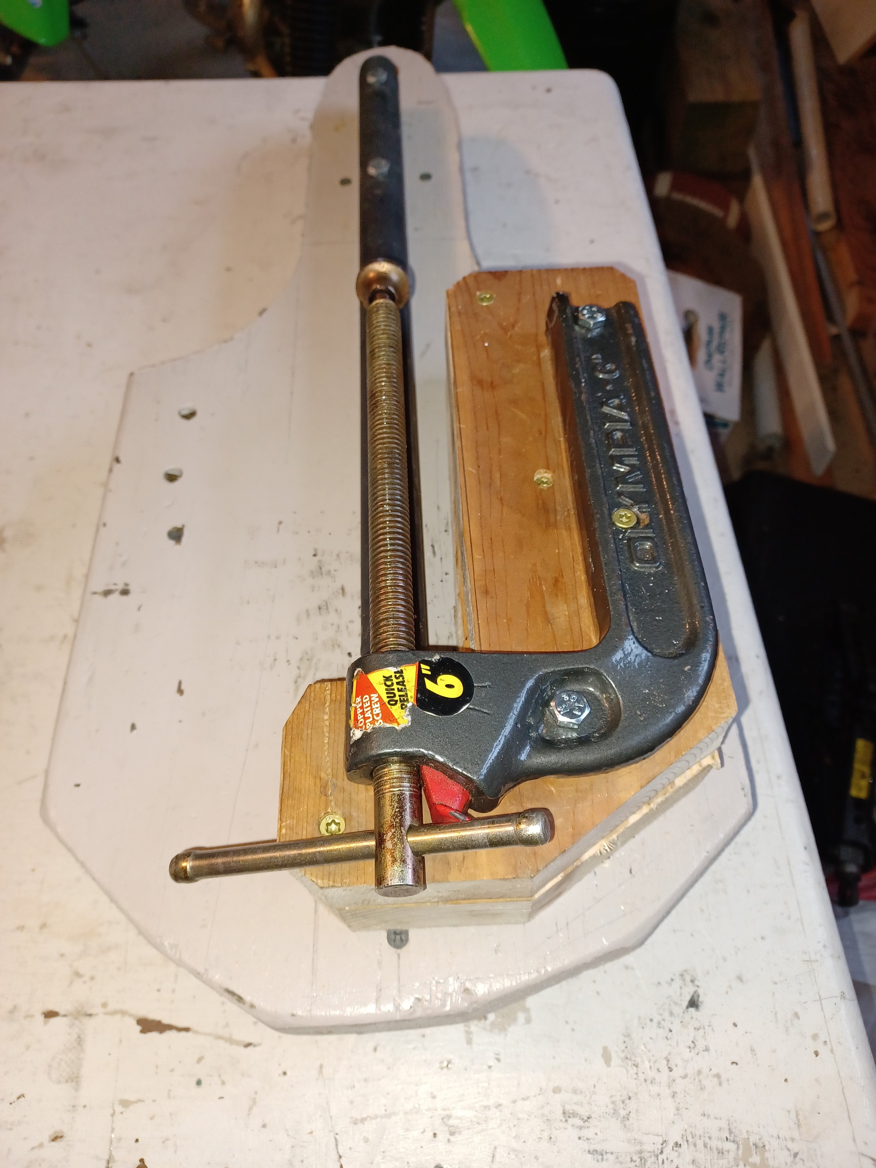

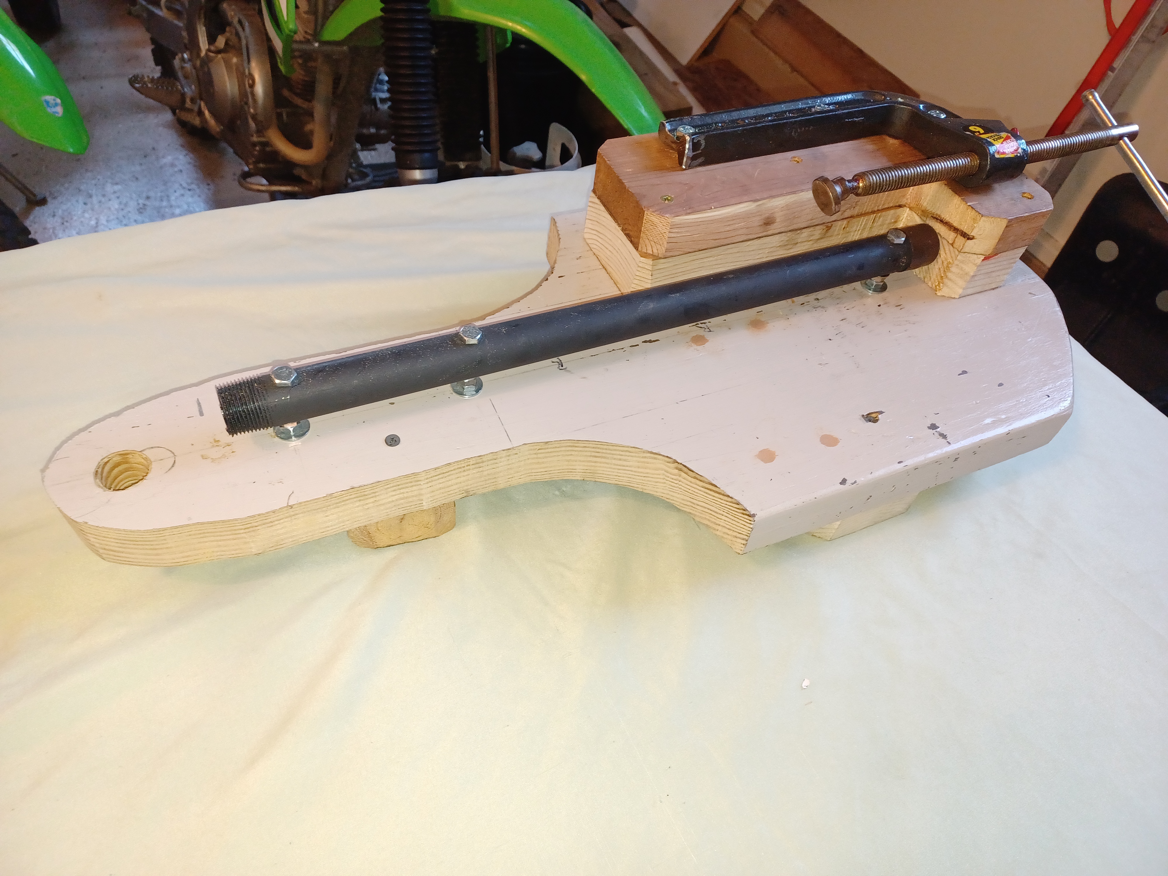

Here is a pic of the spring compressor I just put together. Air Venturi sells a spring compressor and they utilize the scope mounting rail as an anchor point to hold the gun instead of a muzzle block or pivot point block. I went with their approach. I'm waiting for the rings to come in. Then I will install the spring and piston seal.
The spring from ARH has arrived. I tried compressing it with my arms. I only got about 1/2 inch. Putting it against the floor; I can compress it but I didn't because it could boing out and possibly get bent. Anyway, after feeling how rigid and powerful this spring is. I'm glad it made the compressor. It would not be possible without.

Yes I ordered $12 one inch rings to fit the one inch pipe; with 11mm dovetail bases and double clamping bolts on each ring base. Unfortunately the pin stop is on the rear section of the reciever which I will be removing, so won't be able to use a ring stop.
As far as opening the spring tube without using a spring compressor. I have zero experience in opening the tube or action. I have never changed a spring or piston seal on a springer before. I'm just following the suggestions of others. I have seen a few Youtube videos of folks opening the action without a compressor but I noticed that they were all from Europe and were probably using 12 ft-lb springs.
If you can change out a full output spring on an HW97 or 77 without a spring comprressor. Please explain the process or please show a link. I would love to learn. Thank you
