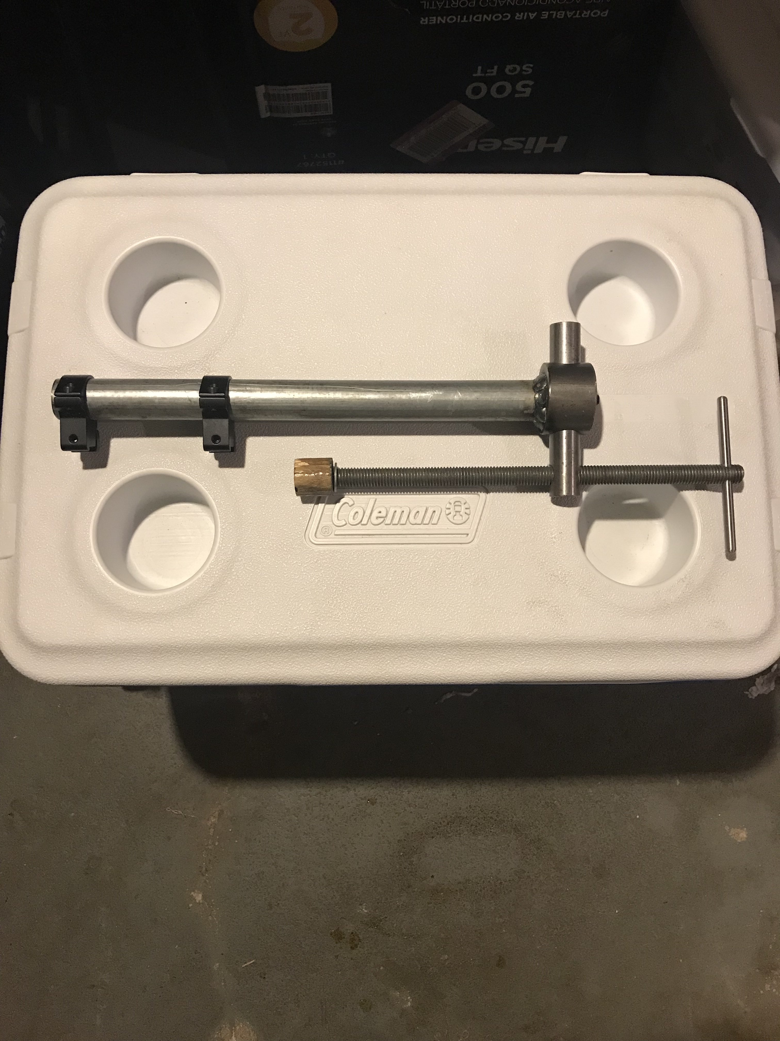

Here’s the one I made at work a few years ago. It’s a crude adjustable version of the air Venturi. Only took about 20 minutes to make using scrap. I could have spent more time and made it pretty. Sadly the shop I work at now frowns upon personal work. One could make one like this or similar at home using aluminum and a drill press or hand drill even if a drill press is unavailable. Look up air rifle spring compressors on the google machine for ideas using wood and sawed off c clamps or bar clamps. It don’t have to be pretty to work.
Pretty darn close to what i made 👍
If it works call it good. Got the job done .
Can you slide the vertical post that the screw goes through? That’s what’s missing on the Rail Lock. Would be a dang near perfect portable tool if it did. Because on some guns it just doesn’t line up well and even with an adapter it still pushes at an angle. Not sure what their patent says, but someone with machining skills should run with my idea and make the world a better place. And maybe make some coin too ha ha ha.
Yes the vertical post is able to slide up and down. The screw on the back is a set screw that holds it in place. There is also a small flat milled on the back of the vertical post that clocks it and keeps it from going sideways under tension from the spring.

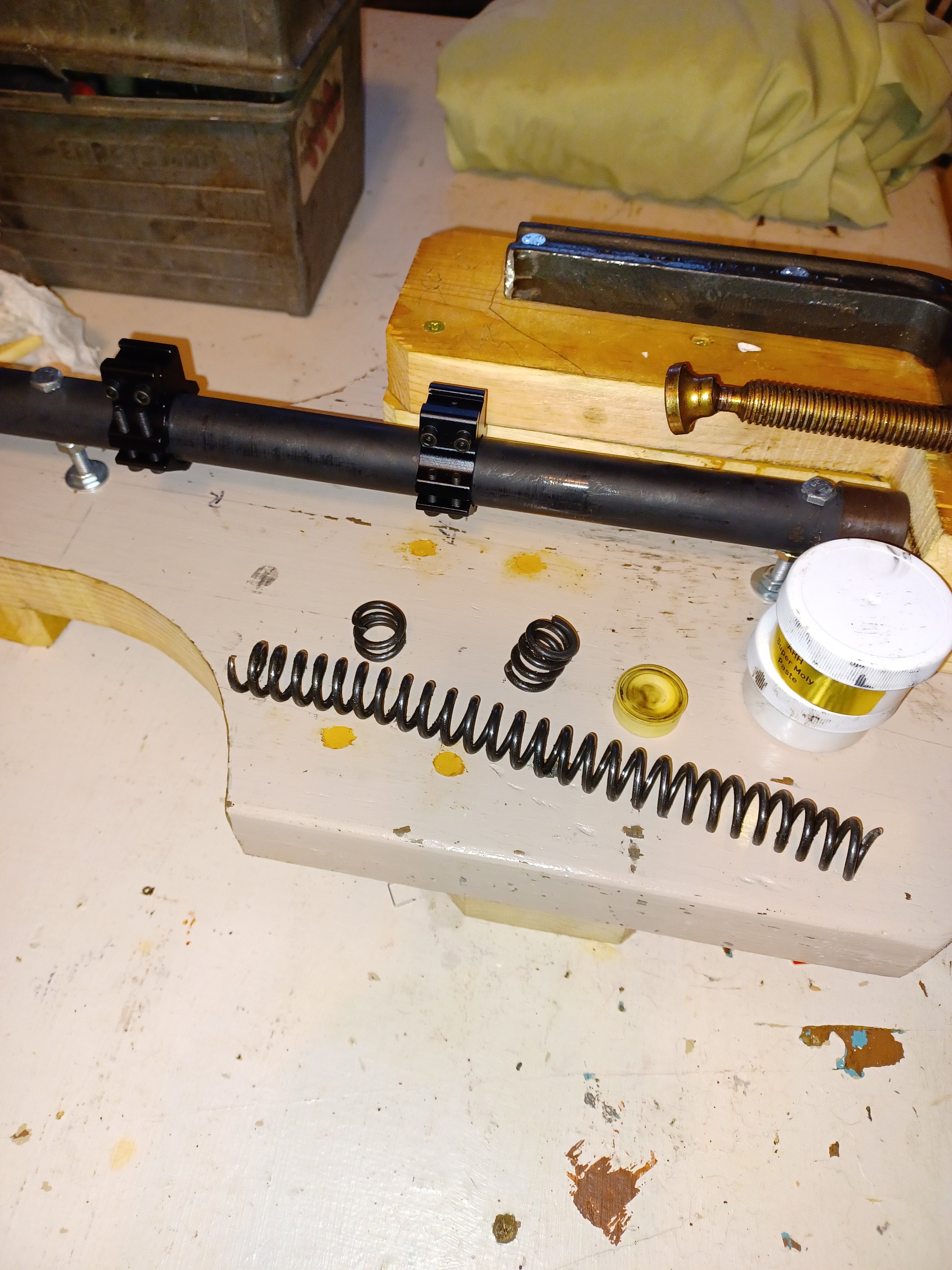

I just finished installing the ARH / Maccari spring, velocity is now 915 fps using Crossman HP pellets. Up from 612. I though the piston seal was going to be the issue but as you can see in the picture; I think it was the spring.

Did your kit come with any grease or lube of any kind or did you just replace the spring?
The kit came with the spring 2 plastic spring end guides and heavy tar for spring dampening. I also ordered his molybdinum disulfide grease for metal to metal. I also replaced the piston seal with a Vortek as per recommendations here on the forum.
You should be good if you applied the grease and tar. It shouldn’t sound dry.
It sounded dry when I drew the piston back when cocking the gun. I put 2 drops of airgun silicon oil down the transfer port. It sounds acceptable now. No honking. I don't know if others lube that part of the piston chamber when doing a seal change. I know I didn't, but next time I think I will.
https://www.pyramydair.com/blog/2006/08/spring-gun-tuning-part-10-lubrication-and-reassembly/
( Im a bit more liberal but not sloppy on brushing lube on that piston body not thick but i coat it all )
You dont want lube in front of the seal face. The seal if fitted right will "wipe" the lube to the sides/cylinder wall with bare min lube if any getting in front of the seal face.
I would think of it's acting or becoming dry it's under lubed
Another is mixing 2 lubes that dont like each other . They won't jive and roll or wash each other out . And can be a yuck un-functional mess.
Im no pro but trial and error to what seems to work best for me thing . Dont think i don't ever go back and rework my oops .
I brush moly on with a makeup Q-tip type thing. Very light coat on spring and piston flare. Little around the edge of the piston seal, careful not to get any on the face. Do your trigger while you’re there. Done. Don’t use tar because a little twang doesn’t bother me. Part of the charm of HW IMO. Have done 3 guns this way though and none of them had much buzz when finished.
