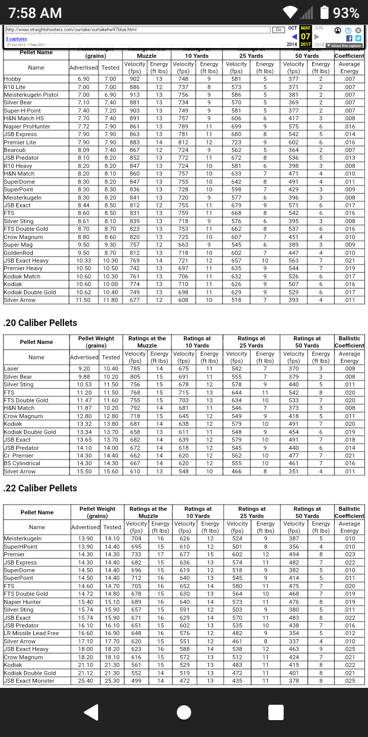

I recently bought an HW97K in 0.22 from Airgun Depot. I just tested the velocity with CPHPs (14.3 gr) and got an average of only 634 fps (12.8 fpe). I also tested it with H&N FTTs (14.66 gr) and got 658 fps (14.1 fpe) and JSBs (15.89 gr) and only got 566 fps (11.3 fpe). Are these velocities typical for a new HW97 or did I get one made for the European market? I did the tissue test and it doesn't appear to have a breech seal leak.
