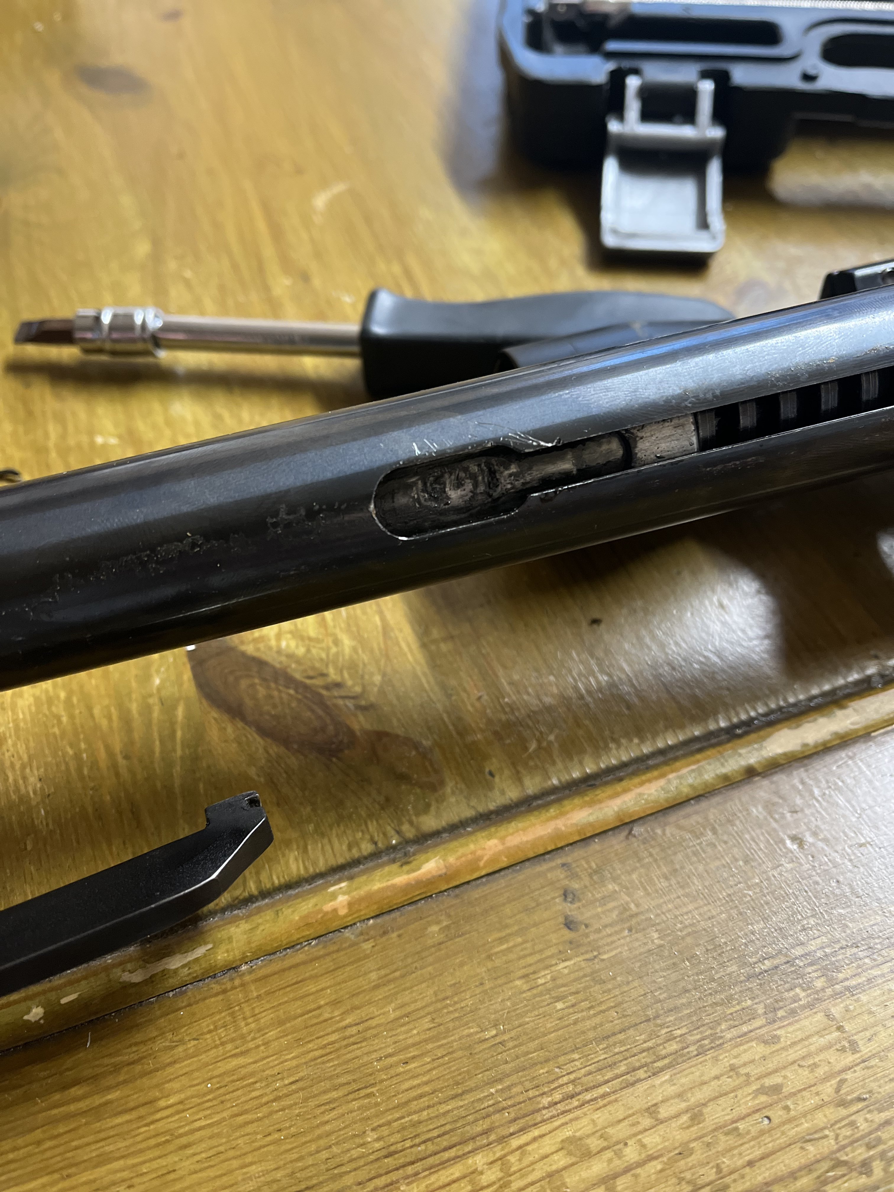

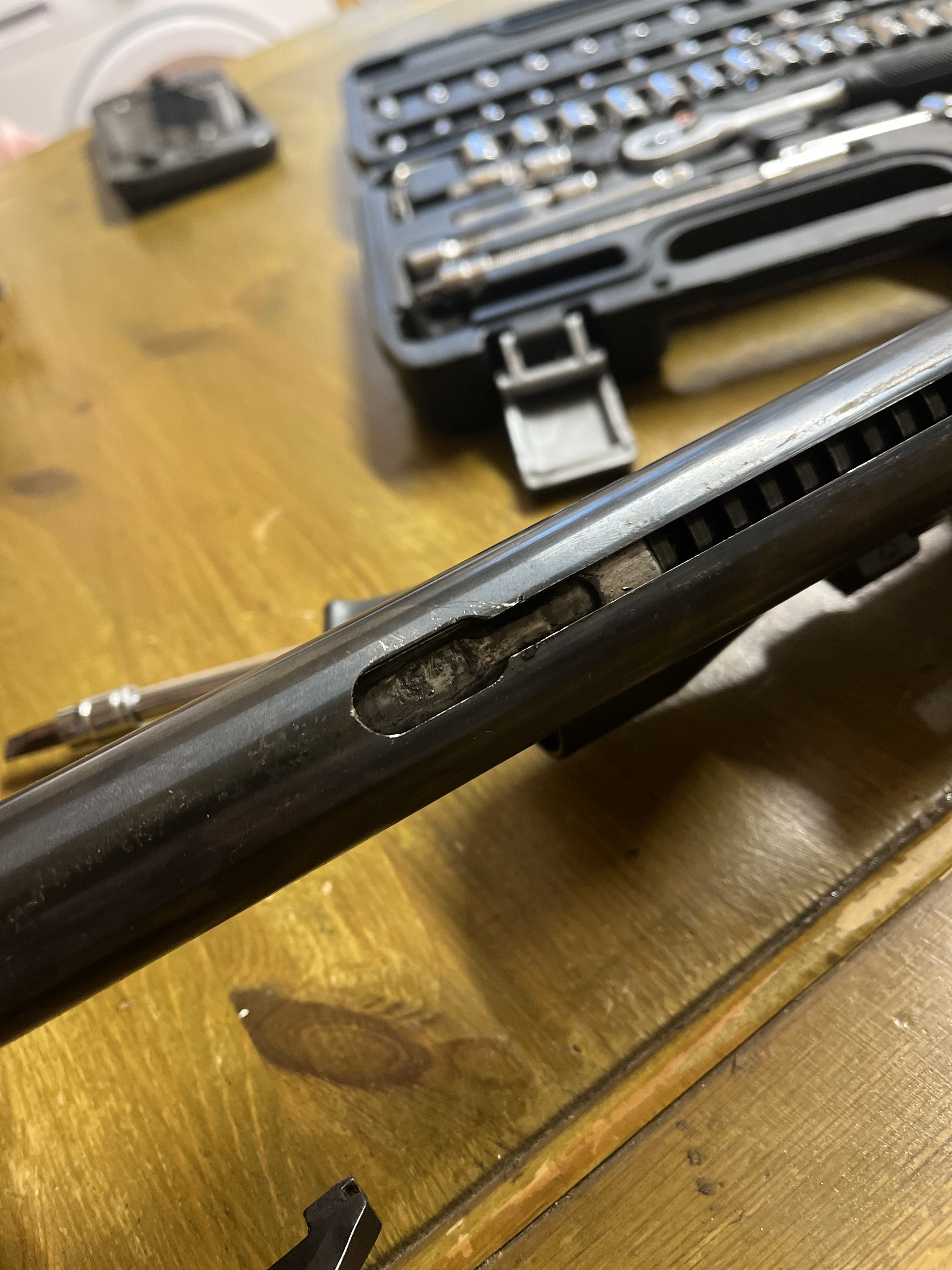

Got it shooting. Had to close the gap on the shoe a smidge, very easy to do. Problem solved. Shoots like a lazer too :)
Sounds like the cocking shoe or the "slot" of the tube its guided in or the cocking arm end that the shoe fits on is worn or damaged ..
You may can just pull the stock and view them things.
Also should be plenty of pictures and all to look at or pull the stock and give us one
This area
About 1/2 way down in this kinda guides you to the cocking arm stuff. Stock, barrel, then the arm and shoe removed ... easy stuff.
Hope it helps ..

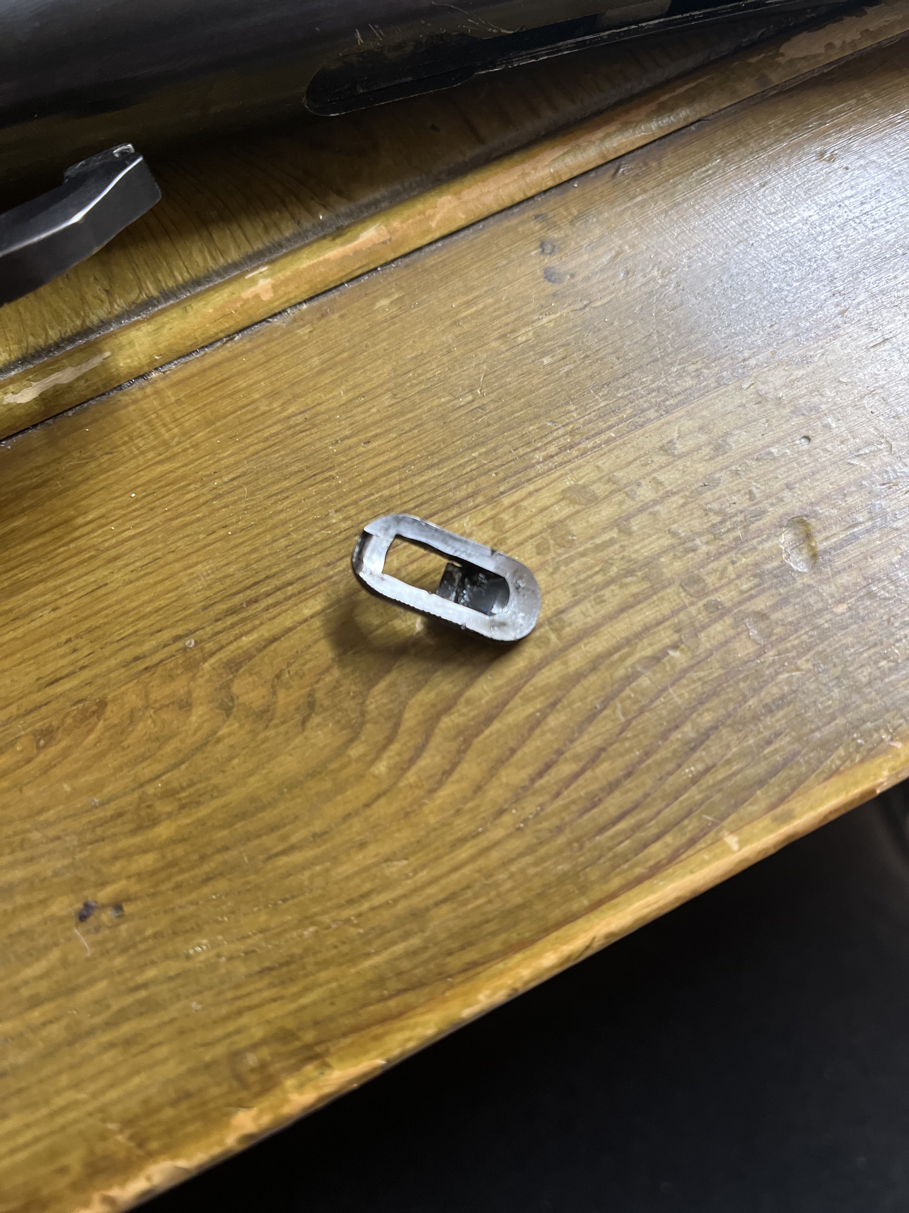

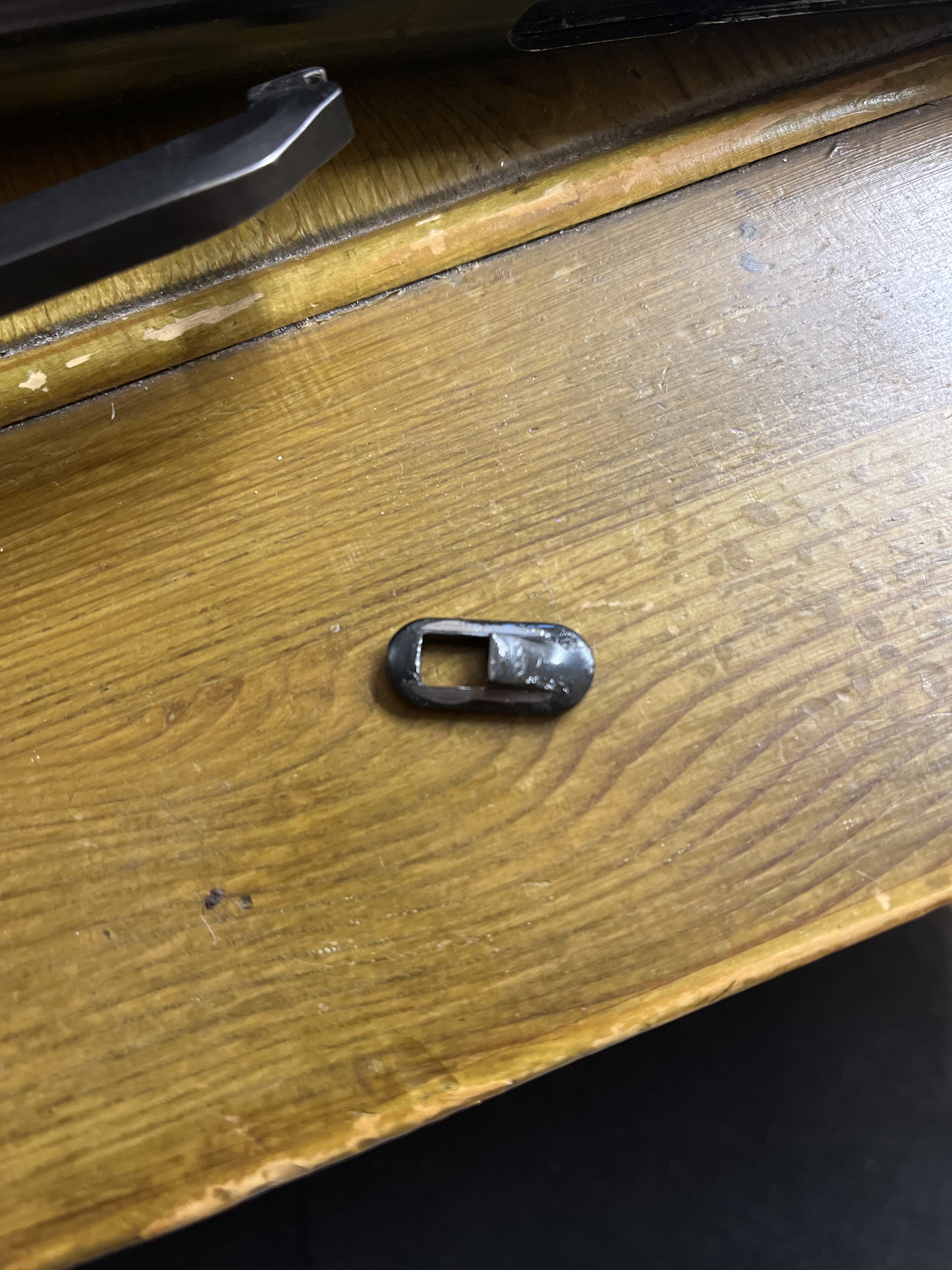

Well being hw them parts if bad ( arm or shoe) are generally available parts .
Id almost suspect the shoe for the main culprit..
Anyway as long as the reciver tube if not goofed your in good shape id think.
Yep. Used rifle sounds like? Could be someone de-burred the shoe a little too much. The HW95/98 are wonderful guns. You’ll enjoy it when you get it fixed.

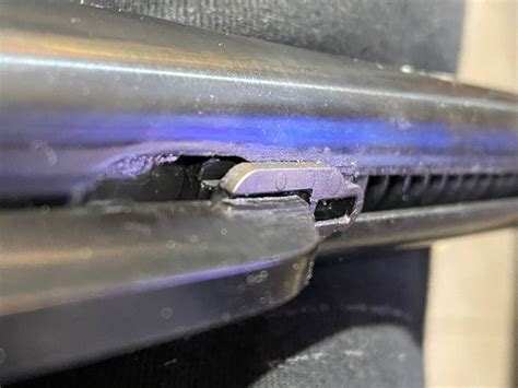

If it's older than say 2012 your cocking shoe won't look like the one these guys are posting. Just a heads up. But the early types almost never caused any issues.
The new sintered shoes can crack, most often when the gun is fired without the barrel being closed all the way, such as when decocking it.
Whatever it is, pulling the stock will likely reveal it fairly easily.
True , but unless you find old stock or a guy who has the old your only getting the new style.. ( for what i see).
Then the conversation only serms a issue with a hw80 .. i assume the new type is drop in on the rest (???) .
Anyway thats a good point if it is the old style shoe... They seem more subject to ware through ...

Well, well... It was old style..lol
That chambers in the UK has the new in stock for like 12 pounds.. i think id just grab one.. personally its a better design. And should be a drop in part.. ( get it to be handy for the next time it starts slipping...)

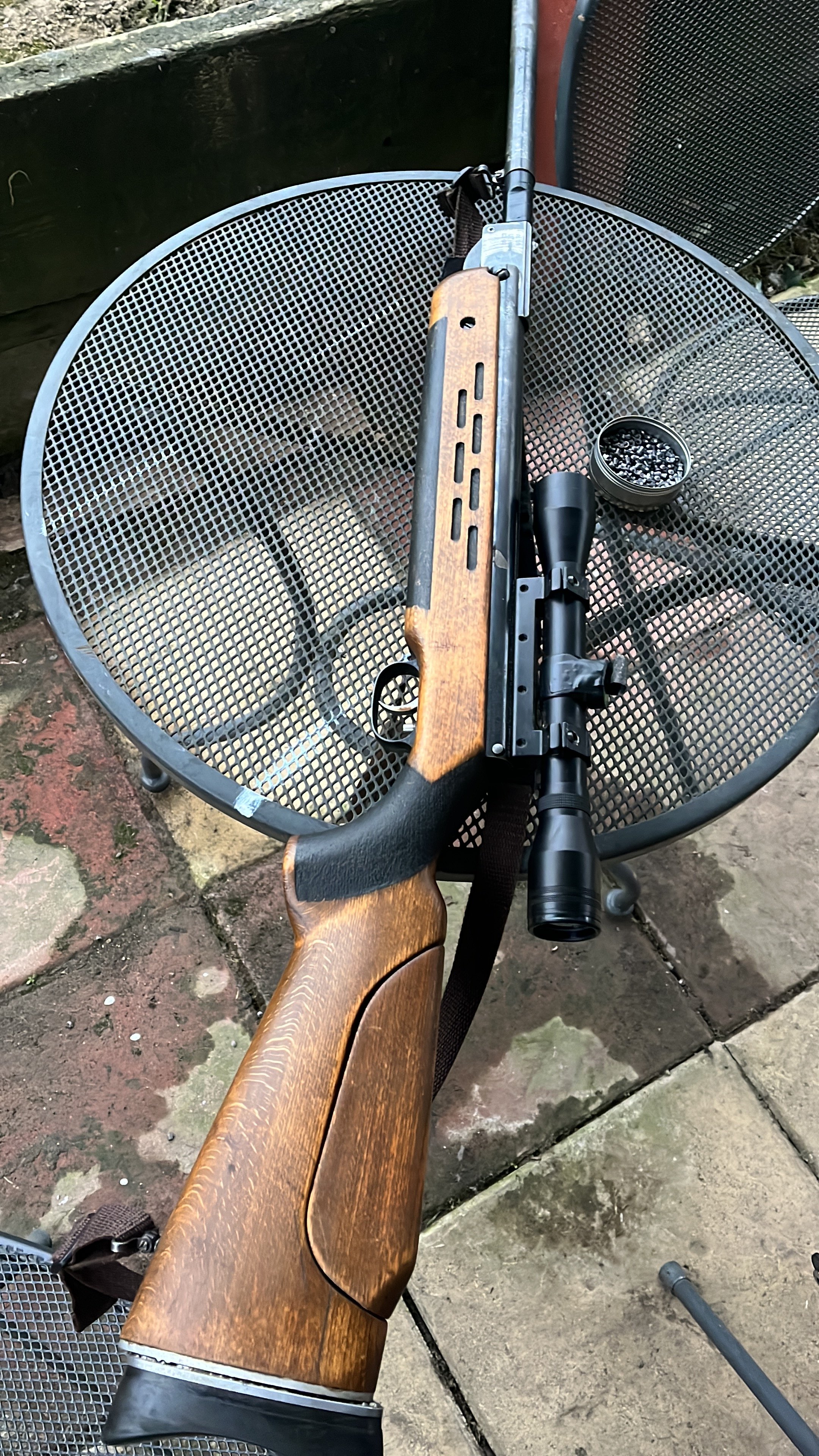

Anyway looking good if its shooting good 👍
Yehh enit. It should be sub 12 bit dont think it is, go going to strip it and get a chrony and test it before i take it out as here in the uk you need a firearms licence to own and rifle above 12. Not worth risking it with a prison stint
I guess thats not part of that bill of rights above ?..
Man like cjtamu said " i need good friends like that"' as well.. they do give me stuff but beyond repair there garbage collation folks refuse to haul off stuff 😜...
That hw new is like a 600 buck gun . You got it gifted, so a 100 bucks fixing it up is well worth it ..
Anyway looks like you got it going on . Now enjoy..
